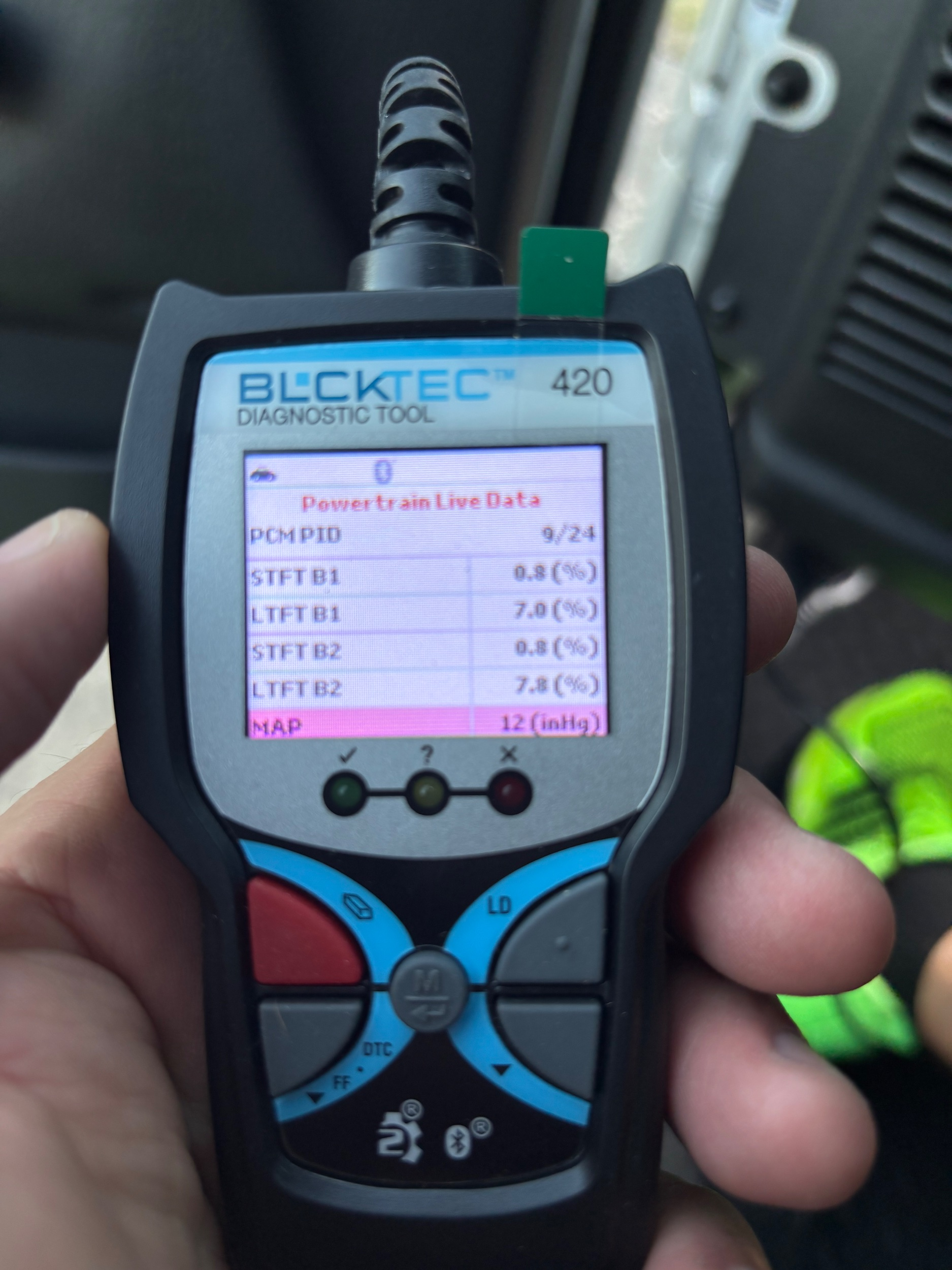

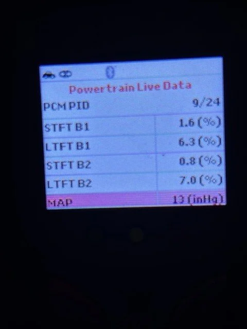

The stfts are normal. The high stft value you are seeing is a sensor 2 reading (post cat) which is also normal.

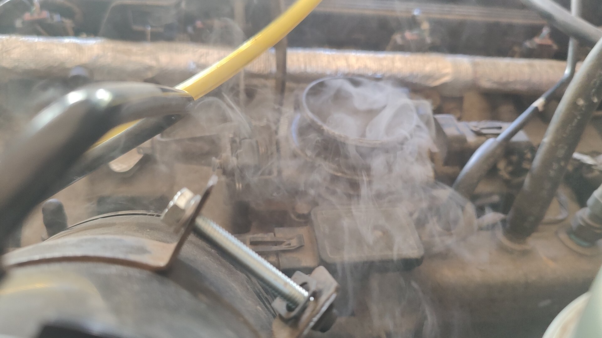

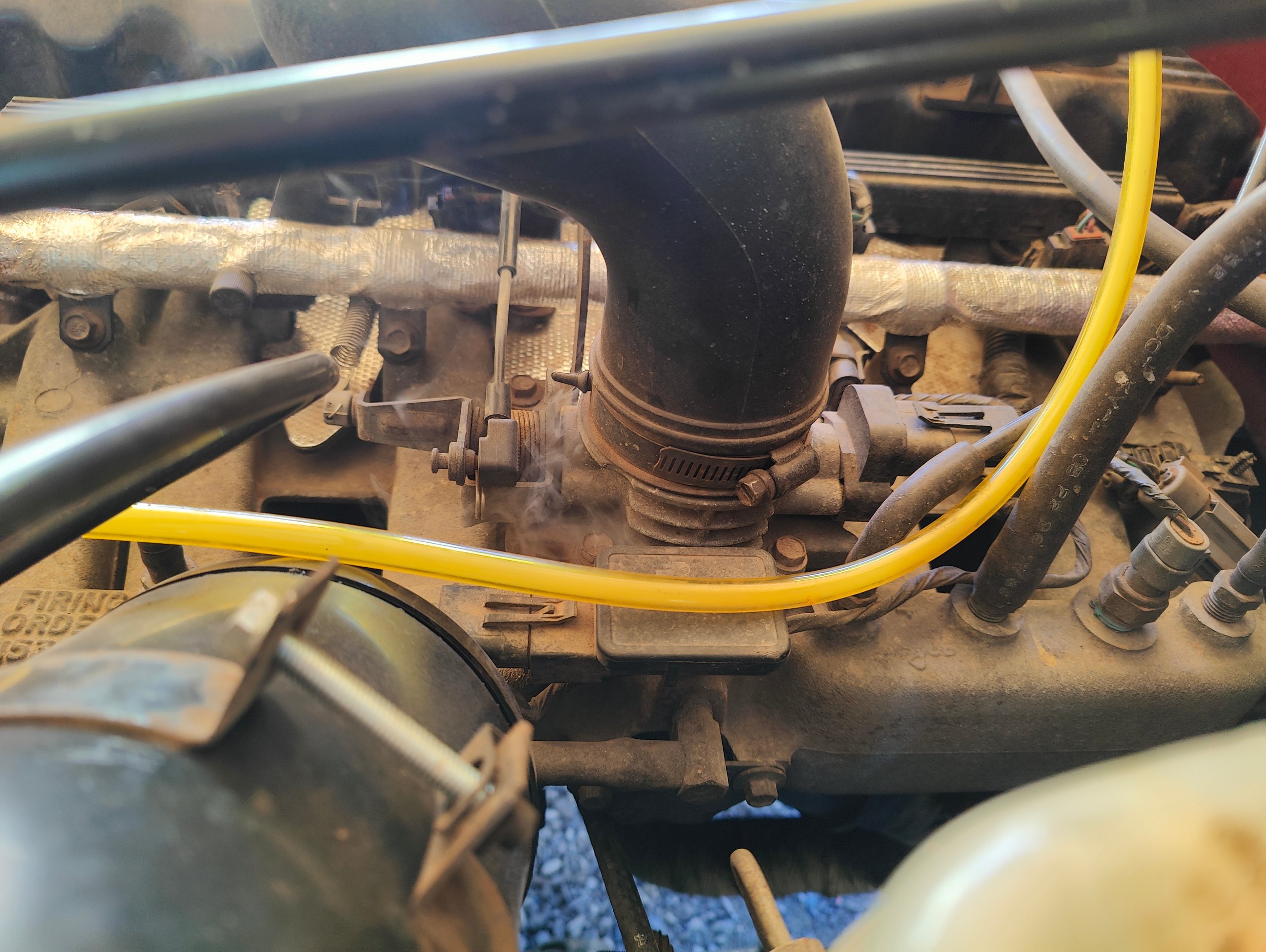

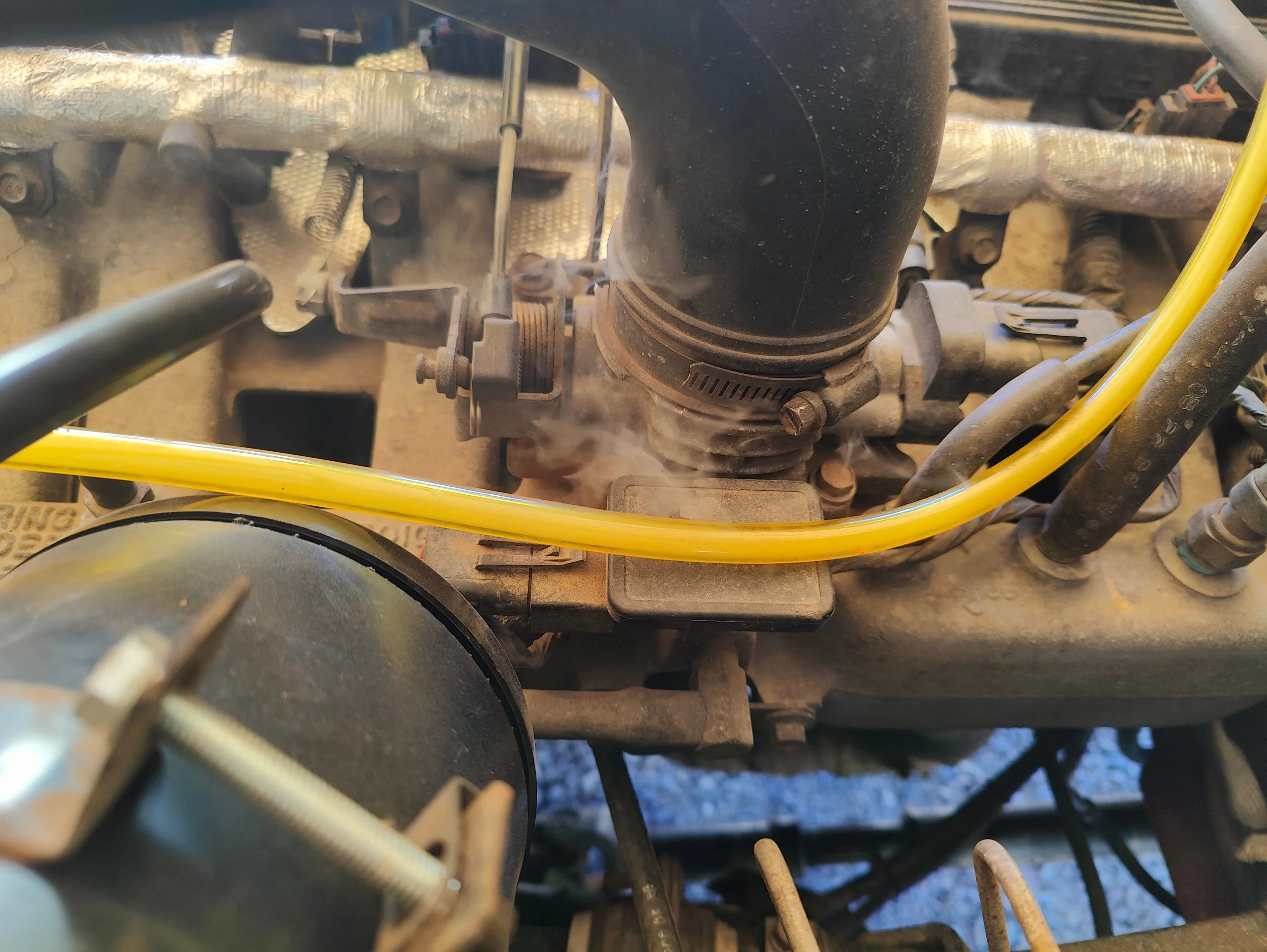

I got a smoke machine to test for leaks this weekend. So will test the EVAP and intake spots. I have also done a soapy water test with back pressure on the exhaust. It showed some exhaust leaks at band clamps, plan to try and fix those, and ever so slightly at manifold to cats. So will address those as well.

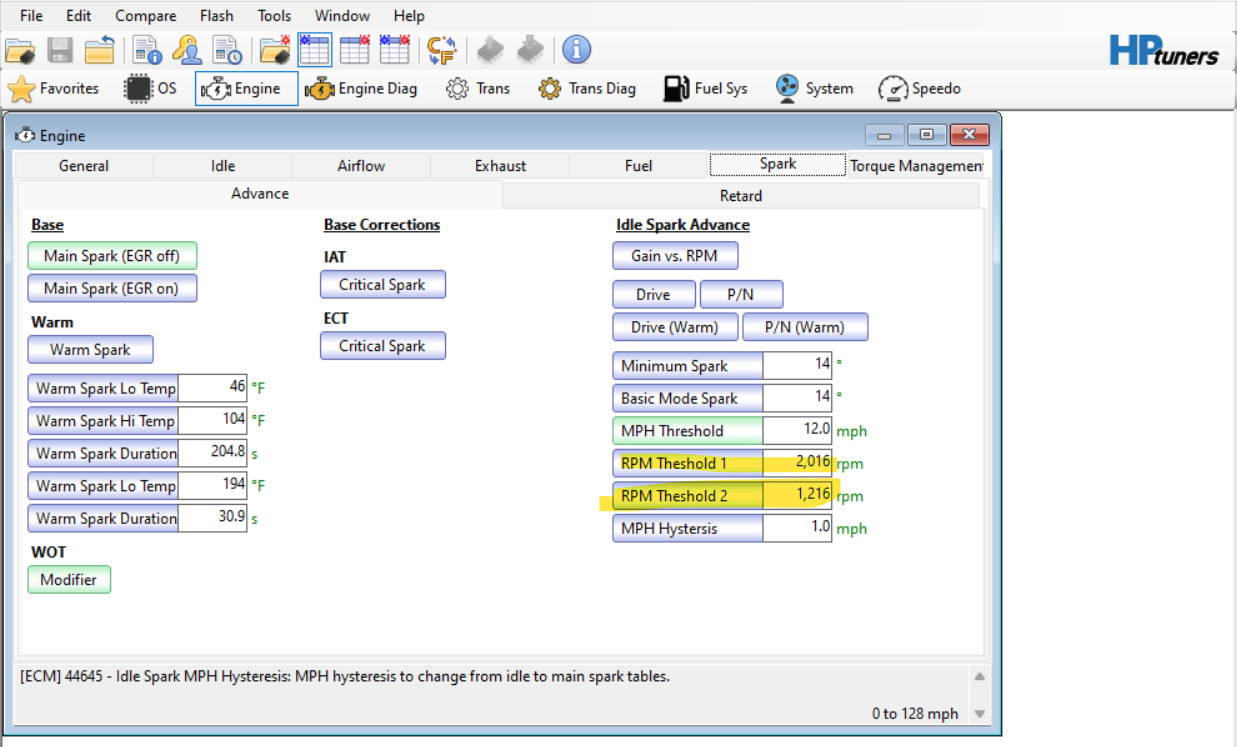

As a tangent to the thread, you mentioned you have your idle at 824rpm and you sometimes have a hang. If you look at your timing table, there is a plateau in the idle areas from probably 500 up to roughly 800rpm where it then jumps up considerably. The pcm uses timing to control idle speed and sometimes setting your idle at the edge of this timing plateau can cause a hanging idle as it gets confused. Some oem tables have intentional ridges or troughs to help settle into the sweet spot. You can tune around this. It may help.
