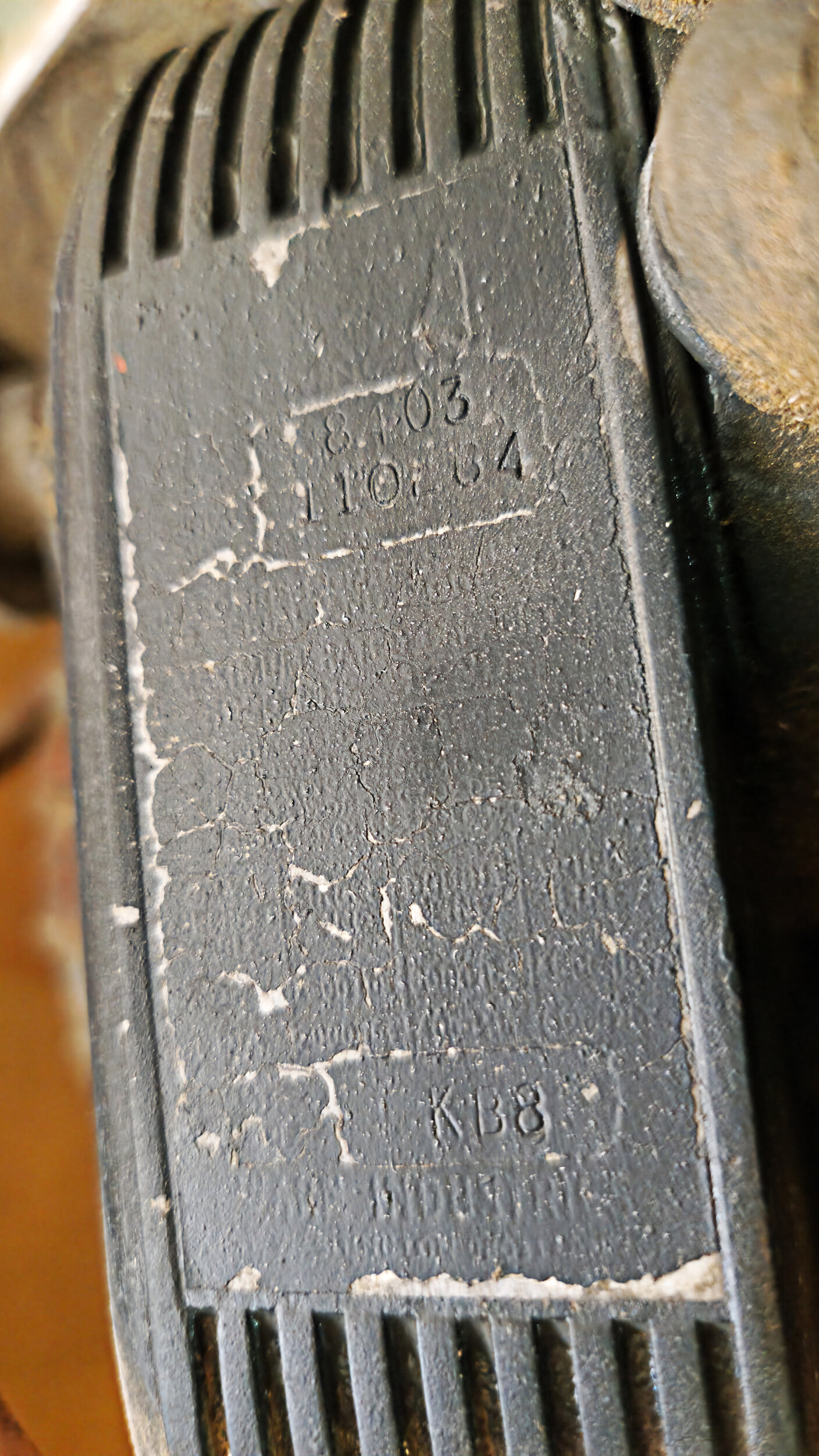

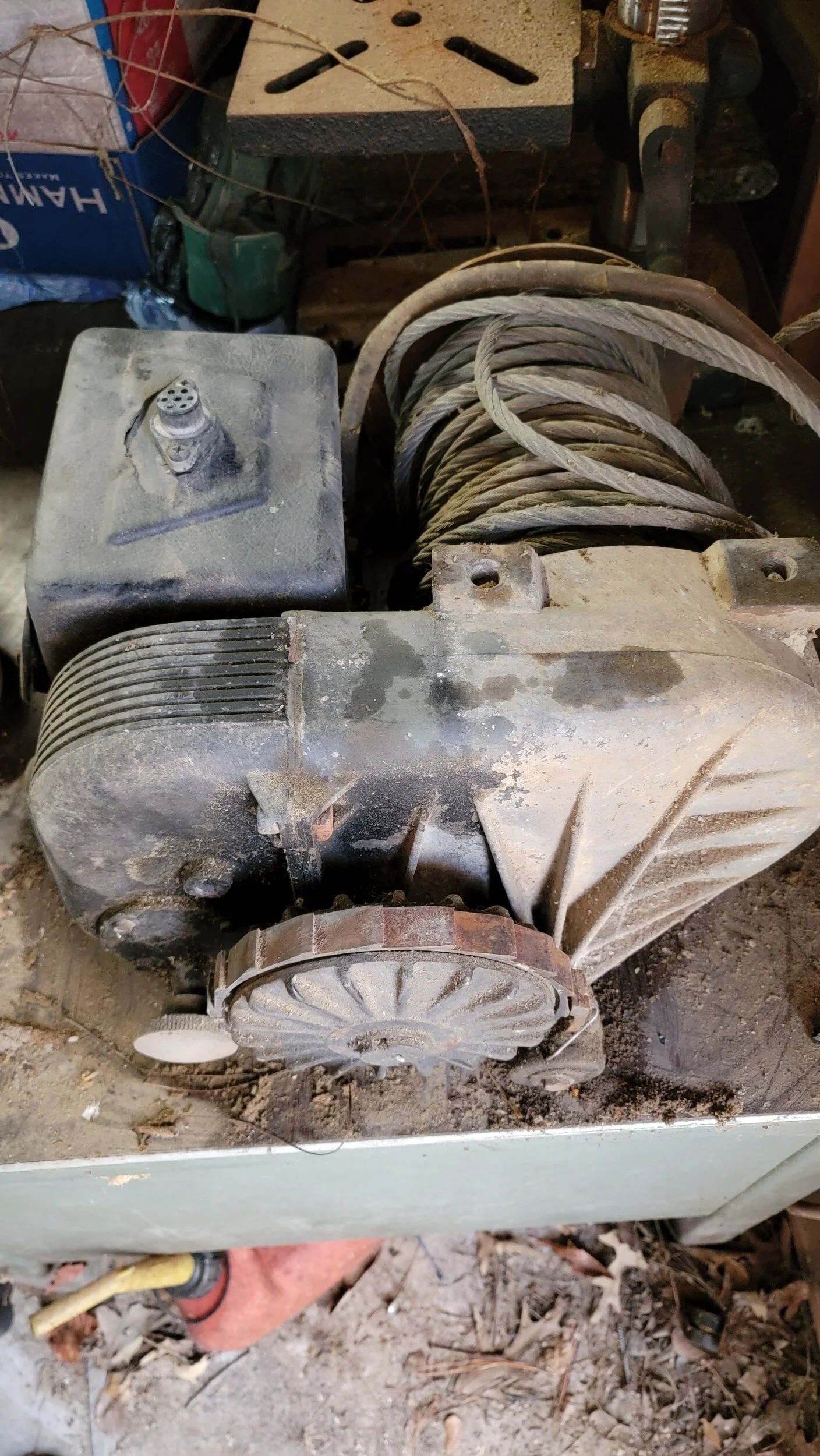

tnjeepguy Jeep fan for years Lifetime Supporting Member Joined Jan 8, 2022 Messages 1,489 Location Brentwood, TN Nov 13, 2025 #41 Solenoids are reasonable, like 30 bucks. Easy to test. Might be wiring and/or plug (looked a little rough) Do you have a remote and is it old or new ? Also it was made November of 1978 not 88. D Reactions: John Cooper
D donmegel New Member Original poster Joined Nov 10, 2025 Messages 12 Location Columbia, South Carolina Nov 13, 2025 #42 tnjeepguy said: Solenoids are reasonable, like 30 bucks. Easy to test. Might be wiring and/or plug (looked a little rough) Do you have a remote and is it old or new ? Also it was made November of 1978 not 88. D Click to expand... It's an older remote but I figured if i heard a click from the winch it wasn't the remote. Why not 1988? Reactions: speeding_infraction
tnjeepguy Jeep fan for years Lifetime Supporting Member Joined Jan 8, 2022 Messages 1,489 Location Brentwood, TN Nov 13, 2025 #43 donmegel said: Why not 1988? Click to expand... Serial number is 100k, if 88 would be in the 300k's Oct 77 67478 Mar 79 128648 Jan 87 290520 Last edited: Nov 13, 2025 Reactions: speeding_infraction
