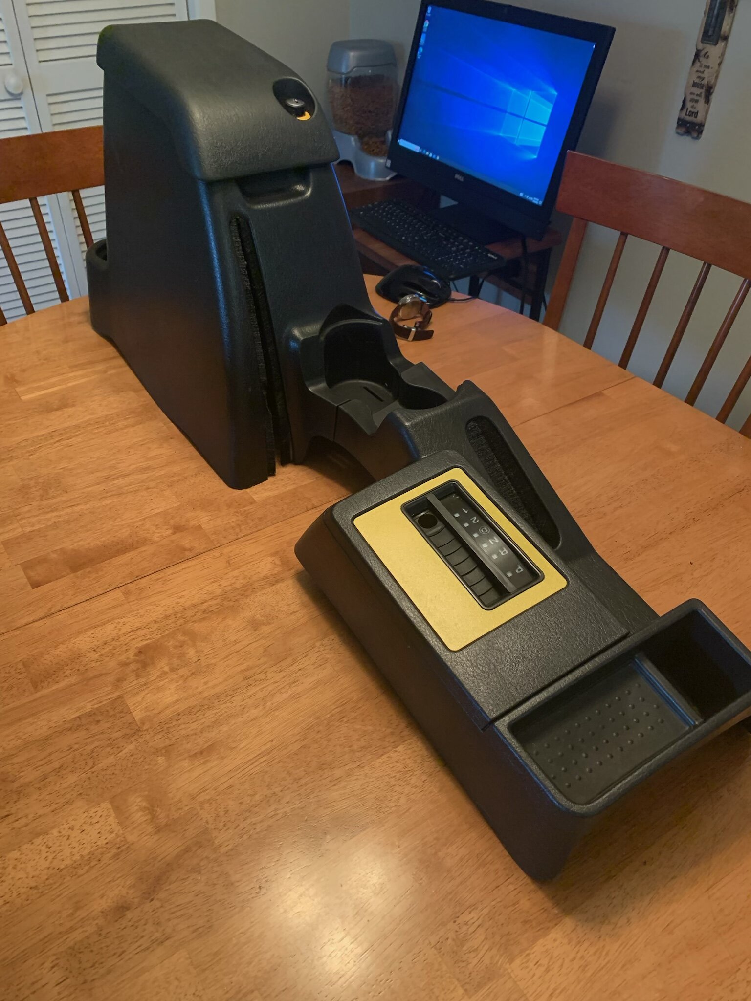

Here is a console my buddy just did- catch is I don’t know the limits with penetrol- But at the end of the day is just leaving a slight film of urethane and that is a pretty common manufacturing finish for things like vinyl tile, etc.
Interesting. I’m thinking I am wrong. I just removed the cheap chinesium fuel filler door that looked like crap and before reinstalling the stock filler neck surround I hit it with the Floop Penetrol. Actually looks great. So there’s that…

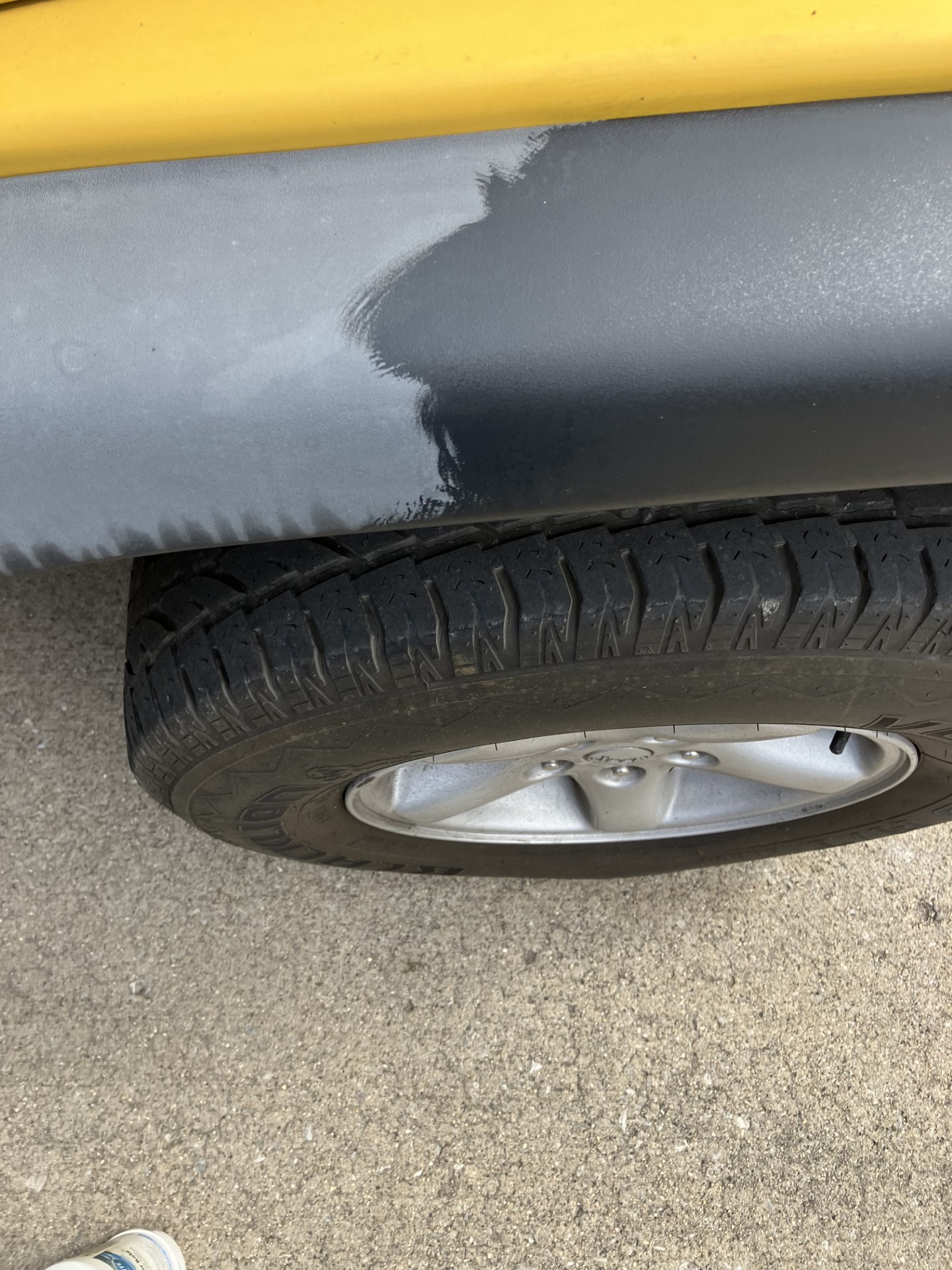

I treated the flares last July. I did them again today, this takes about 15 minutes for the flares and the step boards. The hard top takes half and hour. I use a wax pads applicator.
Is the cured finish matte black as you've pictured? Did a quick search for the stuff and find it is no longer available.. sold out everywhere unless I was to commit to a 32 oz bottle at about $50. There appears to have been an 8 oz and 4 oz available at some point, but no longer
