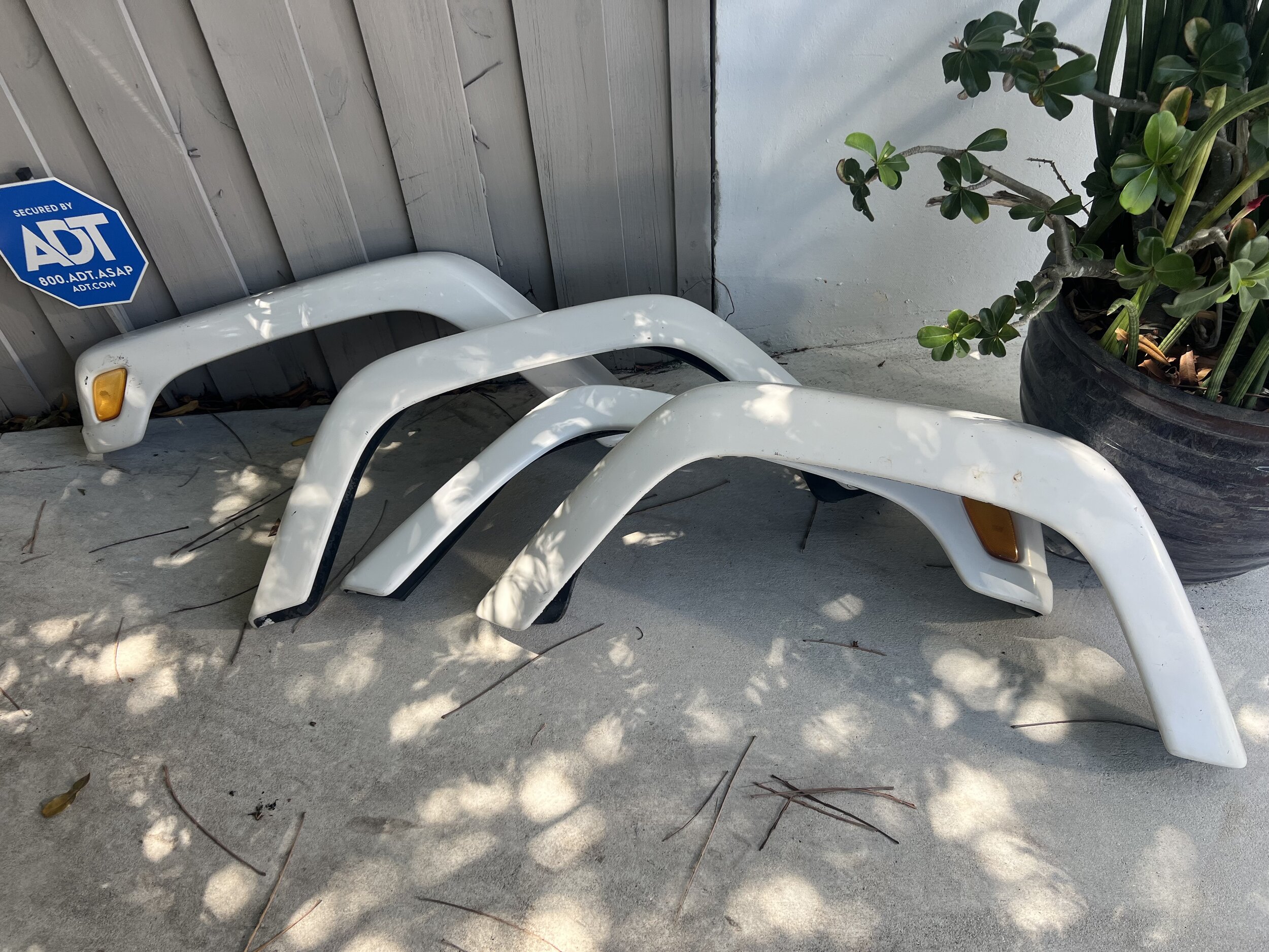

picked them up today, they're in pretty good shape but not perfect. They look like they may have been touched up a bit in some spots with white spray paint maybe. Anyone got any tips on how to get these looking like rubicon flares?

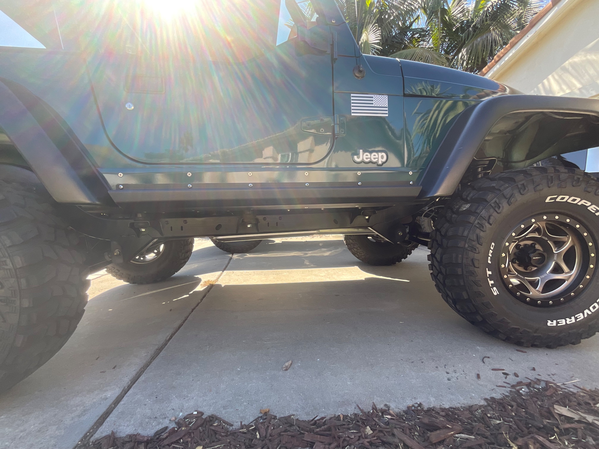

This was my process for repainting my Rubi flares. I went with black vs. the “light” black they came with stock. They’ve held up fine thus far, even in areas where I’ve scraped on rocks.
Post in thread '2005 Rubicon; A Rubi Brother'
https://wranglertjforum.com/threads/2005-rubicon-a-rubi-brother.55498/post-1204537
Reactions: TheBoogieman
man those look incredible! would you mind sharing how you got them looking so nice?
First clean with a degreaser like simple green then isopropyl alcohol to remove the old wax
I used 400 grit sandpaper with a DA to scuff the clear on the Sahara fenders. Sprayed it with rattle can filler primer, sanded once more with 400 grit and wet sanded them by hand
Then sprayed with SEM landau black paint
