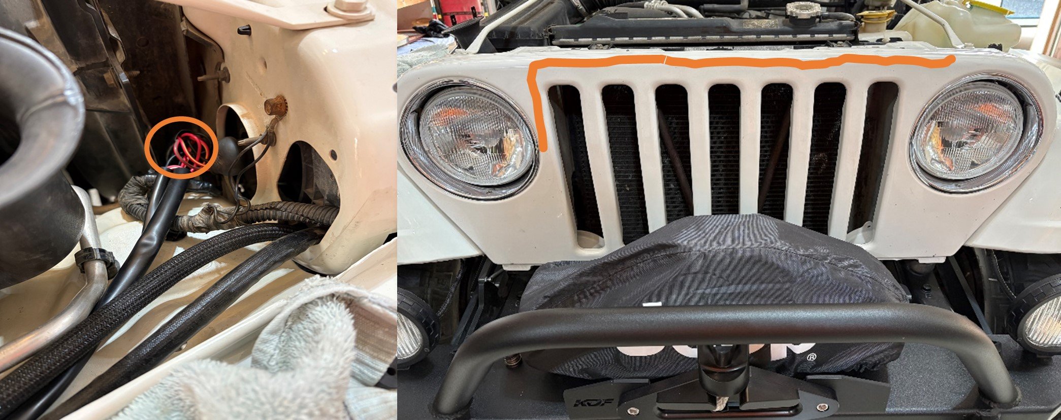

For harness routing I found a hole just below the pass side headlight opening in the core support (next to the radiator) to pass the driver side plug/harness branch through and routed it along the top of the grill and zip tied it to the harness that is already there. It is completely hidden and the routing turned out great. I am also looking for a plug/cap or something to cover up the driver side factory H/L connector that is no longer used but haven’t found anything yet.

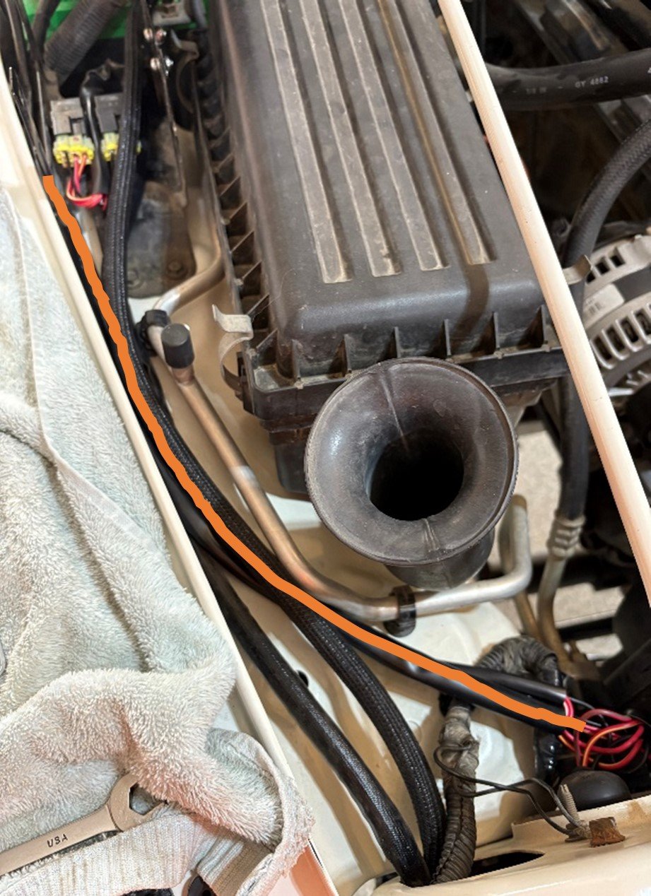

Next, I routed the power and relay/fuse side of the harness along the top of the passenger fender (orange line).

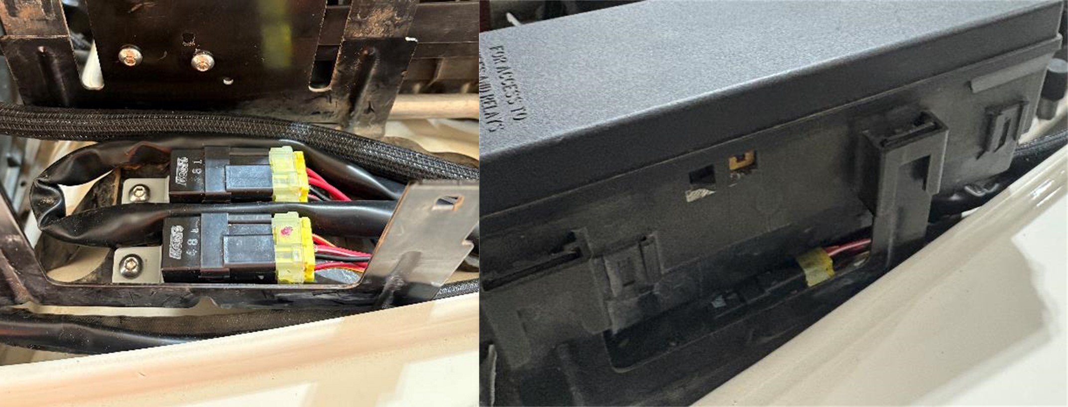

I decided to mount the relays under the fuse box to somewhat hide them and use space that would probably never be used for anything.

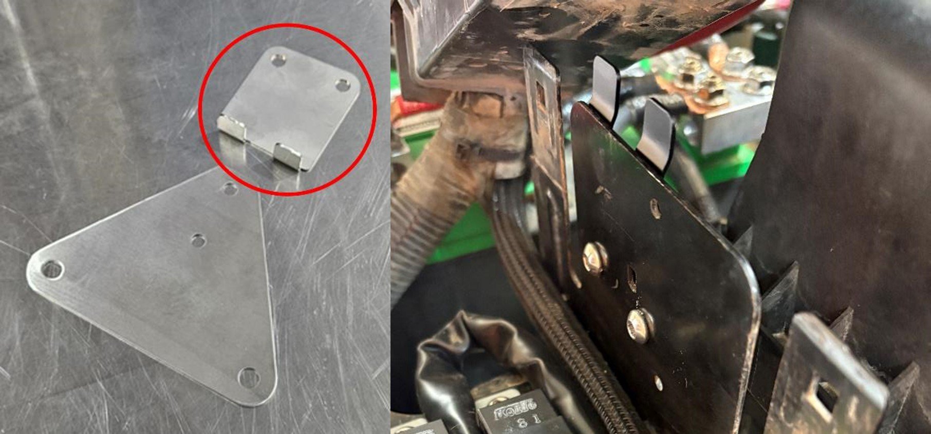

I decided to buy the fuse/relay bracket kit from Cruisermatt’s (link: https://cruisermatts.com/products/koito-headlight-fuse-relay-bracket) to see if I could make one of them work. I ended up using the one circled in red but straightened out the tabs to be able to mount it vertically on the side of the fuse box bracket.

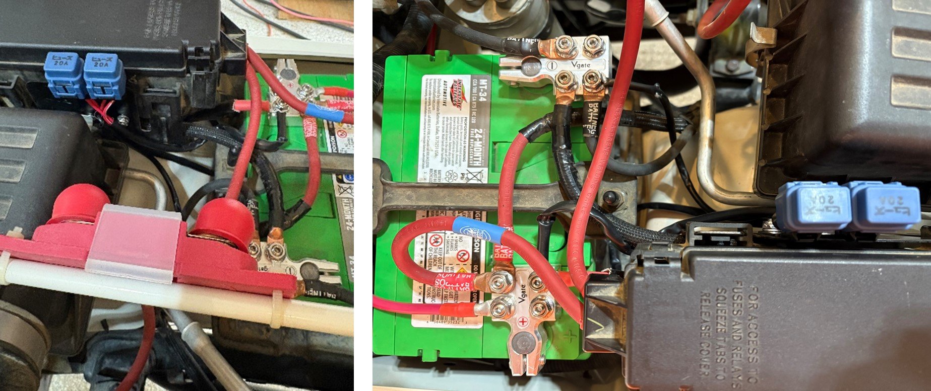

At the risk of being a little biased (LOL!!), I think the finished product turned out pretty good. The battery terminals are getting a little busy but I think it’s a controlled and organized spider web (Double LOL!!).
