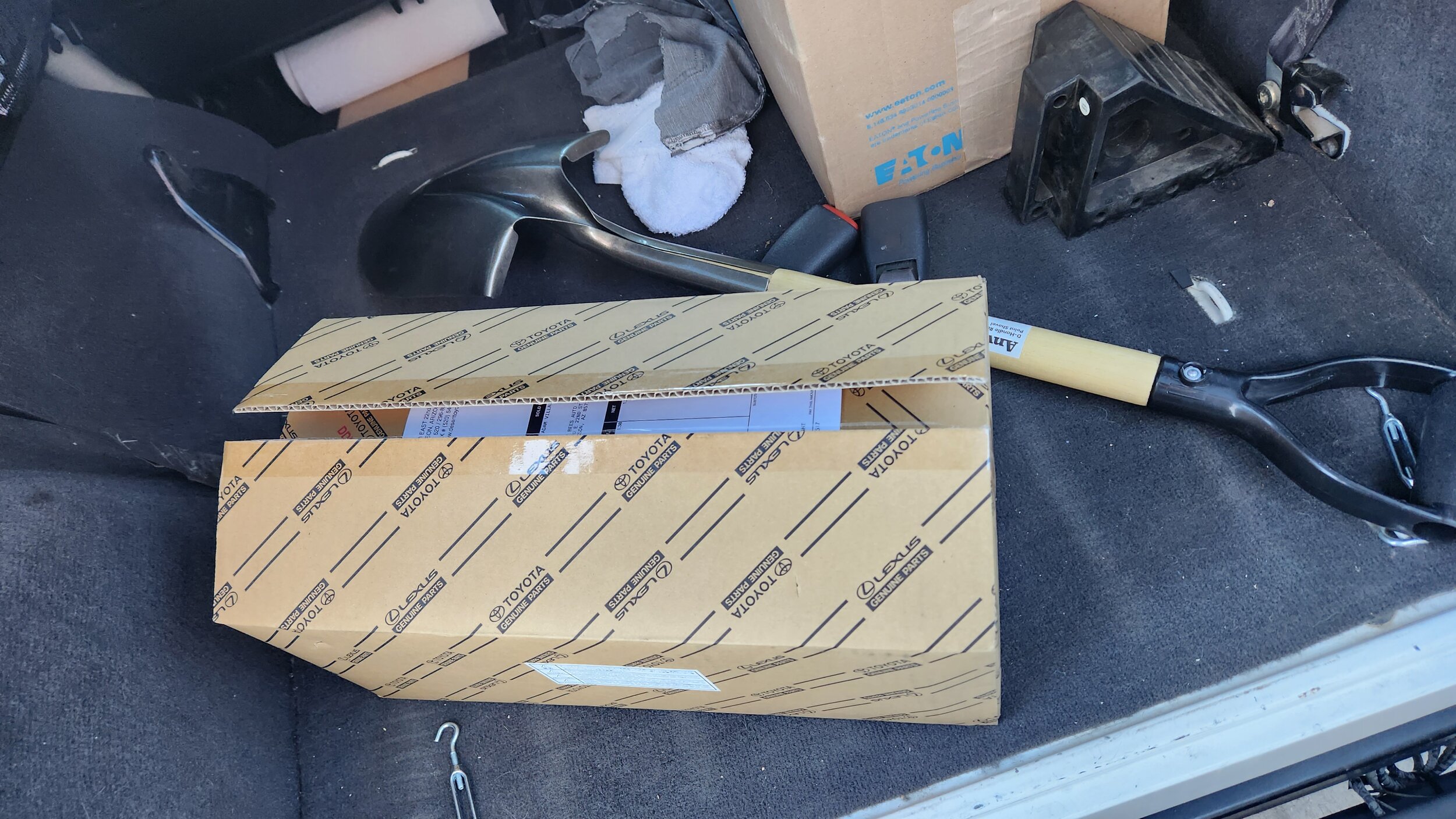

Just picked up my spare kit, being glass and I tow behind a MH I might need spares. the pack of 50 super high quality zip ties alone is worth $15!
Still available at Precision Toyota and Desert Toyota in Tucson. The guy at Desert said a guy took 3 last week.
