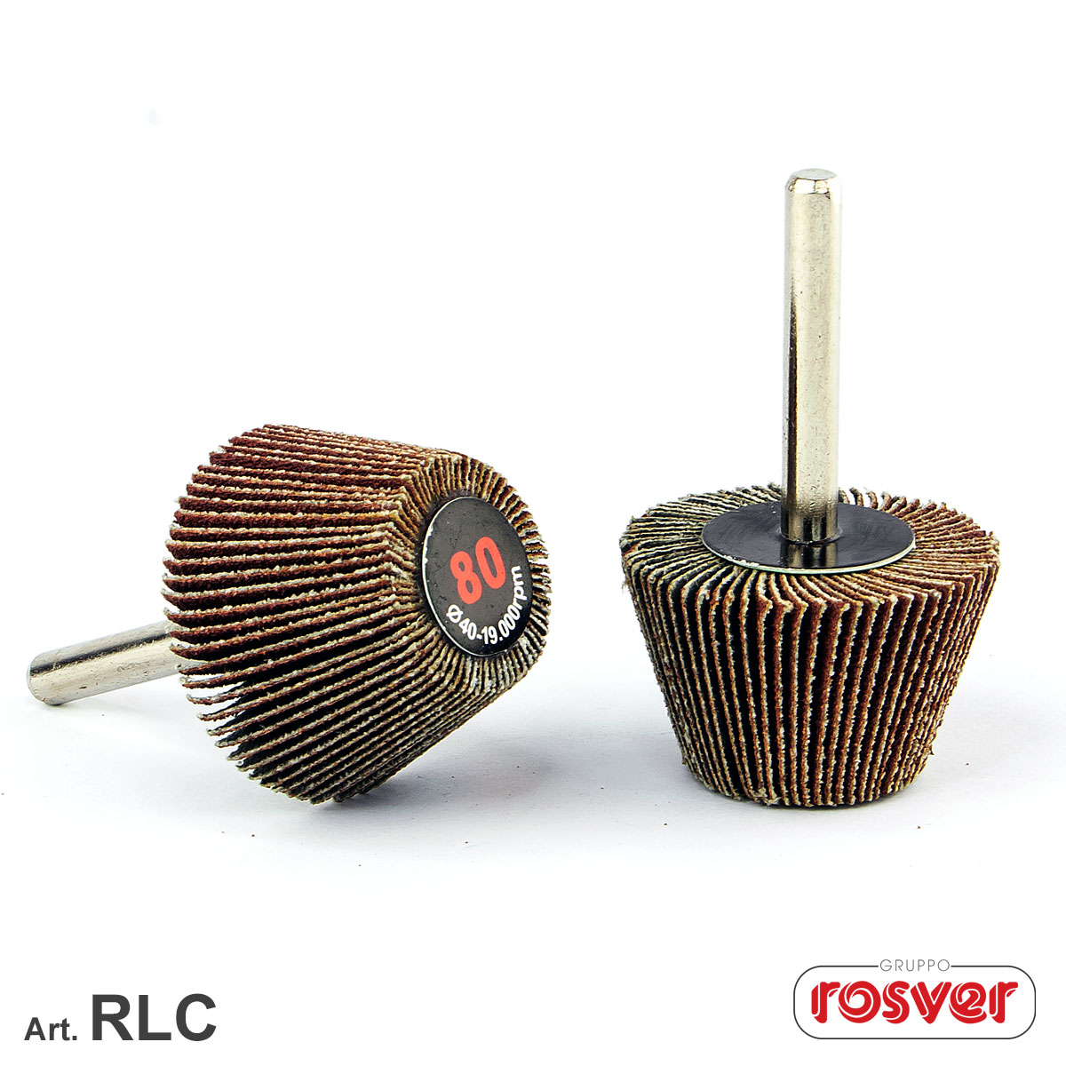

Or like this?
https://www.rosver.com/en/product/conical-flap-wheels/
  • Love
Reactions: bbaldwin237 and JMT
I guess I could use a step bit and then a flapper style like you mentioned @Wildman and get it nice and smooth. Thanks!

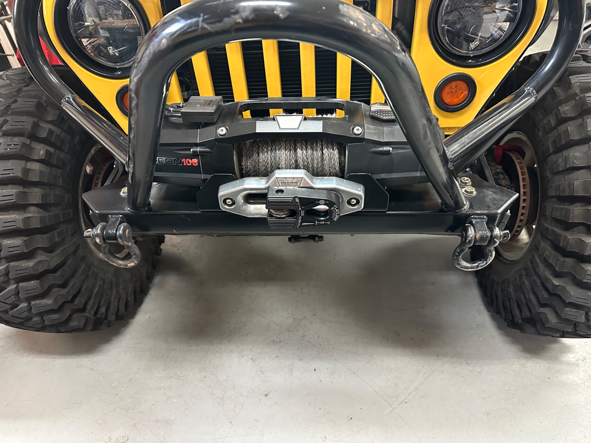

Here's how I did mine.
I looked and just realized I'd never done the front bumper.

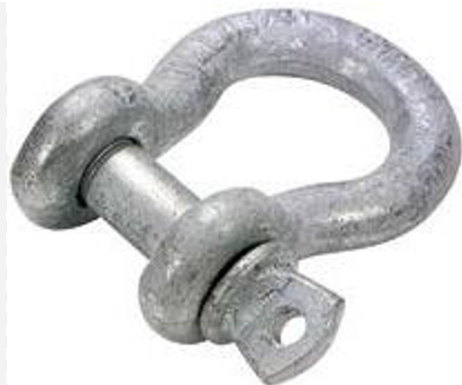

I prefer to use rated D link shackles and leave them in place. That makes for a radius that will confidently not damage the soft shackles. Mine were expensive, but I feel good about them. I have no steel components my bag. I did carry a steel snatch block until I used a soft shackle and thimble ring a few times and gained confidence in them. I then ditched the steel snatch block and probably saved twenty pounds.

If you are using steel shackles, you do not need soft shackles. In the interest of safety, you ought to eliminate one or the other to reduce the amount of connections in the rigging. In the further interest of safety, your rigging ought to be light weight where the opinion is available. A soft shackle is lighter than a steel shackle.
