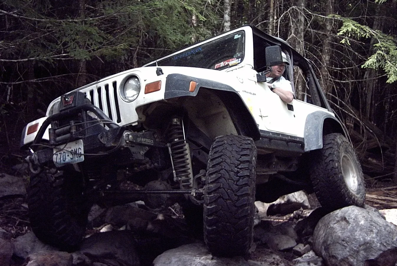

We are both different animals. I run coilovers and Rick runs air springs.
But on mine, I went through a bunch of combinations of rates to get to where i was happy with the amount of preload to get to a good ride height. Also, a dual spring coilover is a true dual rate spring, so you can tune the ride a good bit.
But the difference with the Hemi was not much. The supercharged 4.0 it replaced was not very different in weight.

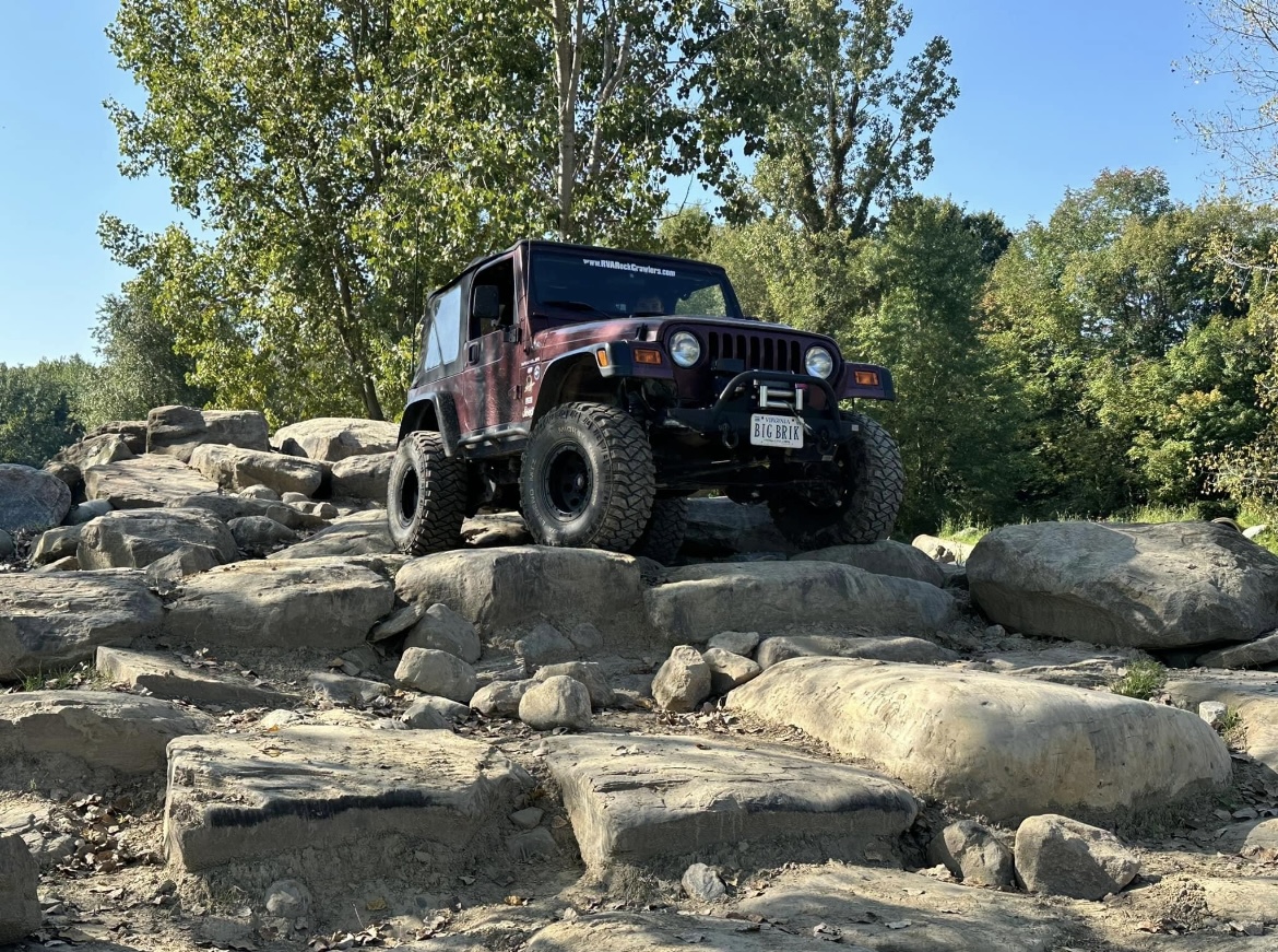

Hey guys,
Little bit of a background on my build and why I’m asking the question in general. I’ve got an 02 TJ that’s about to have a 5.9 magnum, it’s got aftermarket front and rear bumpers, a winch, and a spare. I’m looking to go to a 4” spring in the front and 3” spring in the rear to mostly have leveled out suspension with 35s, I also have a 1.25” body lift. My problem is determining which springs to use by which brand, I was looking at Rockjock/currie springs but have read they can be soft which wouldn’t really be great for my on road drivability with the extra weight of the 5.9 and the bumper and winch. I’d prefer a dual rate spring to improve my on road drivability as much as possible(yes I know it’s a Jeep so it can only be so good). My use of the TJ is a daily driver as well as going out and taking it rock crawling as much as possible. Any input is appreciated. Thanks!View attachment 639161
TJ spring rates have nothing to do with ride quality. They just set the ride height. For ride quality you need to focus on shocks.
