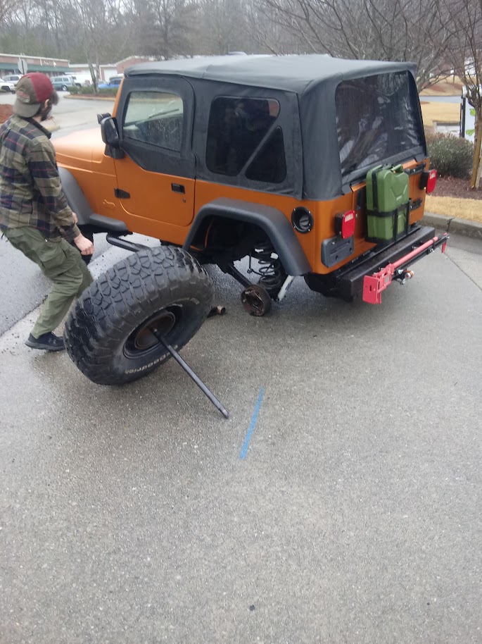

I hear ya, but the disk brakes will retain the axle, which would allow you to get somewhere safely and not have a axle fall out. But yeah the super 35 with disk brakes or c clip eliminator would have the same effect but at that point you're 2000$ in and could've got your hand on a dana 44. Anyways I guess I'm just traumatized by dana 35s after what happened to me :ROFLMAO:
I was lucky and got my hands on a Warn full floater kit when I'd first bought my TJ with a Dana 35 so I never had the broken axle syndrome... But I had buddies who did and I've got 2 who did the 8.8 swap. I had one I was going to swap into my daughters old TJ.. Even have a Barnes truss kit sitting in my garage. Got a 8.8 for $50... Sold the axle after I'd sold her TJ.
