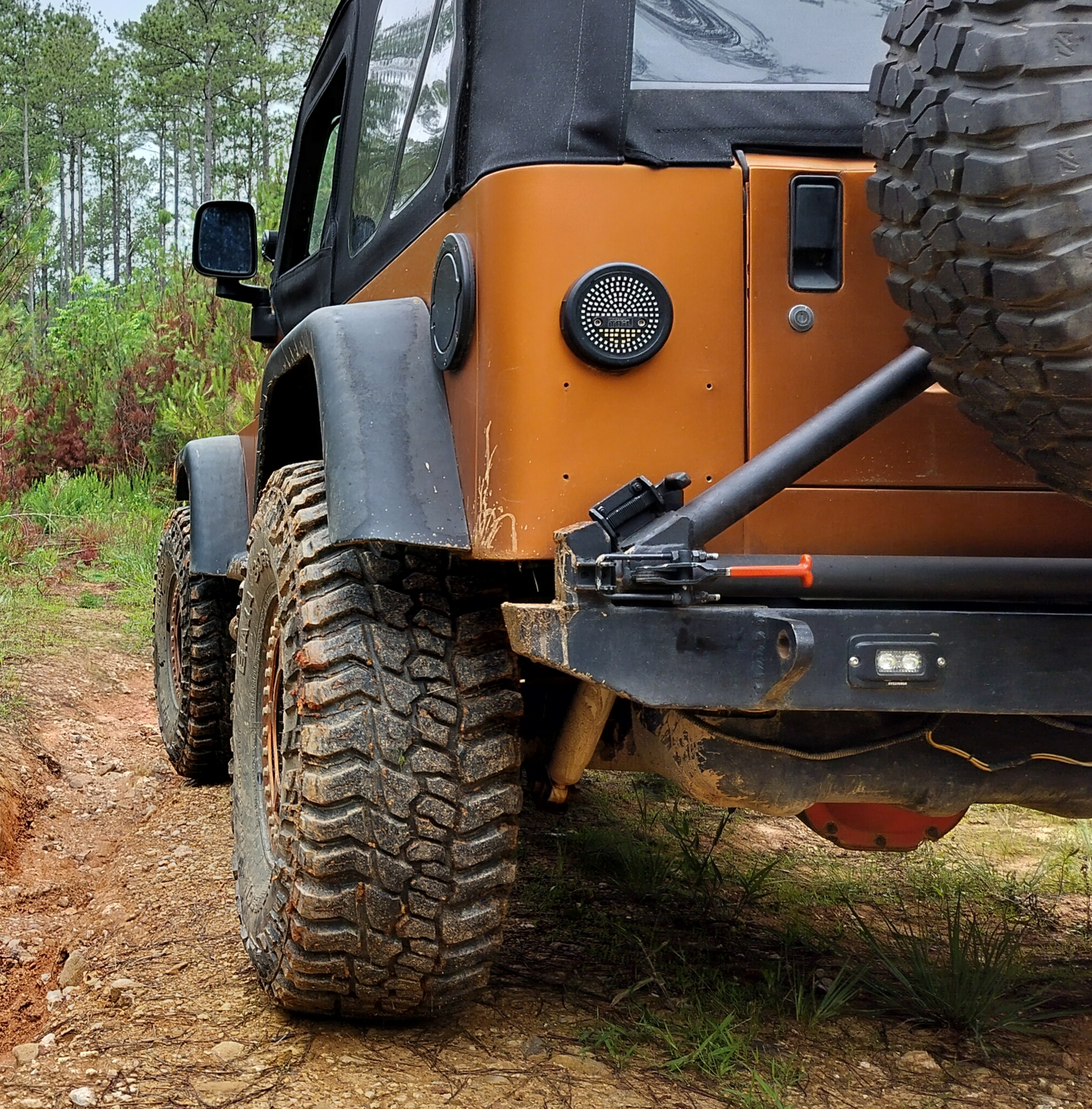

I don't have a lock on mine, but I put a slam latch on mine so if I did leave it open it would close itself. I've only forgot it once lol. Scared the shit out of me when it closed.
It's also double latch cause my friend who got me into jeeps has broken 3 different tire carriers at the latch so I made this one super rigid. Kind of inspired by the PS rockbrawler design except theirs looks clean 🤣
