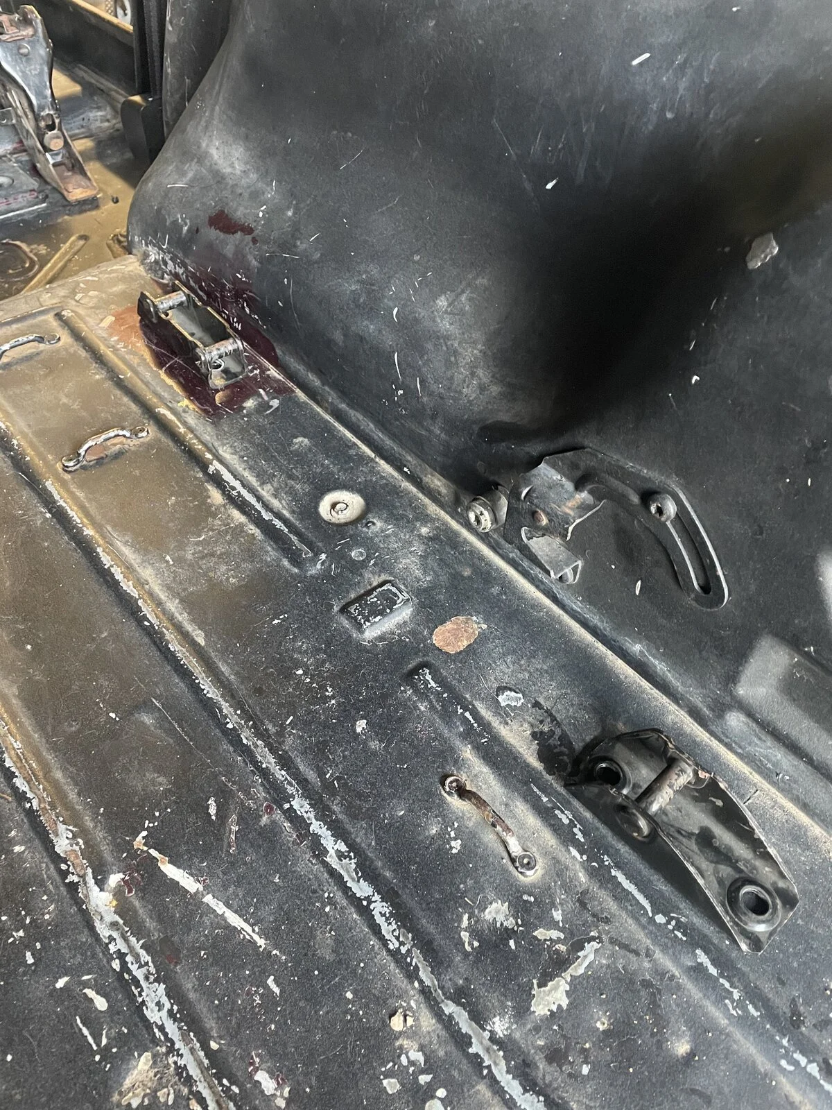

Or do you need a measurement from the front of the rear seat pan to the mounting holes? The early TJs use different mounting brackets, so I am not sure if that is part of the issue. Later TJs/LJs don't have the catch on the wheel well, just on the floor.
First picture on this thread has all of the mounting brackets showing.
I have read that the seats are interchangeable as long as you have the correct brackets.
