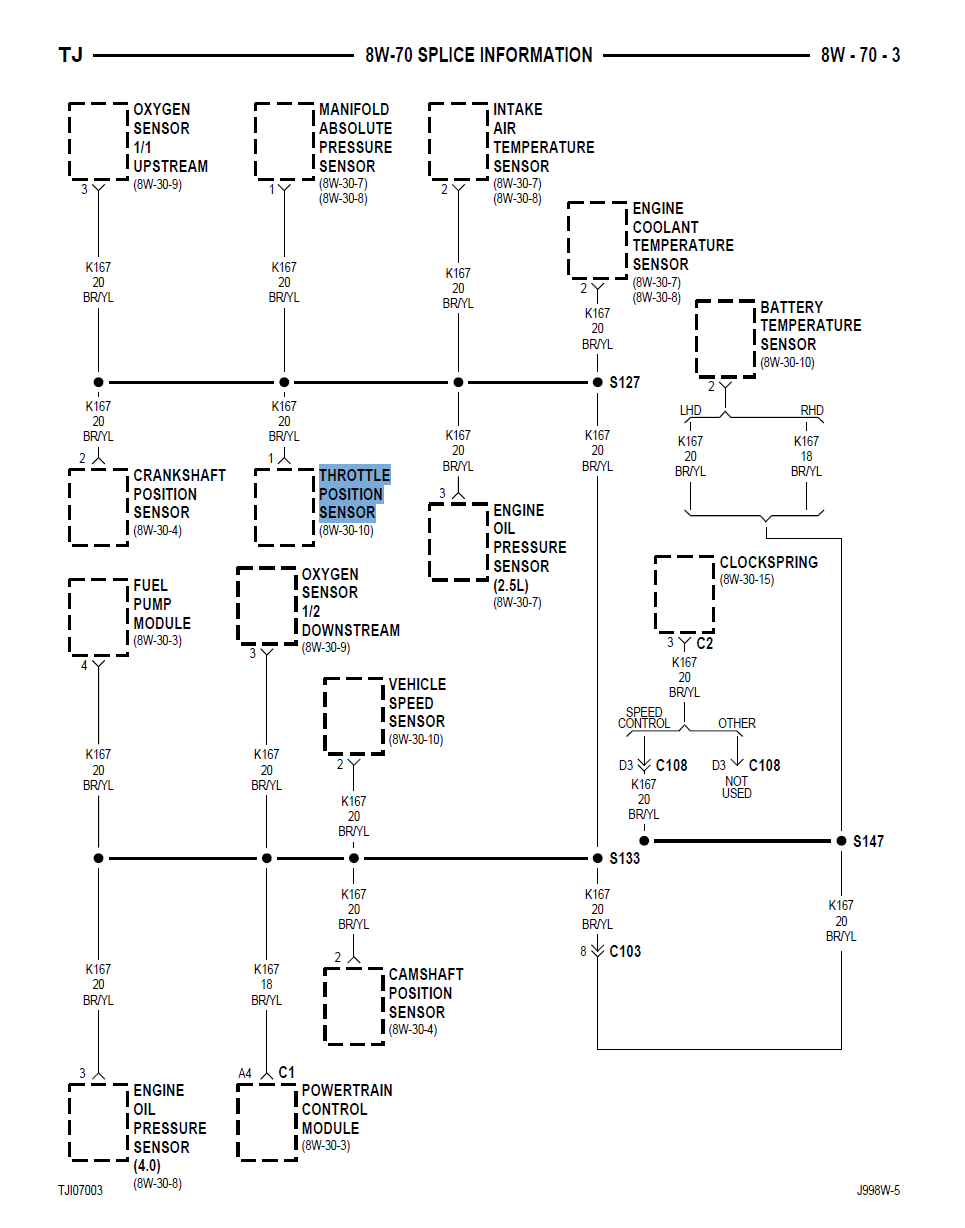

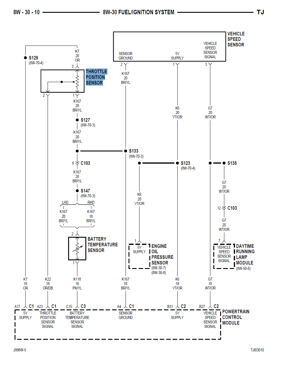

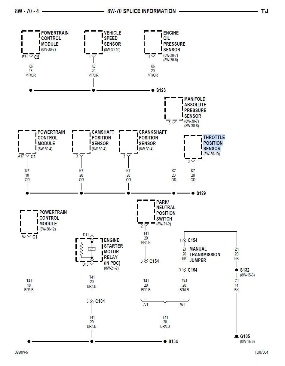

I got it! Ok so I tested everything working my way back to the PCM And Again I started in the wrong direction. The plug had the correct 12 volt but the pin inside had been pushed in just a little when I put it together. It was enough. I reseated all the pins. (tip using a large sowing needle to line up each pin as I pushed the plug back together) It started right up. No codes!!!! Again thank you everyone willing to get on here and give me a hand! I really apricate it!
