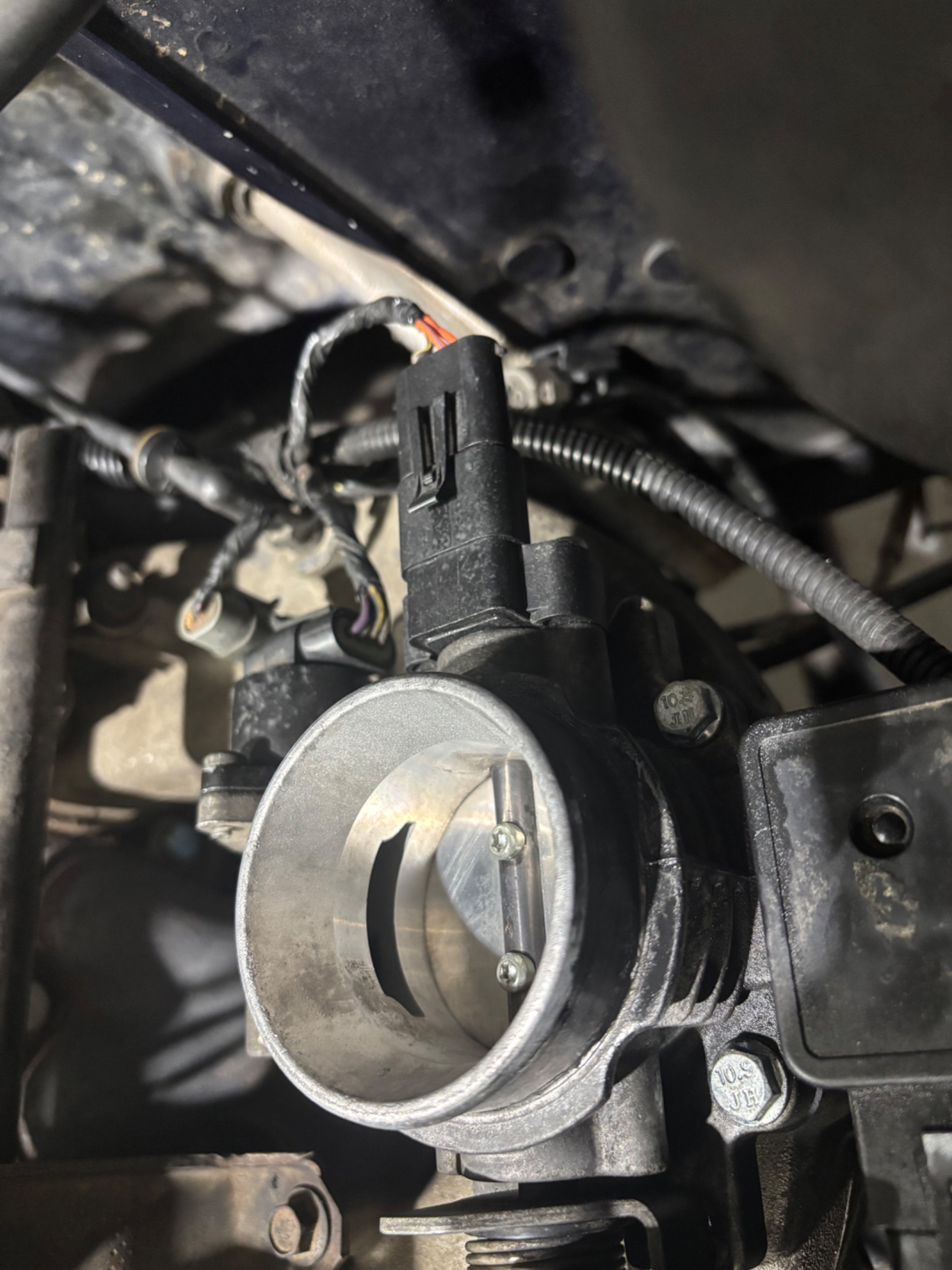

Just for reference, I have a 97’ with the 2.5l. I recently got a P0121 and P0123 DTC. Some symptoms that I have noticed that could point to my TPS is at once I let off my throttle my idle drops to about 200-300 RPM and oil pressure drops to 23-25psi. The oil pressure makes sense because the pump is barely moving anything at that low of an RPM. When idle drops it occasionally levels out at about 700rpm when coming to a complete stop (this is only an issue in stop and go traffic).

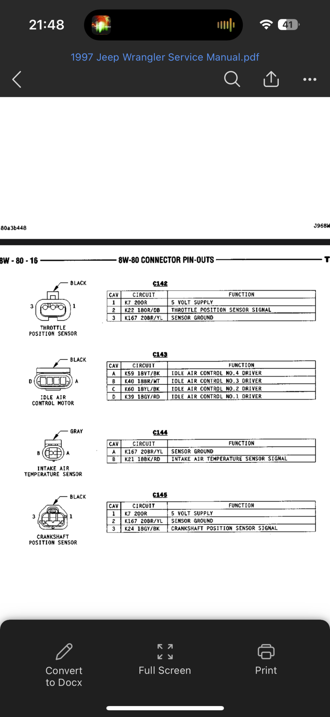

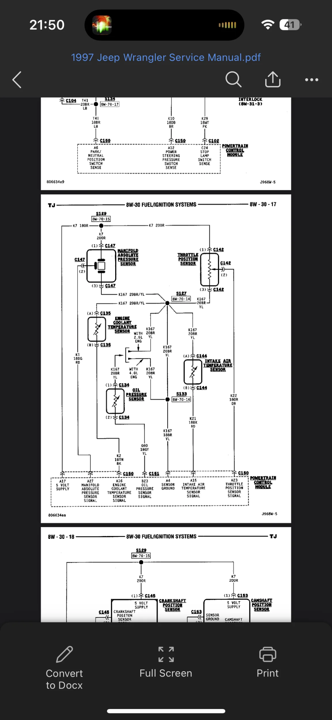

I tried everything that I can think of I backprobed the wires in here are my findings. Attached is my wiring diagram and I will be referencing the wire colors and tracer colors just for simplicity.
K7 200R is my 5v (Solid Orange)
K167 20 BR/YL is sensor Ground

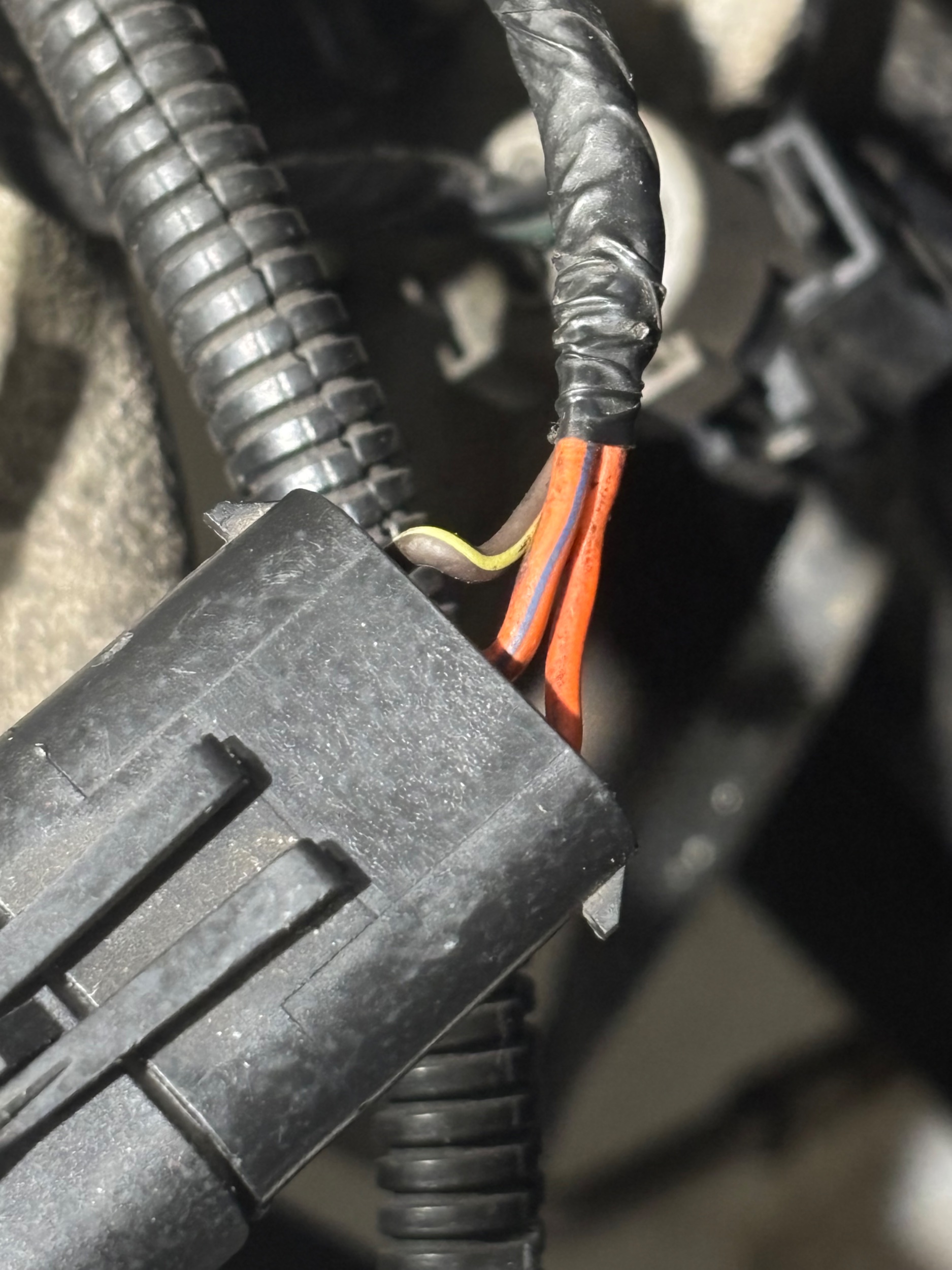

K22 180 R/DB is my Signal wire (I’m not sure where the Red comes from but it’s Orange with a Blue Tracer)
Some confusion that may arise may be because my wires aren’t the same color as the Manual states….

You will need look at the wiring schematic and test continuity between the TPS connector and the Splice connections at S127, S133 and A4.

Also the factory orange no stripe wire coating often looks quite red to me irl and cameras have trouble discerning red/orange sometimes.
I'm not sure whether there's been any prior work done to your harness, but it looks factory wrapped.

Looking at the wiring schematic; i thought this would be a problem area to test and rule out.
I would test the splice connections that I referenced earlier.
