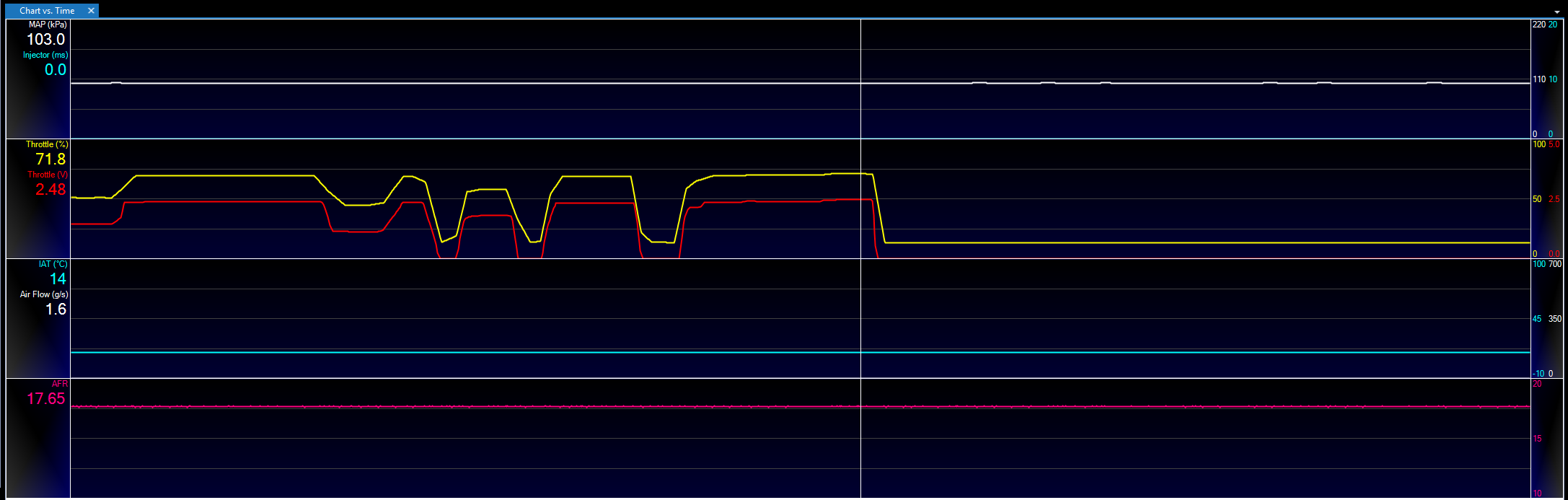

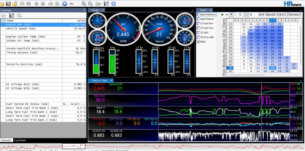

What min. and max % values for Throttle Position (SAE) do you see with HP Tuners VCM Scanner?
My 2006 is 11.4% at idle and 79% at full throttle.

The percentages that I quoted are from a log file done with HPTuners VCM Scanner.
The actual voltages read with a digital multimeter at the TPS connector are 0.518v (10.36% of 5v) throttle at idle position and 3.948v (78.96% of 5v) with throttle at full, these voltages are with reference to the negative terminal of the battery and the engine not running.
