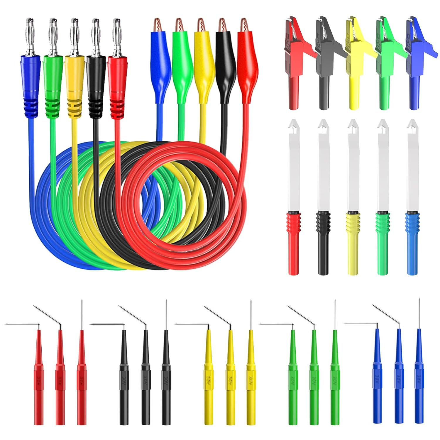

Thanks for your response.
I have attempted to do so, but my test is partial so far. I tested the voltage in the harness that connects to the TPS. It reads less than 1V on both the power and signal source (0 on the ground). But the harness was disconnected from the TPS at the time. I could not get a reading on the voltage with the harness connected because the access points are buried down in the harness and I was worried I'd damage the connection if I tried to jam the multimeter probes down in there. So I don't know if this helps at all. Needless to say, I was not able to get a reading on how the voltage varies when the throttle is opened b/c of the above access issue.
How do others get a good voltage reading with the harness connected?

You use a Back Probe attachment for your multimeter leads.
https://www.amazon.com/Goupchn-Alli...-Diagnostic/dp/B083K5698M/?tag=wranglerorg-20
Reactions: macleanflood
The T-pins work but the back probe attachments are safer. You can still short out the leads if you're not careful. They are nice to have for many reasons.
