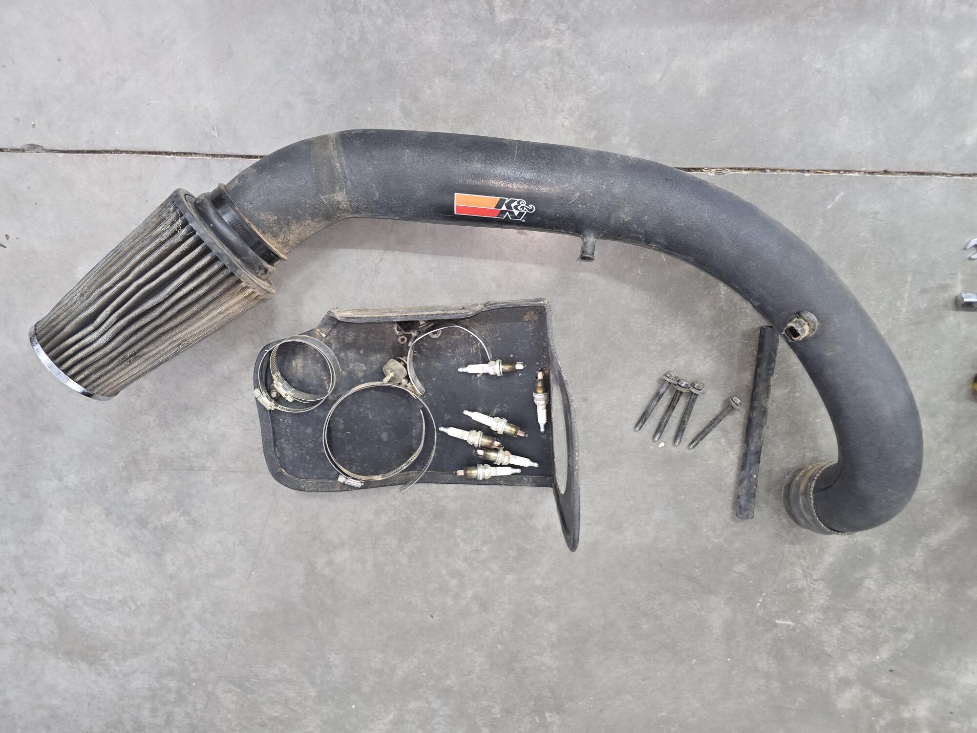

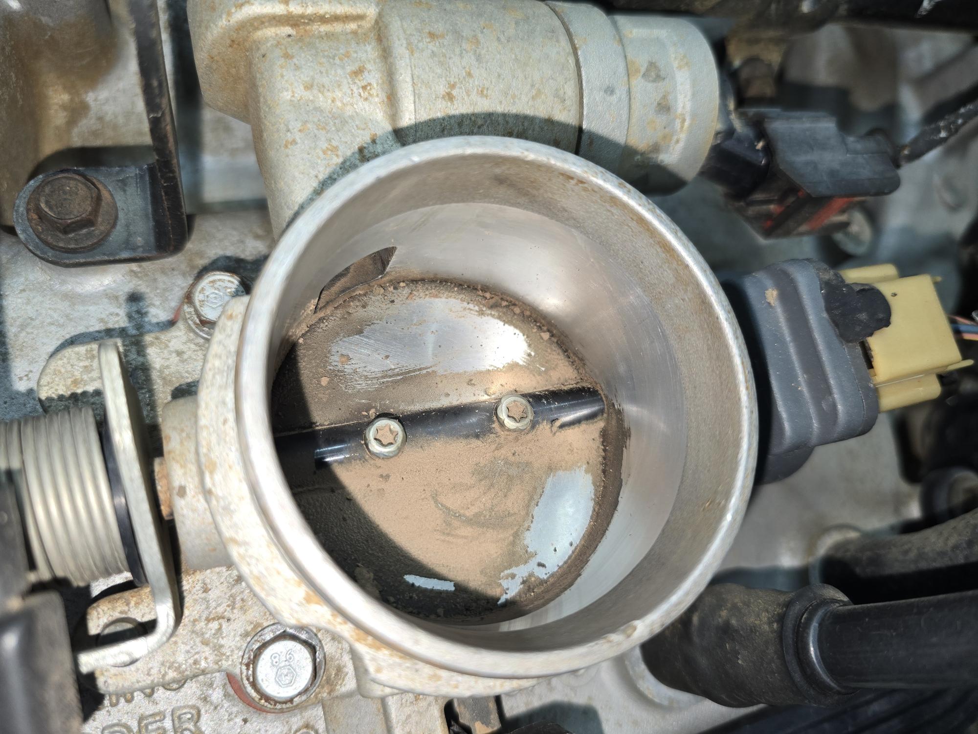

Showing removed from mine from the PO as that headed to landfill. Also, TB butterfly (subsequently cleaned along with several cans of Sea Foam consumed). A used 2005/2006 OEM airbox / tube, along with fresh Fram filter panel and Autolite XP985 Iridium installed ~1k miles ago. Um, right - dirty air filters work better...
The K&N filter media is notoriously bad. My dad's LJR has one just like this courtesy of it's prior owner. I shared a couple photos from the thread below and convinced him to change it to the AFE dry media which is a direct replacement for the K&N filter. I really wish all these companies would publish their data and that aFe Power provided their filter test numbers themselves. The tests I've seen (incl this video) don't clearly indicate which version of their air filter was tested, but they're always miles better than K&N.
