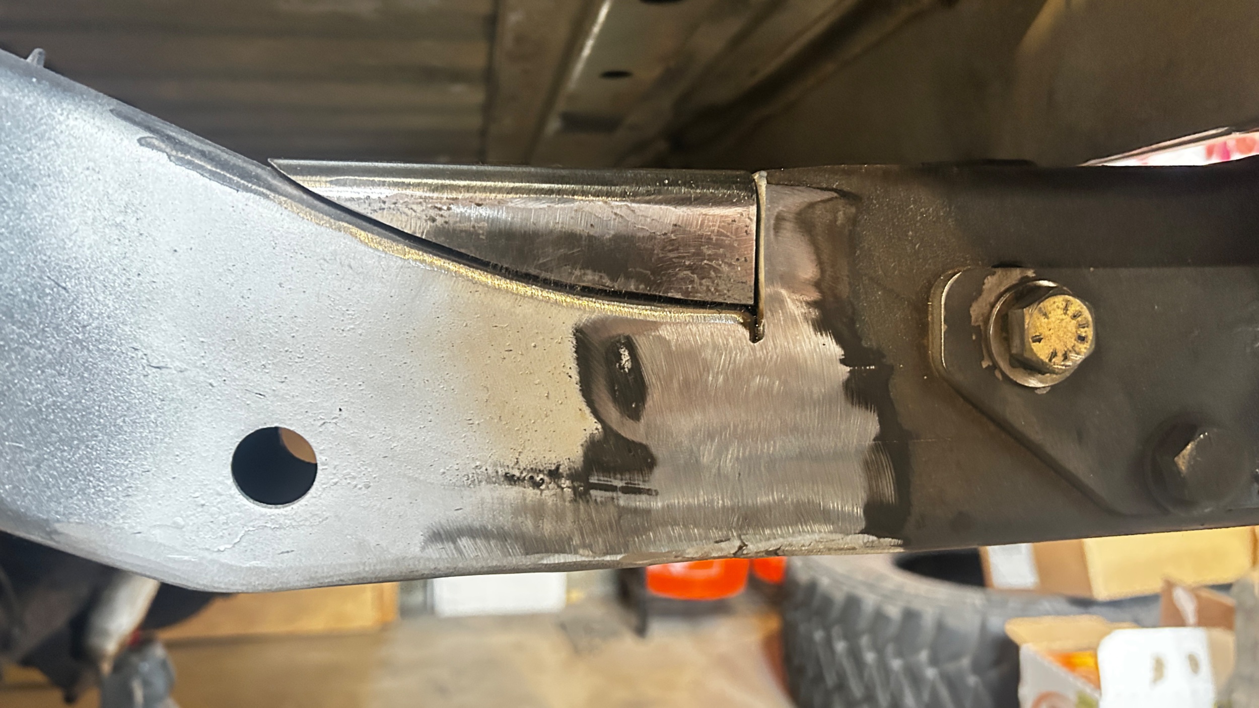

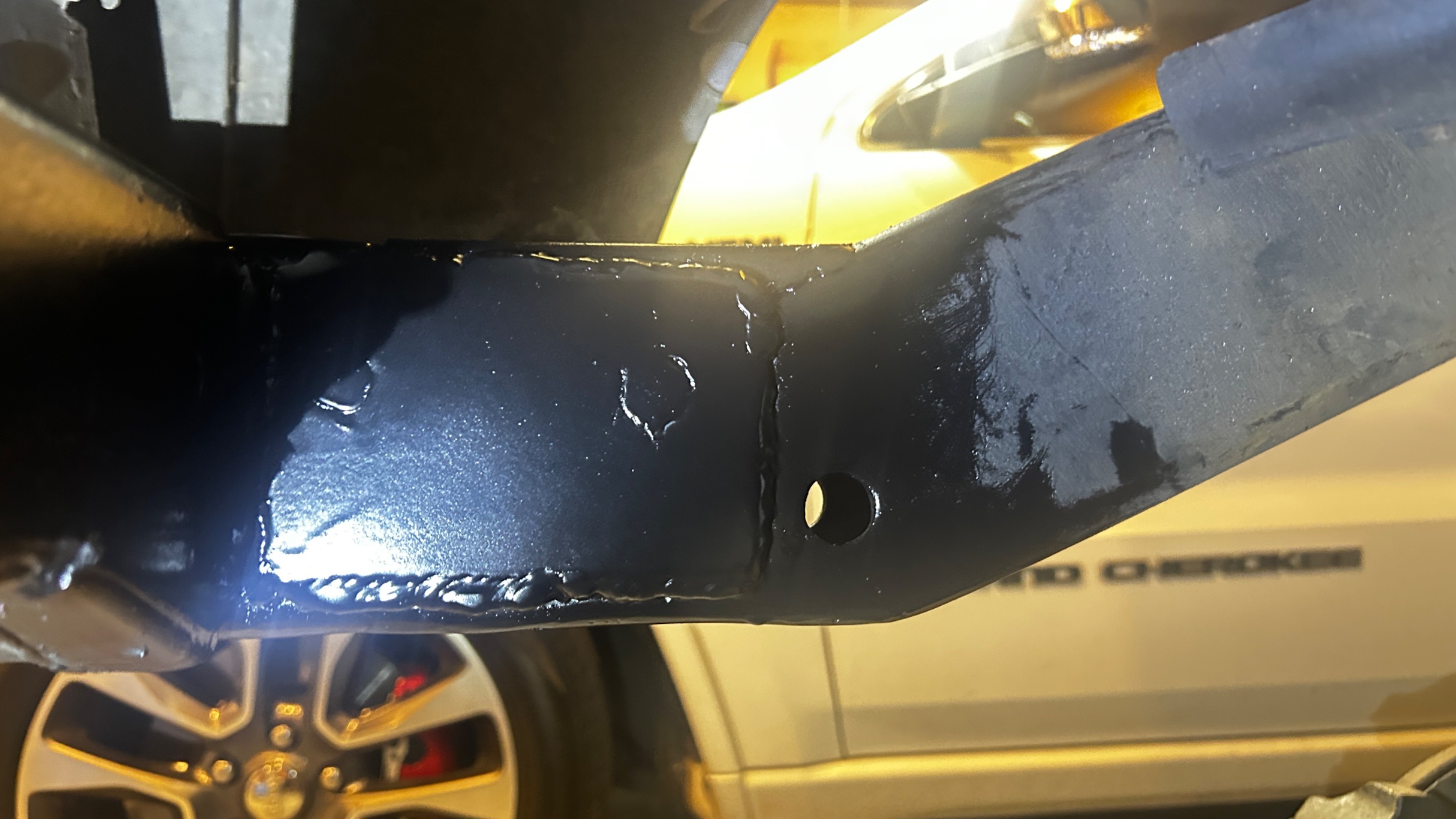

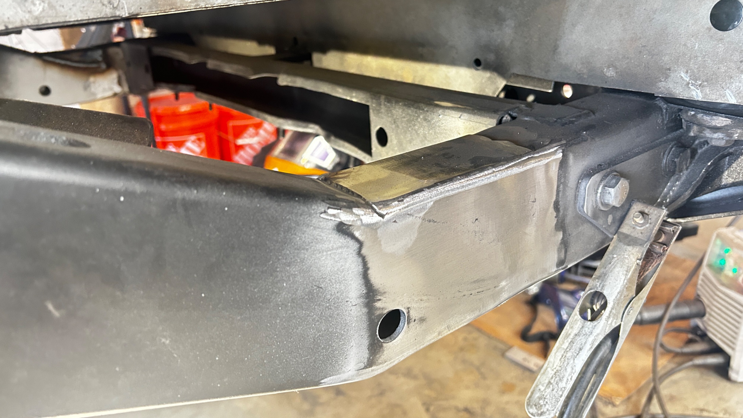

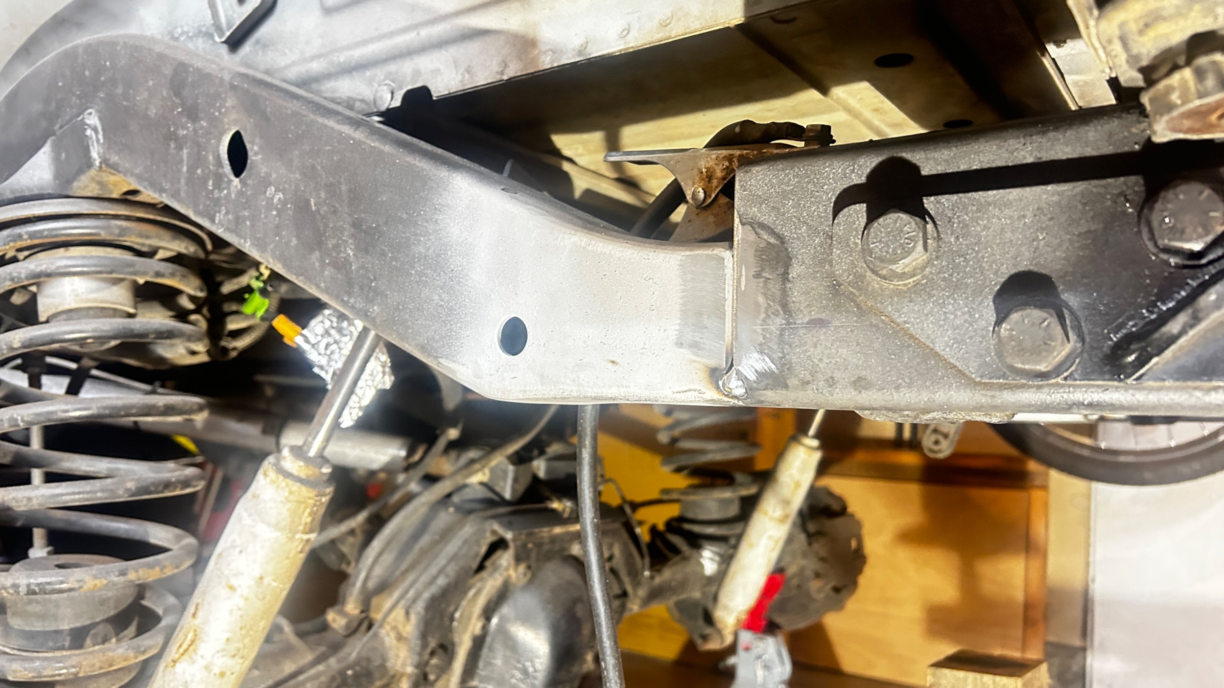

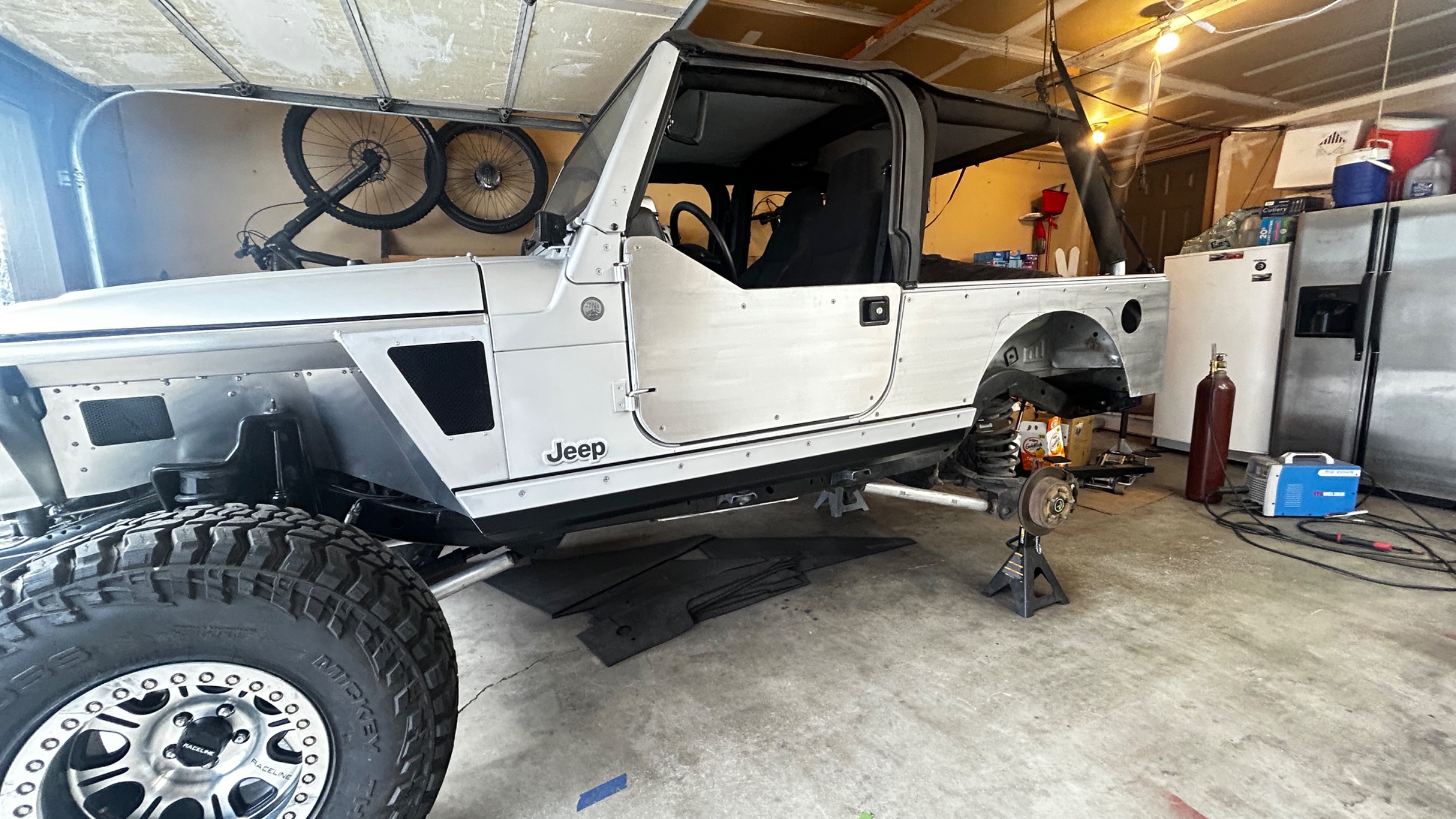

I got the rear frame tuck done. I’m just painting it now. Now I’m wondering, should I move the upper perches next? Or should I do the raised body mounts? Either way I’m not putting the gas tank back in until I’ve done all this. The last thing I’ll do is outboard. Some pics from the process. Grinding gets old!

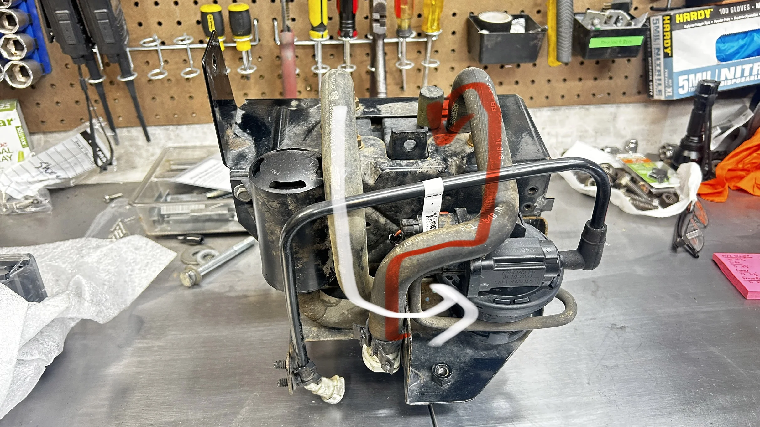

Concerning the evap canister delete in the ‘04 where it’s in the rear wheel well, do I connect the red tube that goes into the canister to where the white tube goes into the purge valve?

Did you end up adding a fish plate?

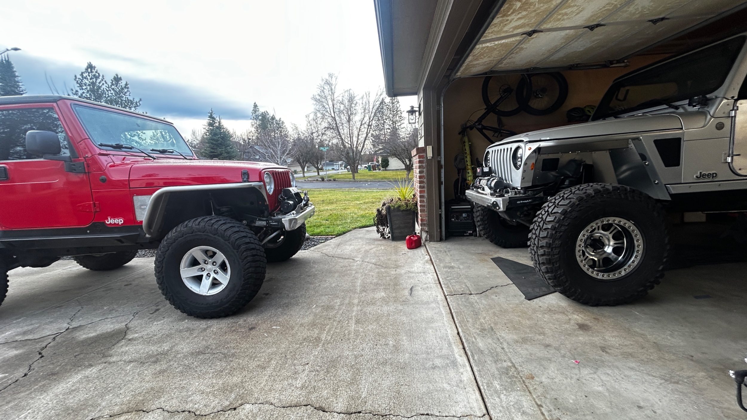

Wow, those look so different.. do you have to deflate to get out of the garage? :D

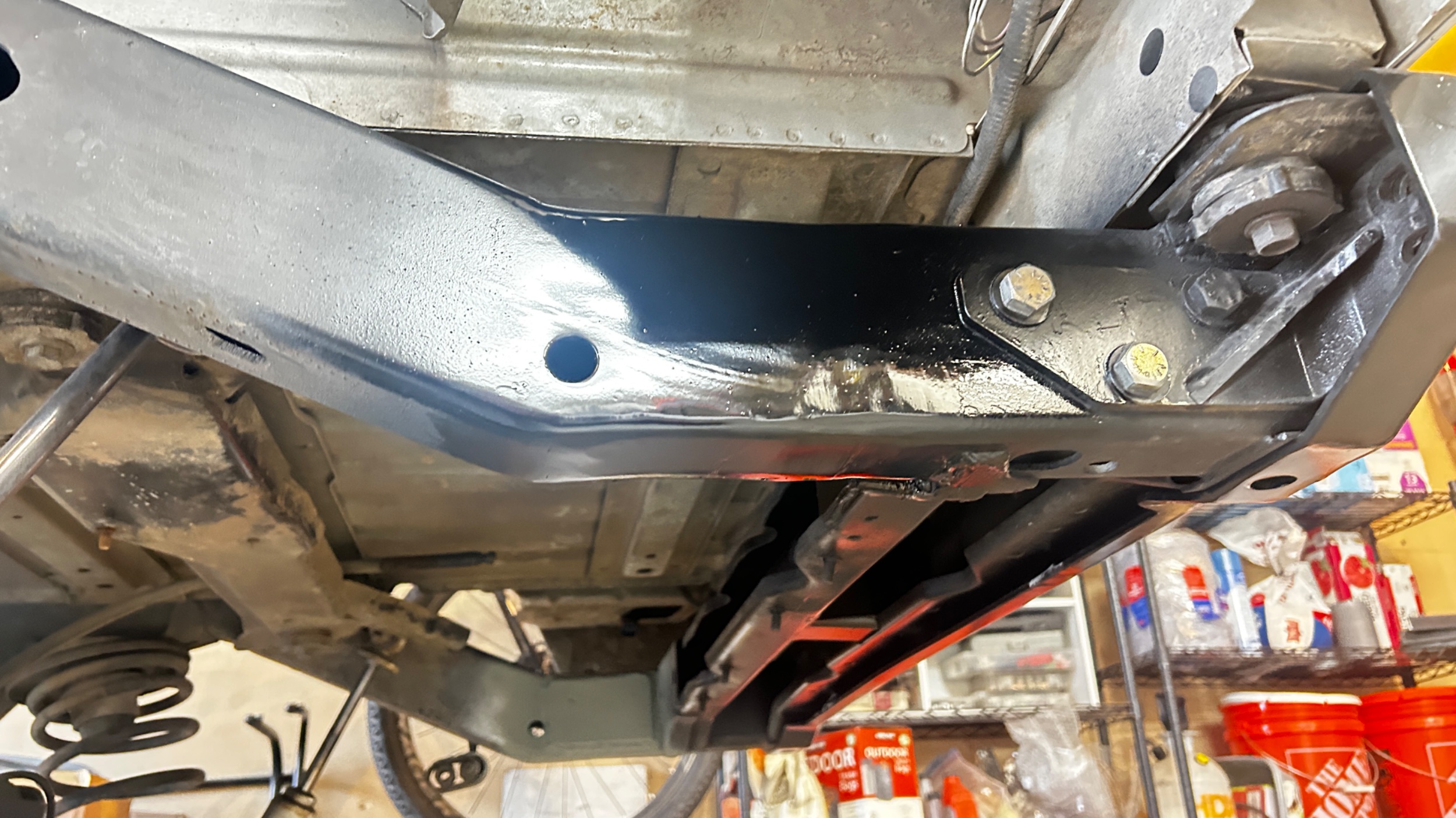

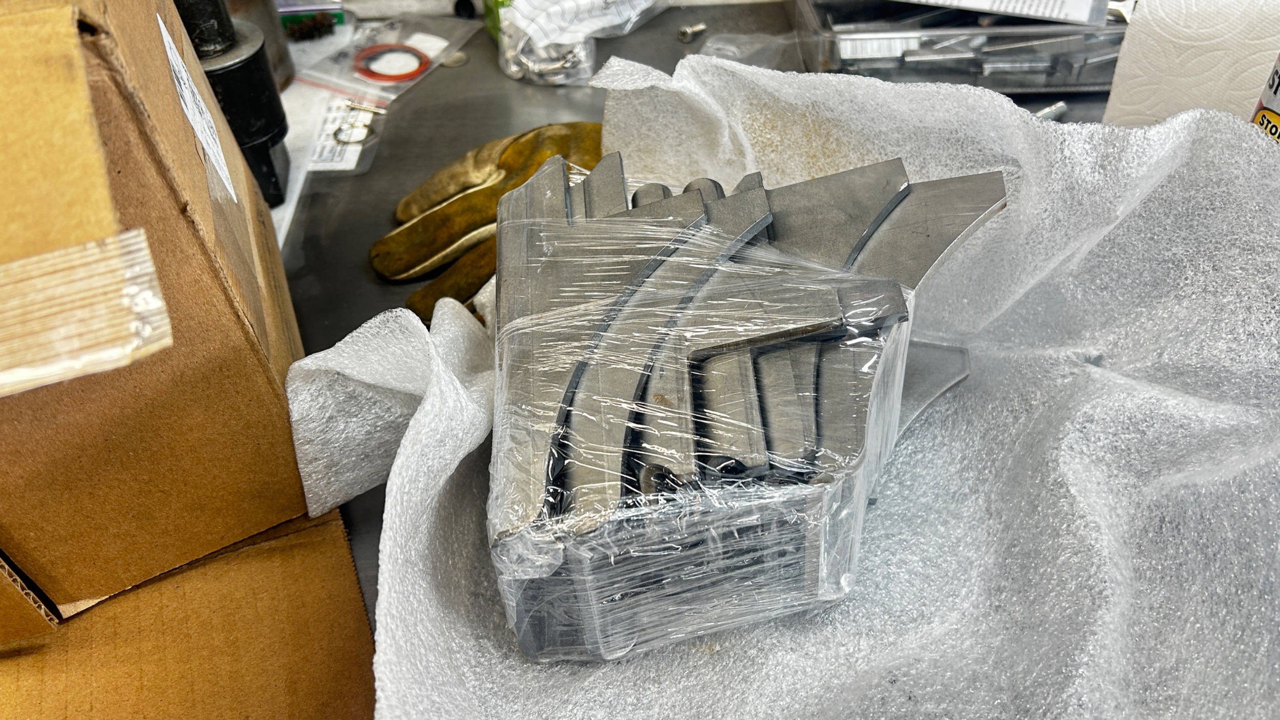

Yes. I added 1/4” fishplate on the inside of the frame like you suggested. 🙂 I also put two 1/2” holes in the fishplate for spot welds. The drivers side is super close to the gas tank skid, so I slotted the gas tank skid holes so I could fudge it toward the passenger side when I reinstall it.

I still have a couple of inches clearance so I can get in and out of the garage!
Here’s one of the fishplates.
