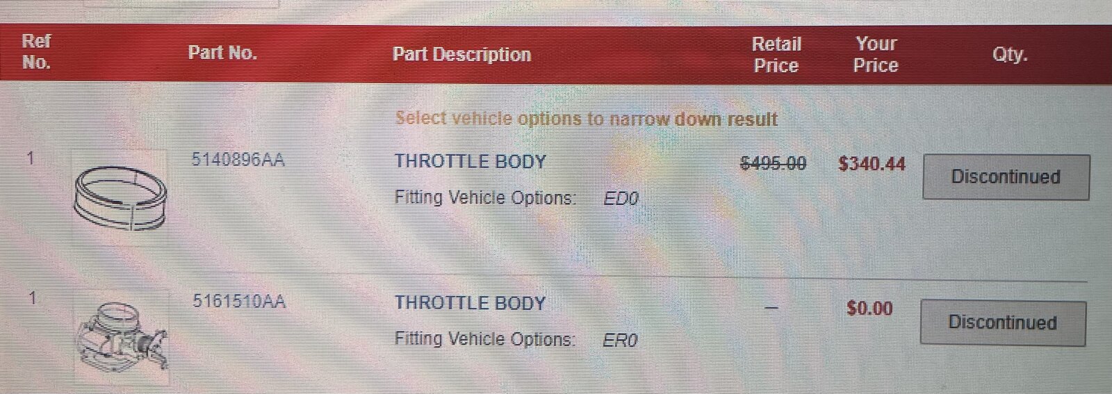

That may not be an option for me:
Although my whistle is coming from the bottom edge of the throttle plate. At idle it’s a moderate whistle and it gets louder with the tiniest bit of pressure on the throttle cable/gas pedal.
With the air intake off, I can eliminate the whistle by blocking a half inch or so of the gap between the throttle plate and throttle body wall.
I’m not sure there’s supposed to be any airflow through there at idle, but apparently I have some.
