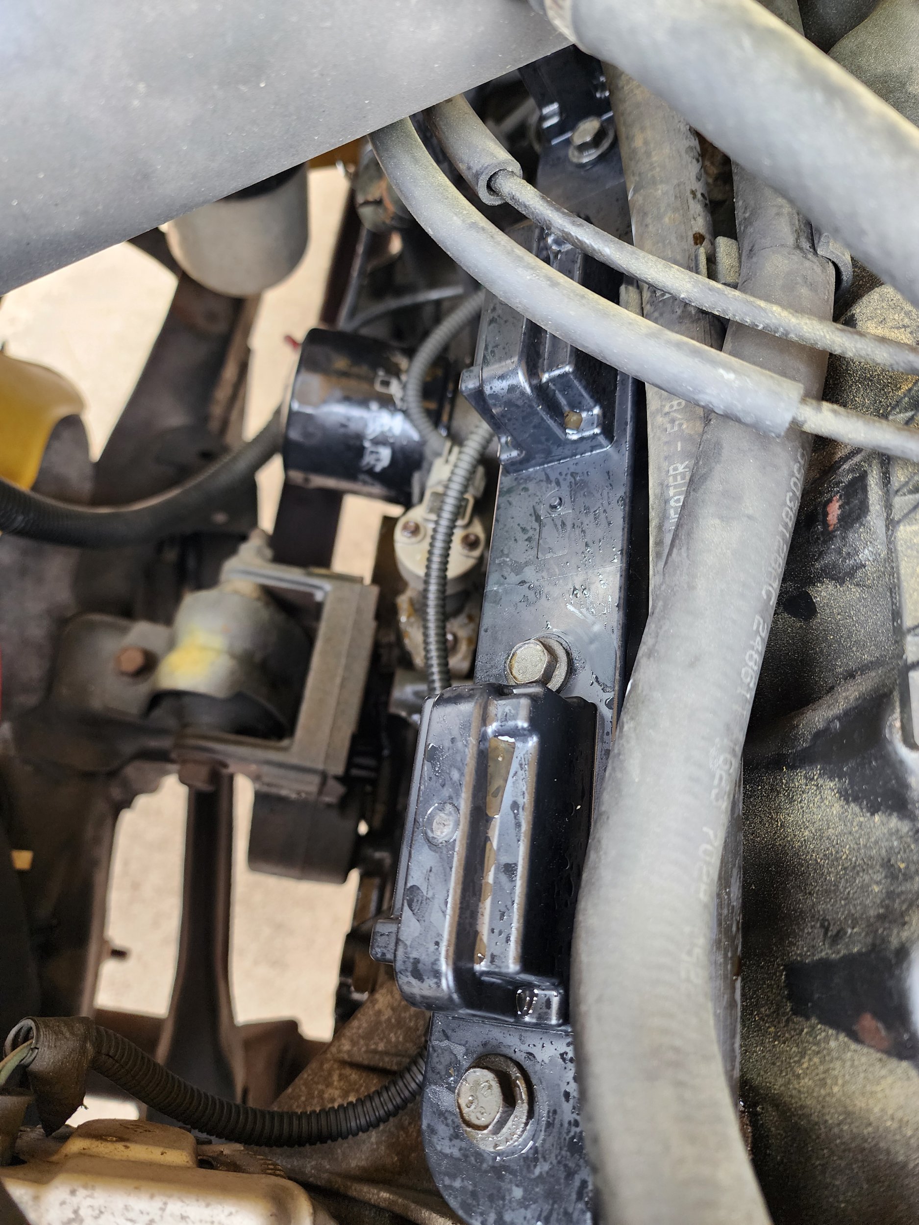

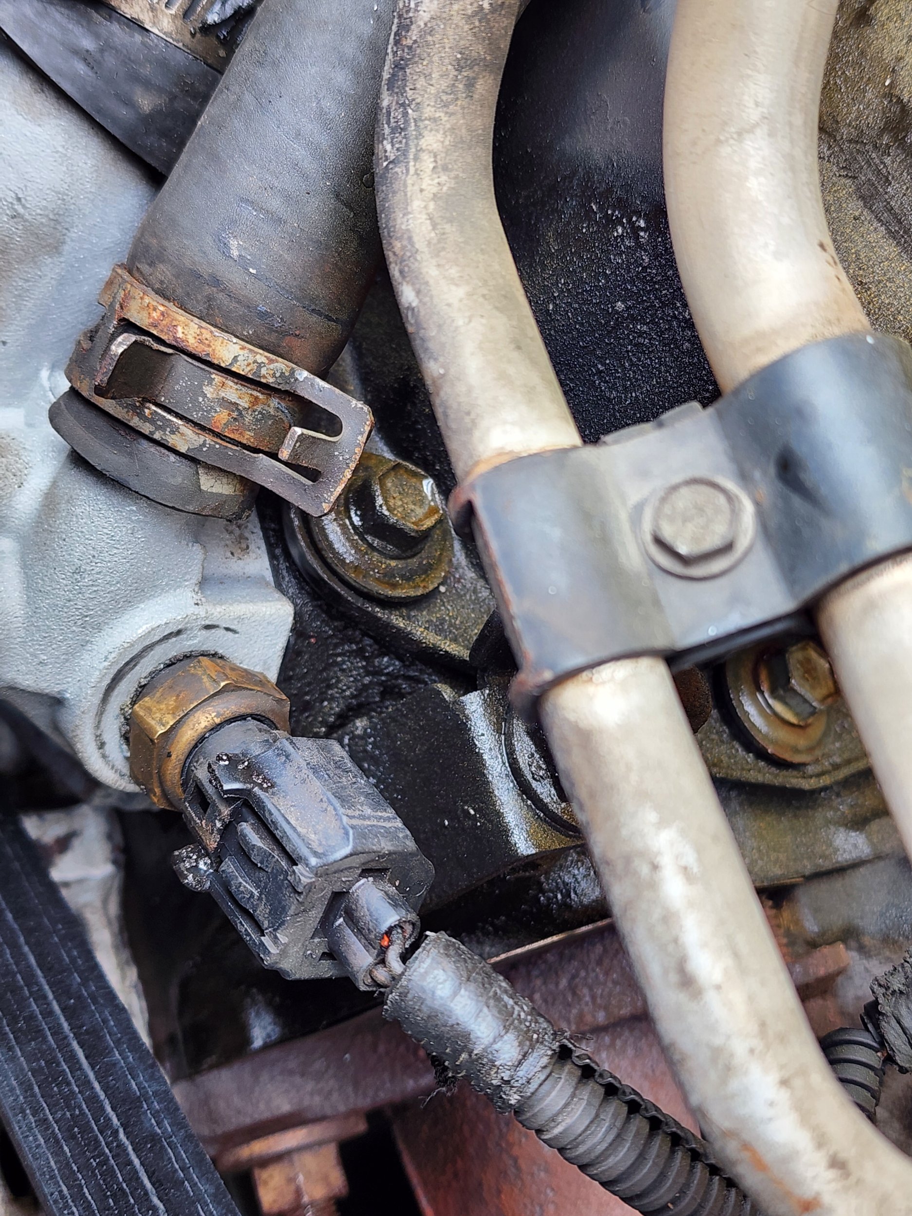

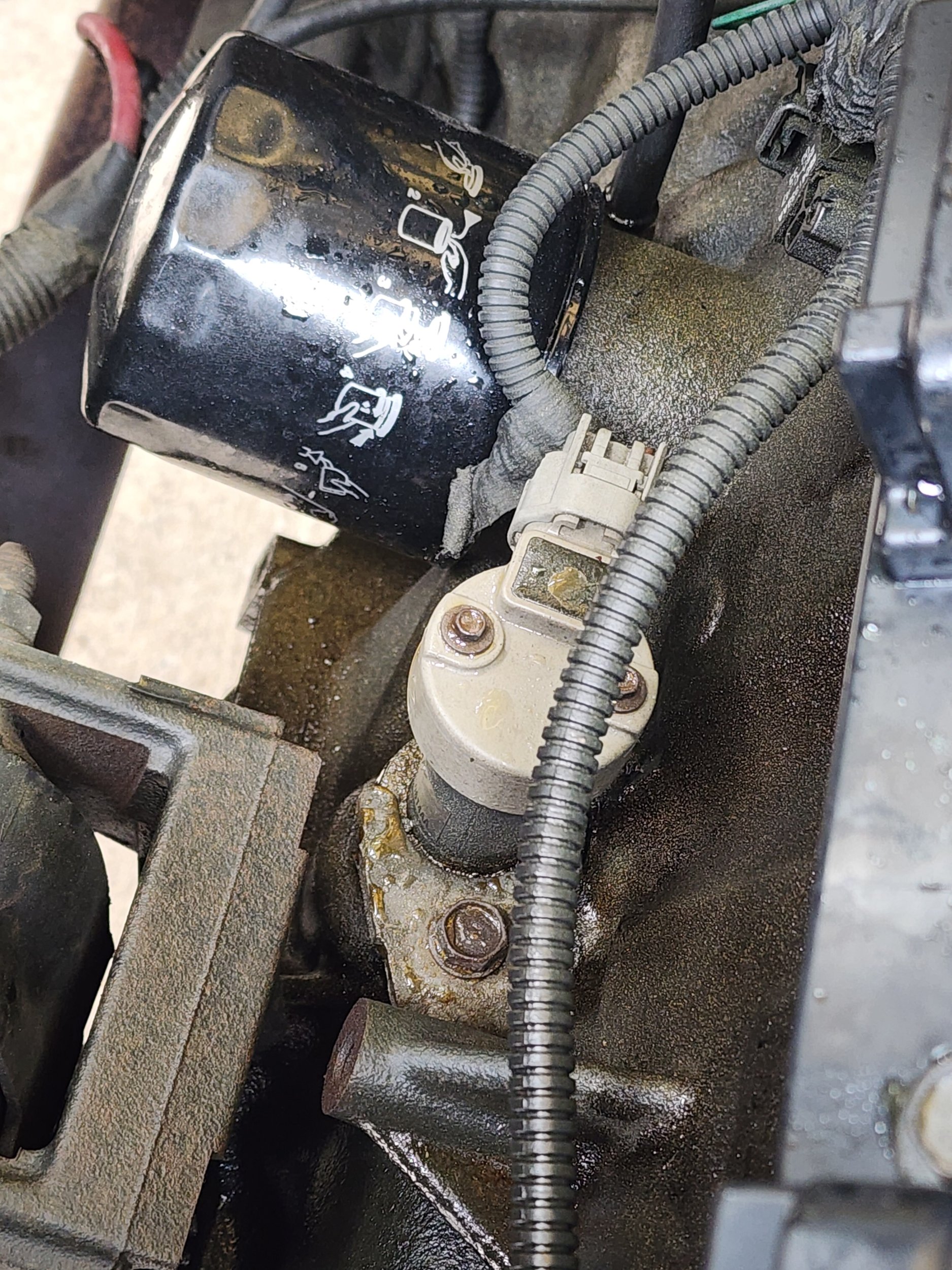

Drove it Friday (12/5) and it was bit hot, just a touch past the 210 midline, but I figured it probably needed to burp some air. Didn't drive it Saturday, went out today(12/7) to check the coolant level and saw that it looked like there was still spray in the same places, wet still even. See pictures for what I'm talking about. The only thing I can think of is a head gasket, but we changed the oil a month and a half ago(200ish miles) and it was fine so coolant isn't going into the oil. I can't really tell if it's oil or coolant, because the engine is generally greasy so touching it to feel didn't really work but the oil was so recently changed so it would be very thin and light like I'm seeing.

What am I missing? Should I scrub down the engine/bay real good and see what happens after I drive it a few days? This is my daily driver, but it gets very little mileage (5-6k/yr) because I have a motorcycle I ride quite often when the weather is good. I appreciate any advice y'all can offer! I want to keep this jeep long enough to teach my kids to drive stick on it, so I'm willing to invest in what it needs to keep it around that long.
