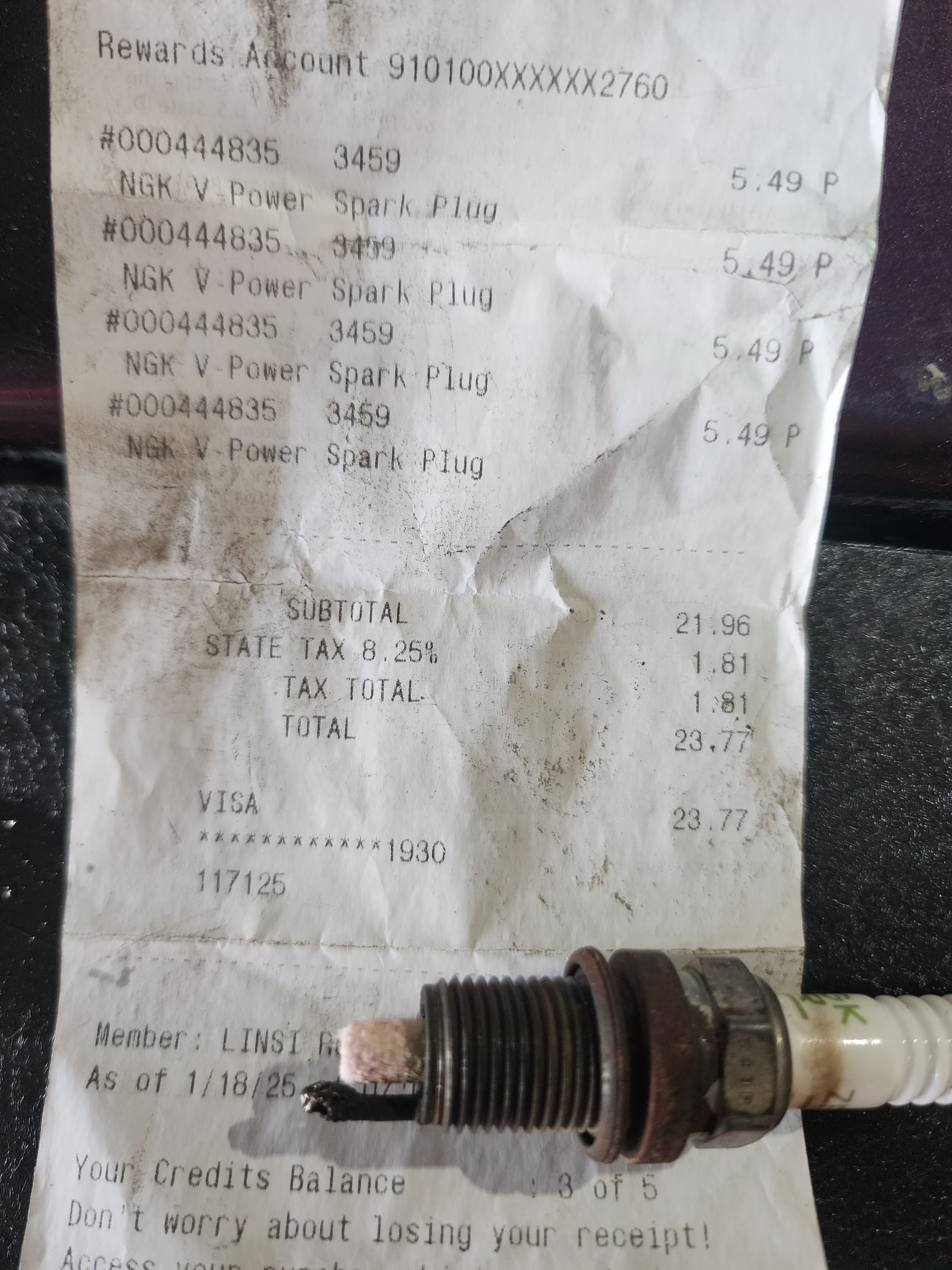

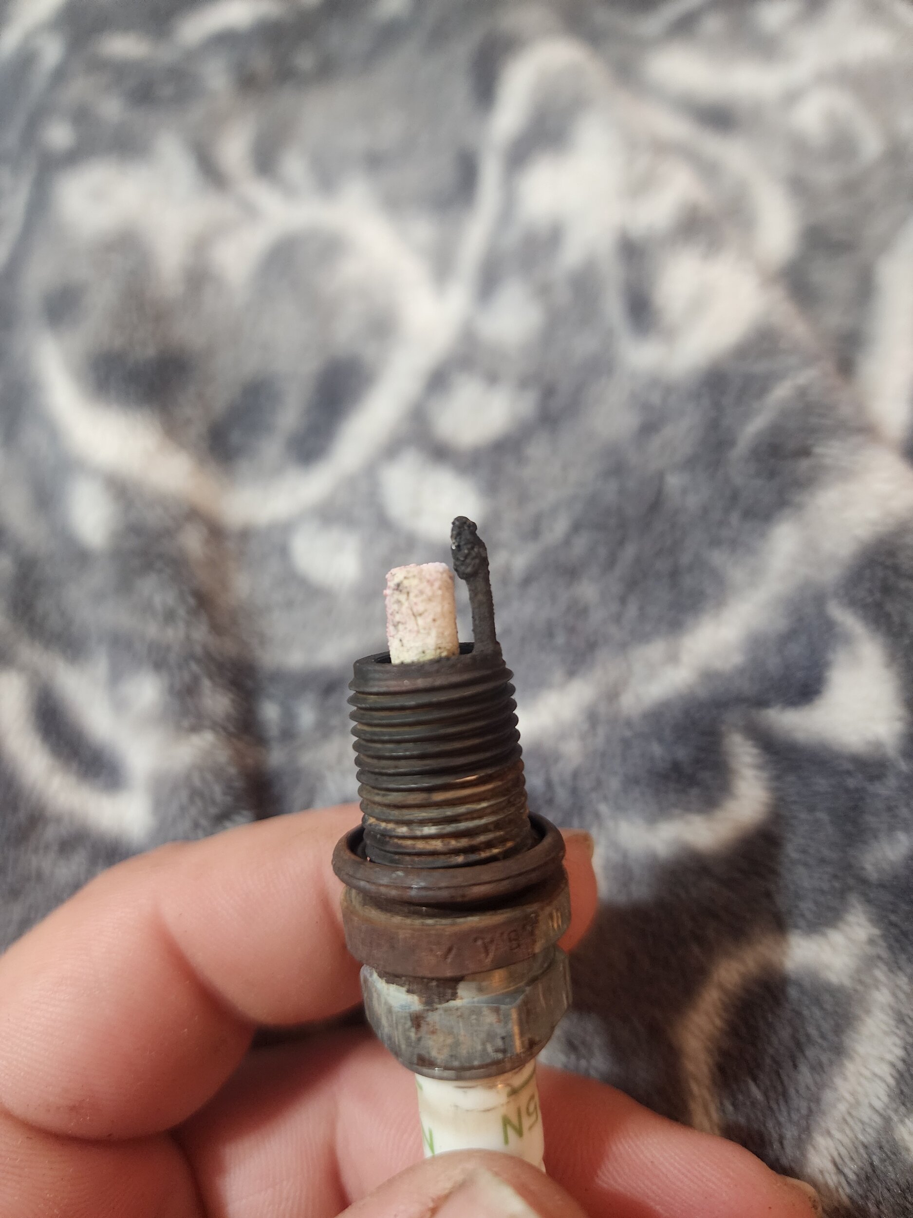

That plug looks like detonation killed it.

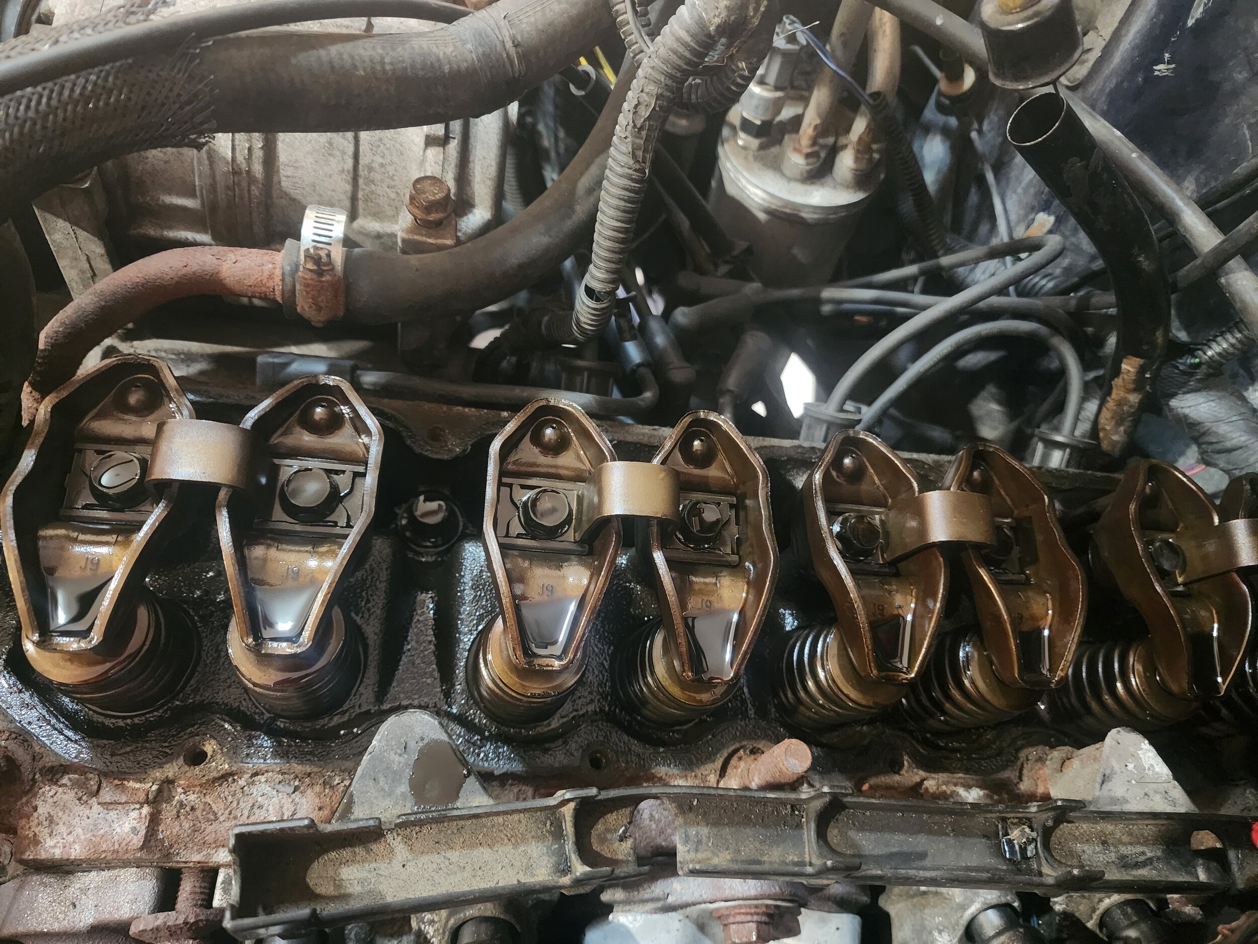

Okay, I can work with where this is going. It's more than I have right now because I don't know what caused a brand new plug to do that, but I have a misfire that I can't kill and I can't find. My Jeep thinks it's in cylinder two but that plug was pulled from cylinder one I have a obvious loss of power and questionable compression
Last time my gut told me the distributor was the issue, I spent $1500 and entirely too much time only to find out i should have listened to my gut. So, this time, my gut says the same thing. Why? Because this seems to have happened after changing the distributor. Granted, it took it a few days, but I didn't necessarily like way the installation went. I took it out and tried it over and over, following the procedure to a T. Now my distributor has play still, the bolt is tight, it doesn't sound out of time, but I don't believe in coincidence. So taking the detonation comment into account, and the distributor having just been changed and not seeming right, am I on to something here? What can I do to check that? Or just do it all over again til I have no doubts?

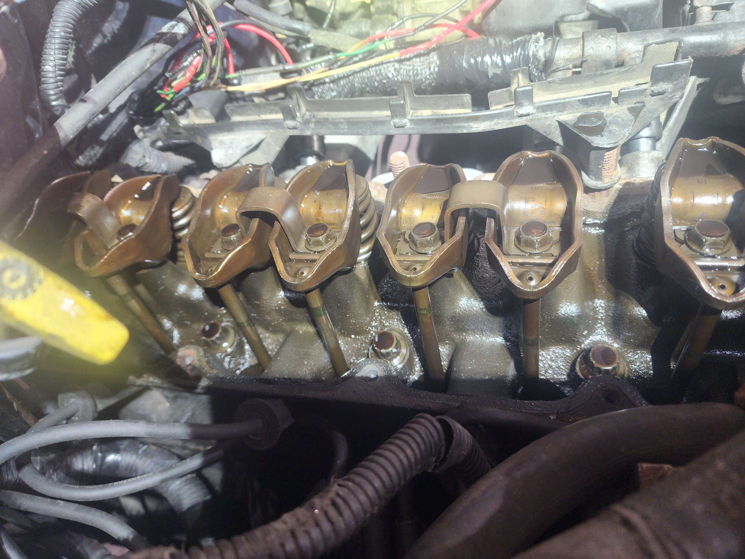

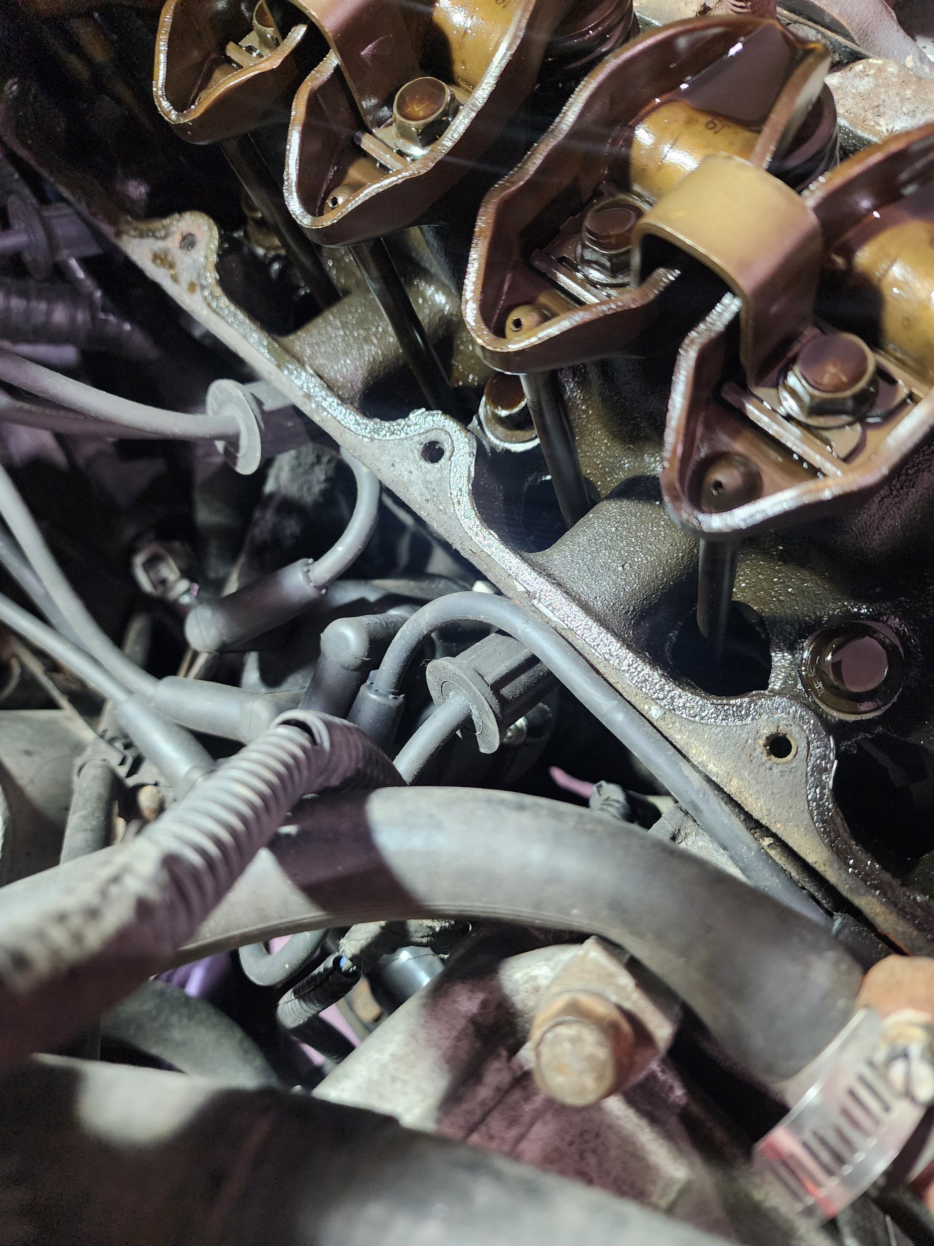

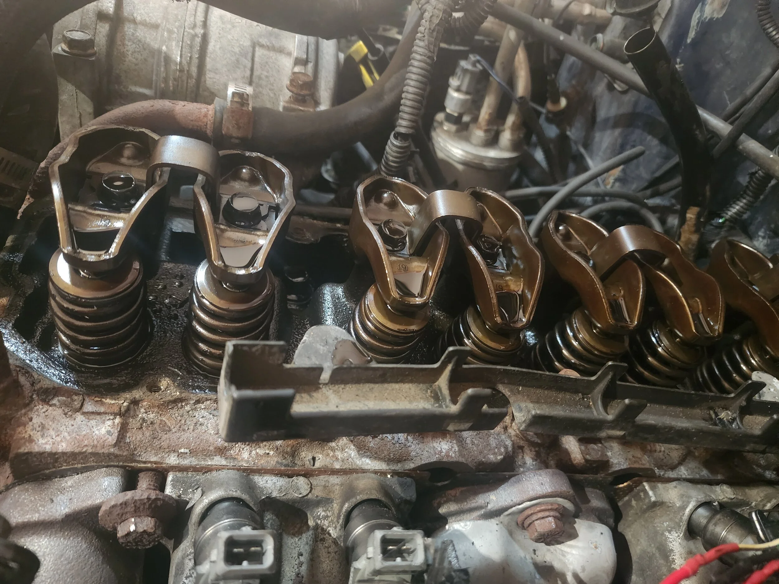

No, not rotational play, up and down play. And it's not much..not even enough to leak oil but seems off. I have it pulled right now. I have the motor at tdc on the compression stroke of cyclinder 1, but that's not where the rotor is lined up. It's off. It's in the middle of cyclinder 1 and 3. How do I fix that?
