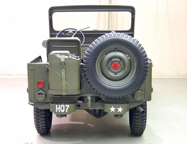

Is this the look your going for ? @StG58 (with the gas can sitting left of the spare wheel) I like the new school twist on the old willys. :thumbsup:

That's where I got the idea. Saw an old MB running a trail and thought I might be able to pull it off. There's just enough room with 31's.
