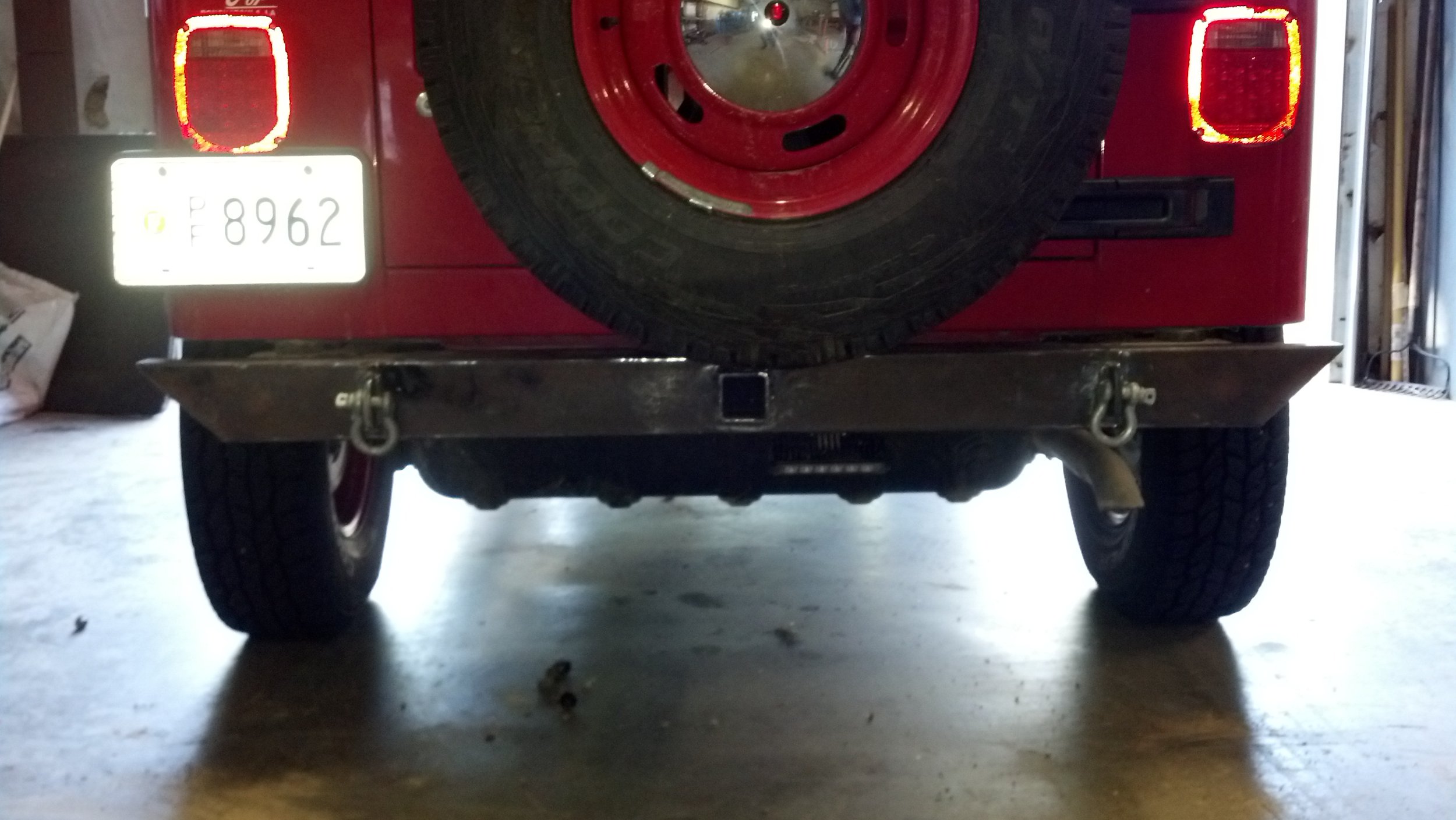

I went with a standard winch plate with the stock bumper . I did remove the end caps .
We custom built the rear bumper , but you can purchase one pretty much just like it .
I'm running approximately 2 inches of suspension lift with 2 inch bump-stops . Tires are 33 inches tall and 10.3 inches wide . Works just fine for our wheeling . I did re gear to 4.88 gears , which helps a lot with the automatic transmission .
