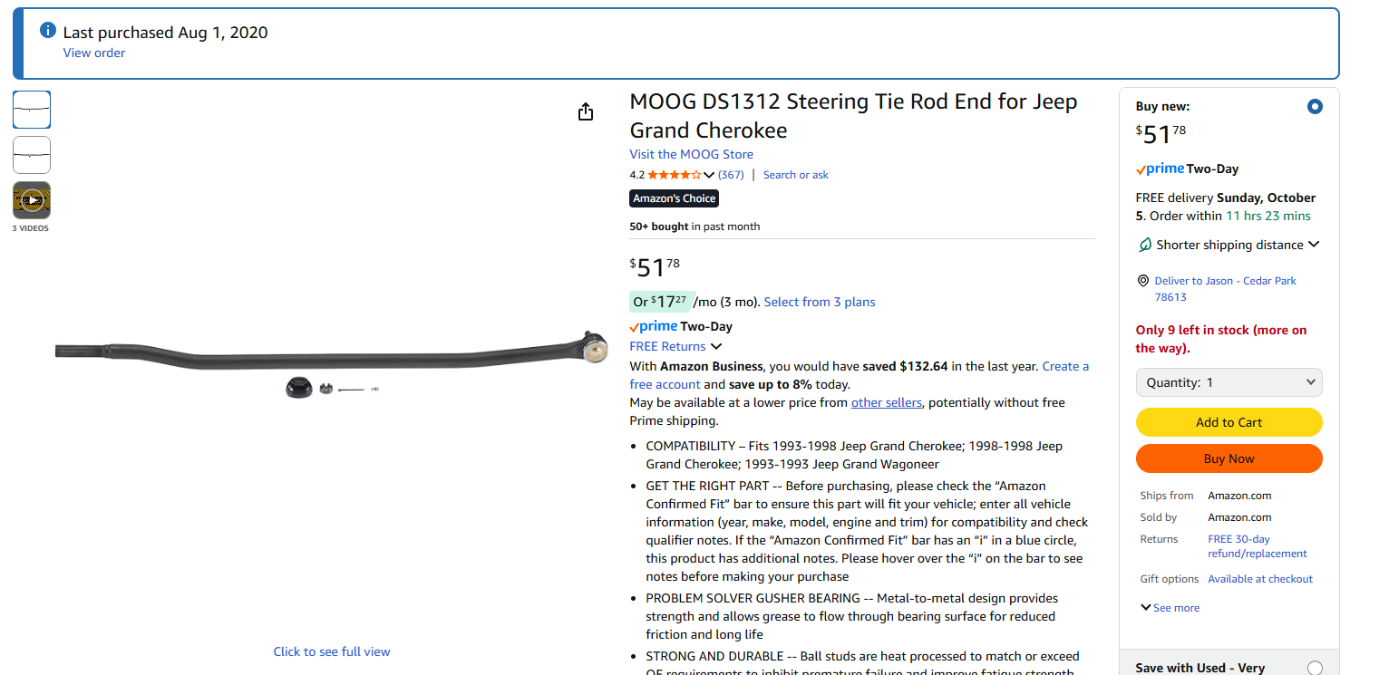

So, unless others can chime in, I'm going to disagree here. I put the ZJ conversion on my TJ.
https://wranglertjforum.com/threads/zj-tie-rod-conversion.2373/ Here is the How To that @Chris has up on that section.
My experience with it, but granted I did have a lift, but I'm very confident that doesn't matter.

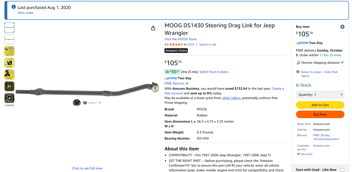

1. The drag link size and weight beefiness is zero difference. The TJ and ZJ drag links were just same. It was worth the purchase, because it refreshed the joints, but after reading Chris' information etc, getting the TJ Wrangler Drag link replacement was what I did, the ZJ is not any beefier.

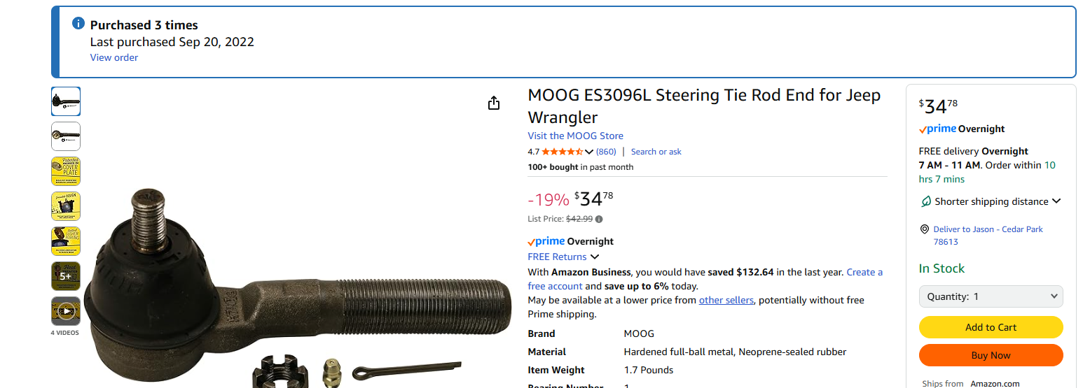

2. The ZJ Tie rod bolts right in, no mods, BUT, it is much beefier. Solid, and I believe the OEM TJ tie rod is hollow, and threads on each end to a Tie Rod End. The ZJ uses an adjuster sleeve that threads on the solid tie rod. The ZJ Tie Rod is actually what makes it worth doing, along with the refreshing all the components.
3. Mine I think was all Moog, I got it off Amazon.
This is the Drag Link ZJ,
https://www.amazon.com/dp/B000C5406S?tag=wranglerorg-20
This is the "Tie Rod End" they call it, but it's the whole bar:
https://www.amazon.com/dp/B000C5400E?tag=wranglerorg-20
Then you need I believe 2 TREs
https://www.amazon.com/dp/B000C59W7U?tag=wranglerorg-20

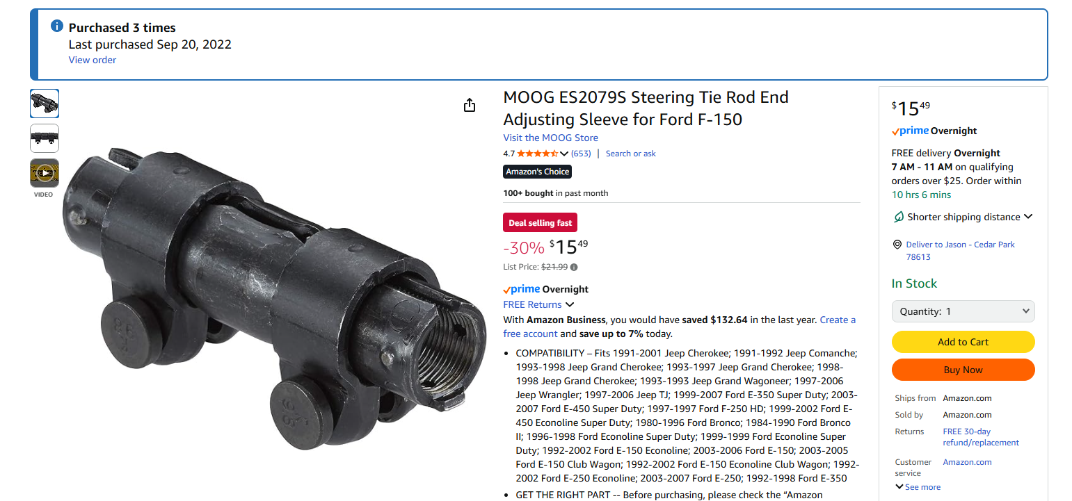

Then needed 2 of these adjusters, says I purchased 3 of these and the TREs, not sure why, I think I accidentally got 1 extra?
https://www.amazon.com/dp/B000C57VBY?tag=wranglerorg-20

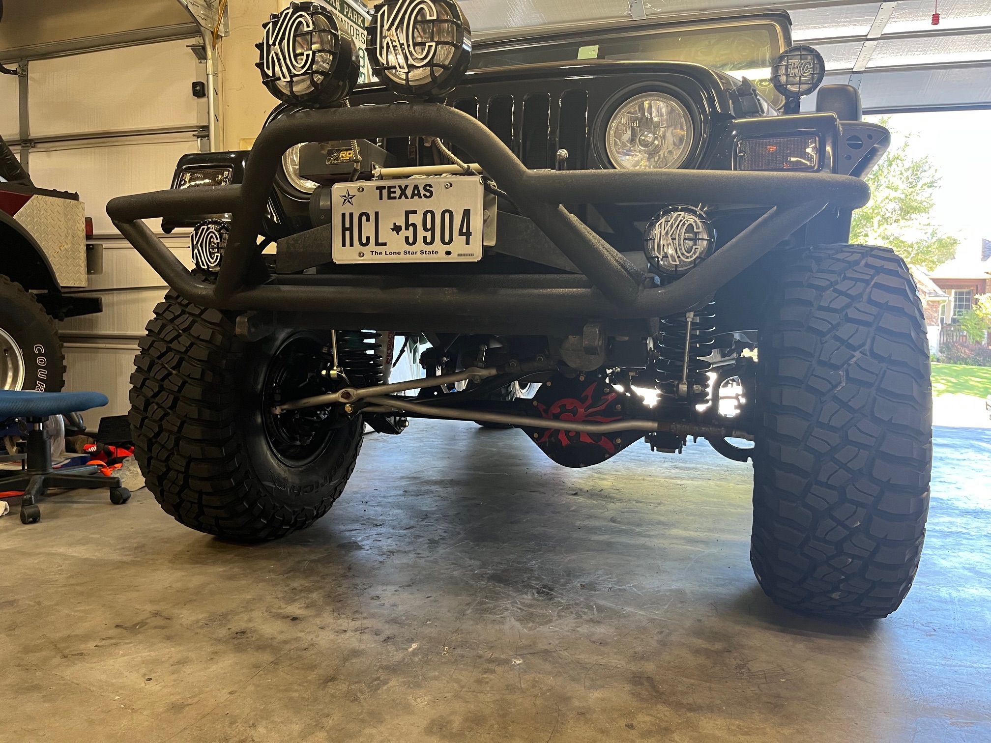

This is my TJ in 2020 I think when I got this, they don't have paint (Cheap ass) so I painted it all with silver, I had silver paint for some reason and I had put on aluminum Savvy Control arms that look silver ish, ha.
Here is a pic I found of it on:
I have since gone to the Currie Curreclync steering, here is a pic of that:

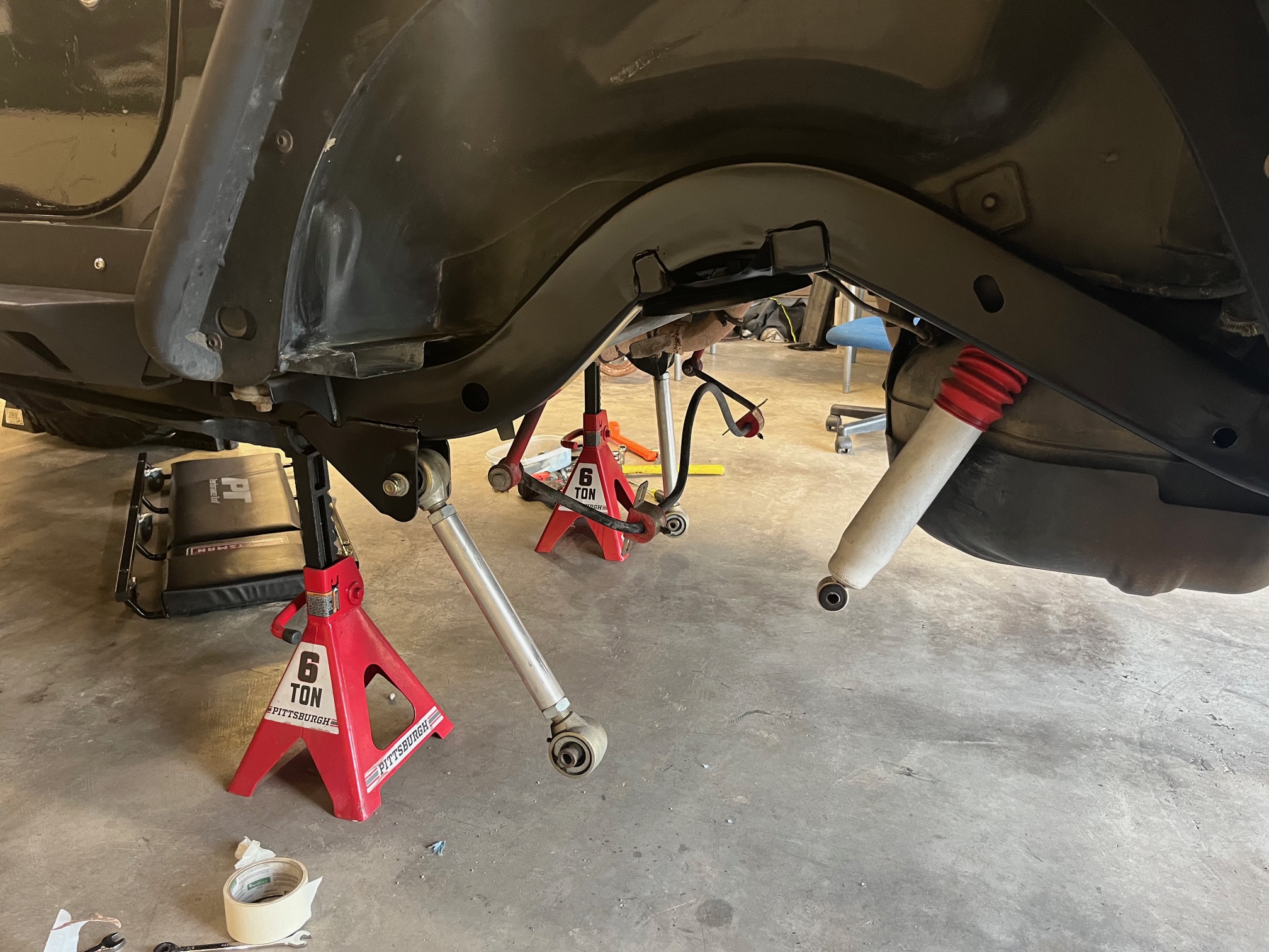

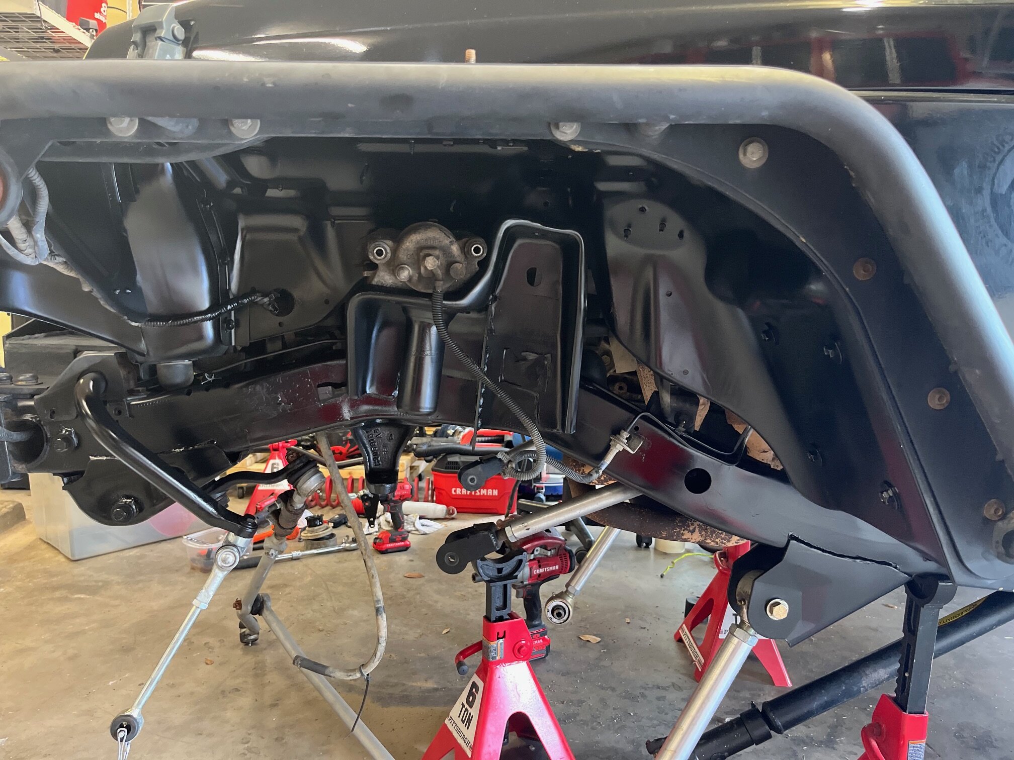

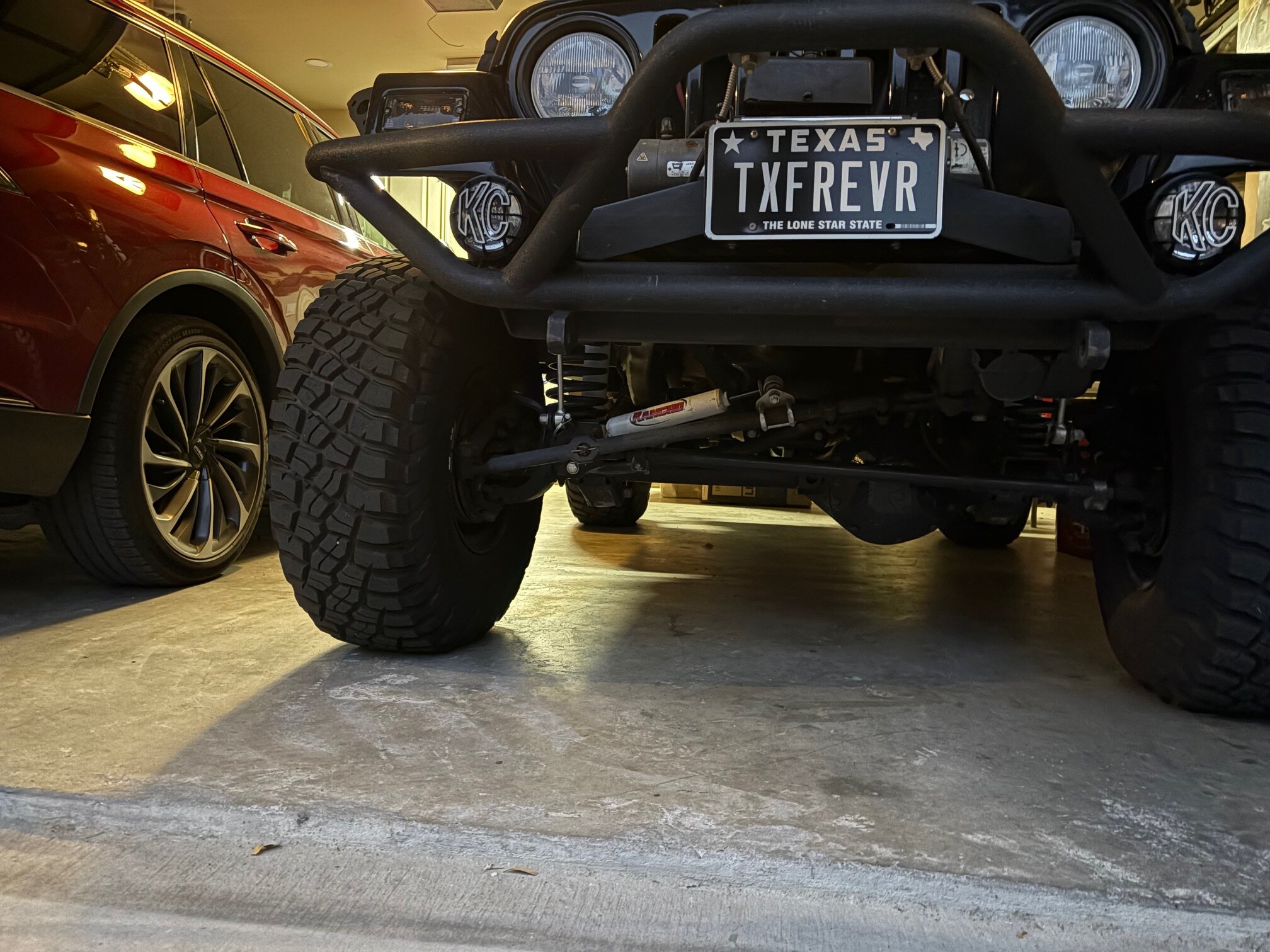

View attachment 646761View attachment 646762
Lucky for me the shocks are new so the bolts that hold them in are clean AF. Should come out fairly easy (if I didn’t just jinx myself) and if they're stuck I have a Dewalt ugga dugga that stripped the threads off my rusted ubolts on my Tundra when I first got it.
Also your frame is a masterpiece.
