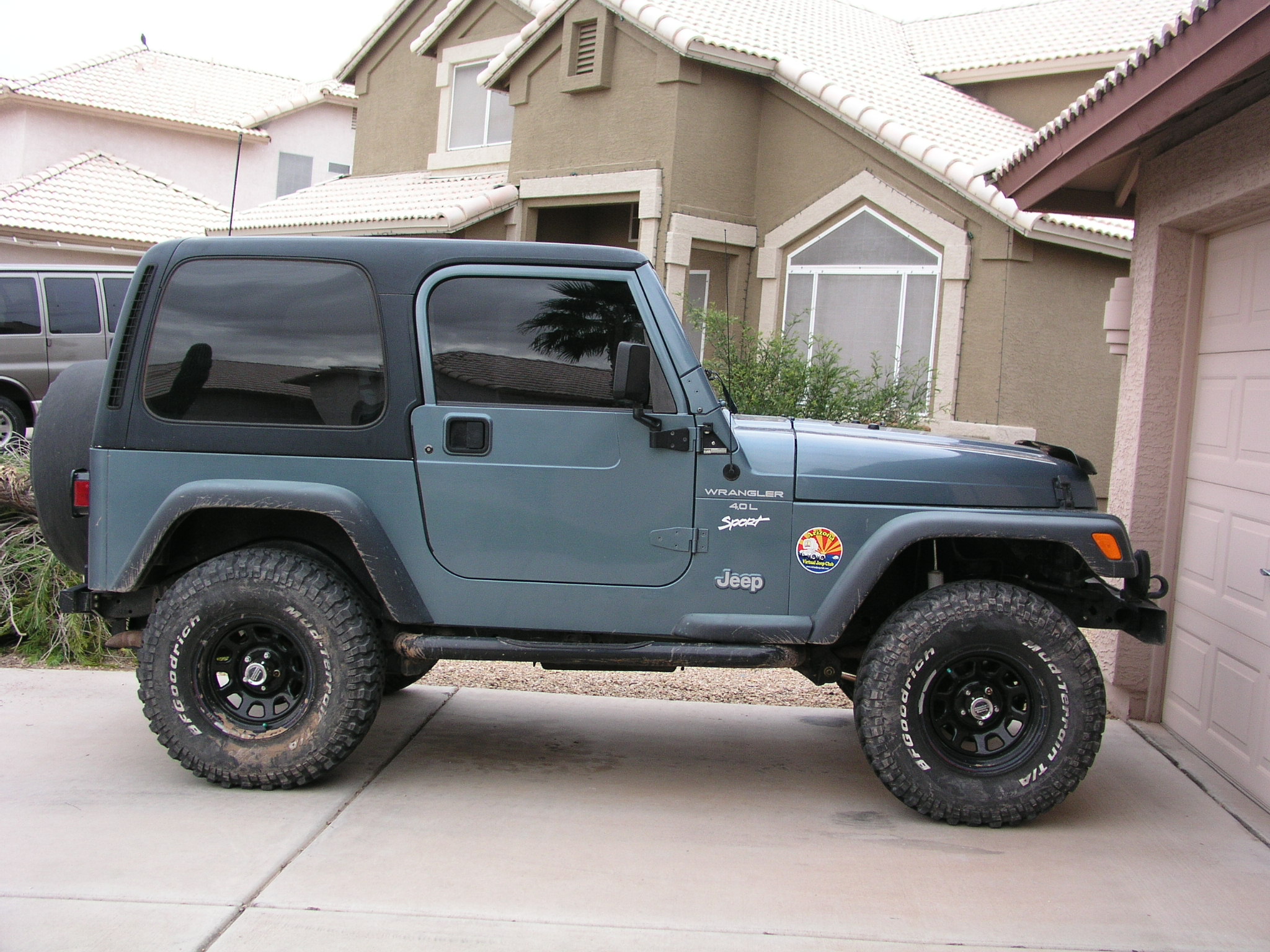

Here's 31's with a 2 inch lift for reference.
