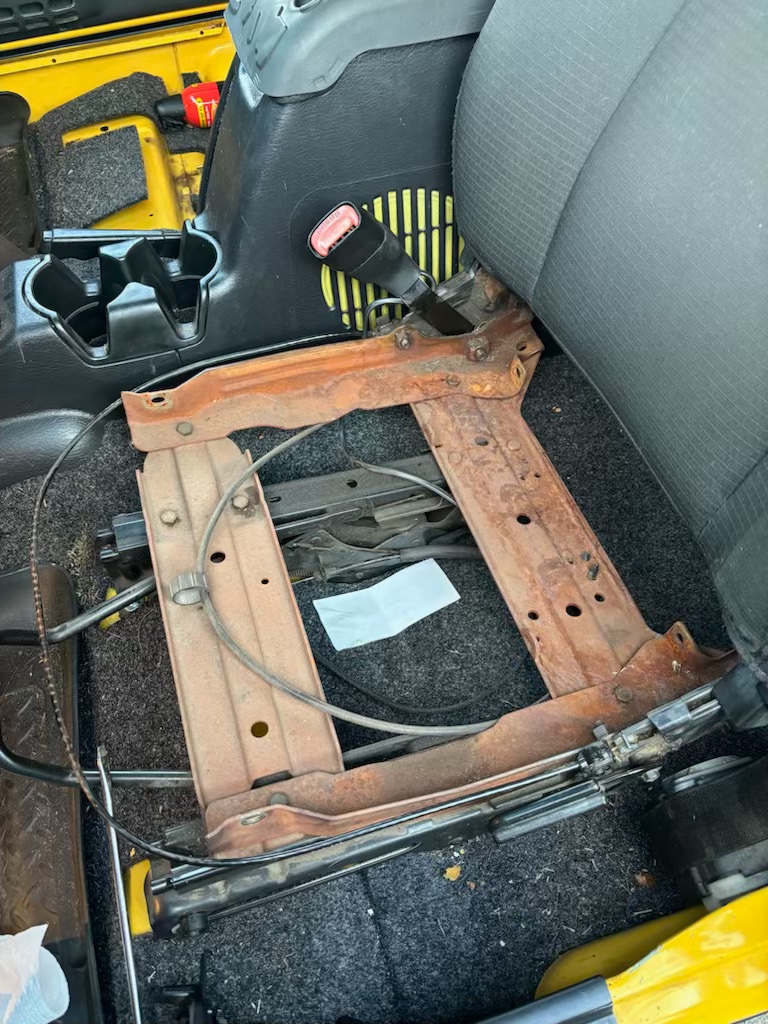

Found out the platform
of the seat will remove from the base- 4 -13mm bolts and game on-
It does make installing the covers a lot easier- and more precise-You don’t have to handle the heavy seat or deal with the back upper being in the way

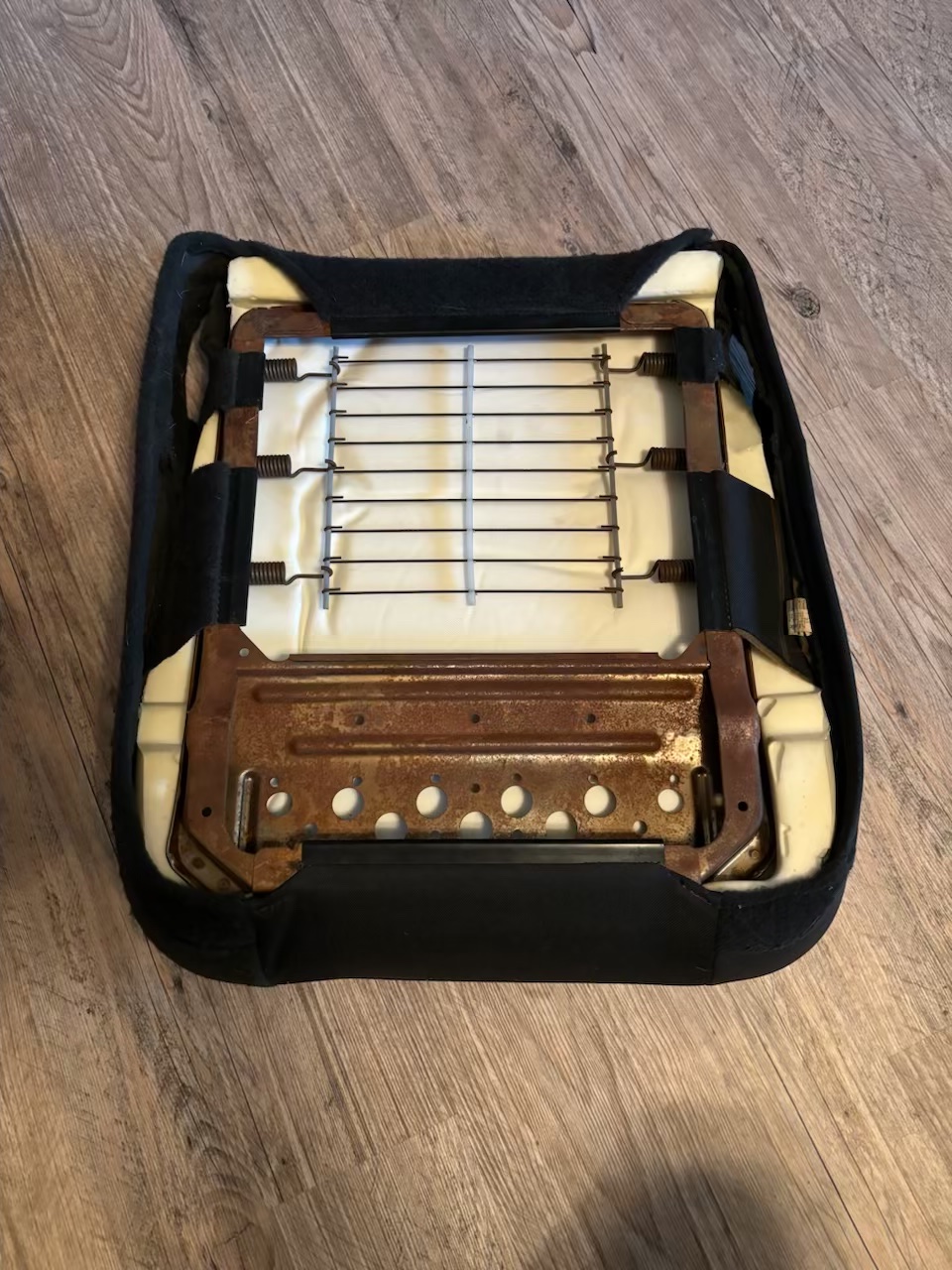

did you remove it from the seat frame while it was still bolted down in the jeep or is it just inside for the picture ???
Yes- My buddy Dave showed me that trick- base stayed in

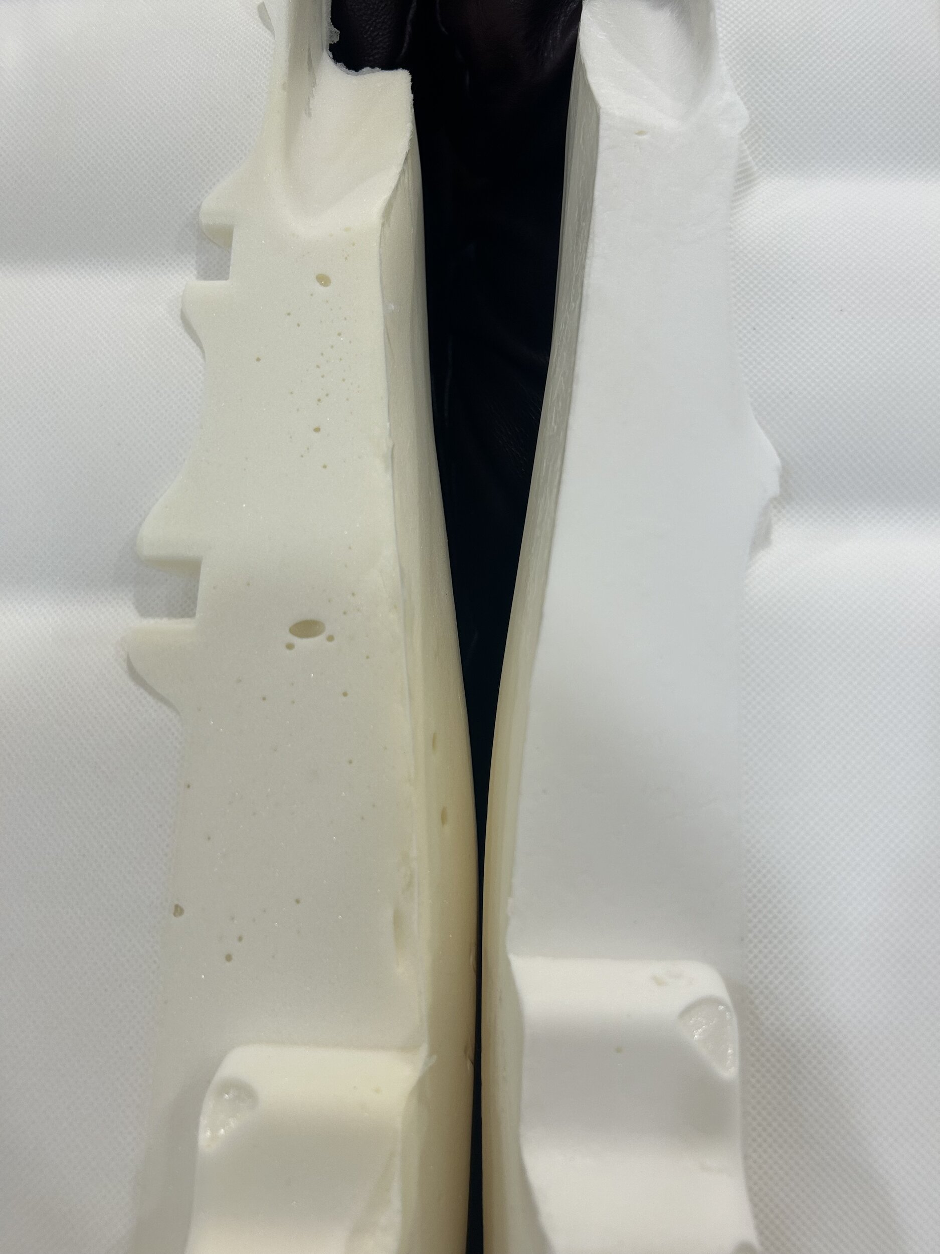

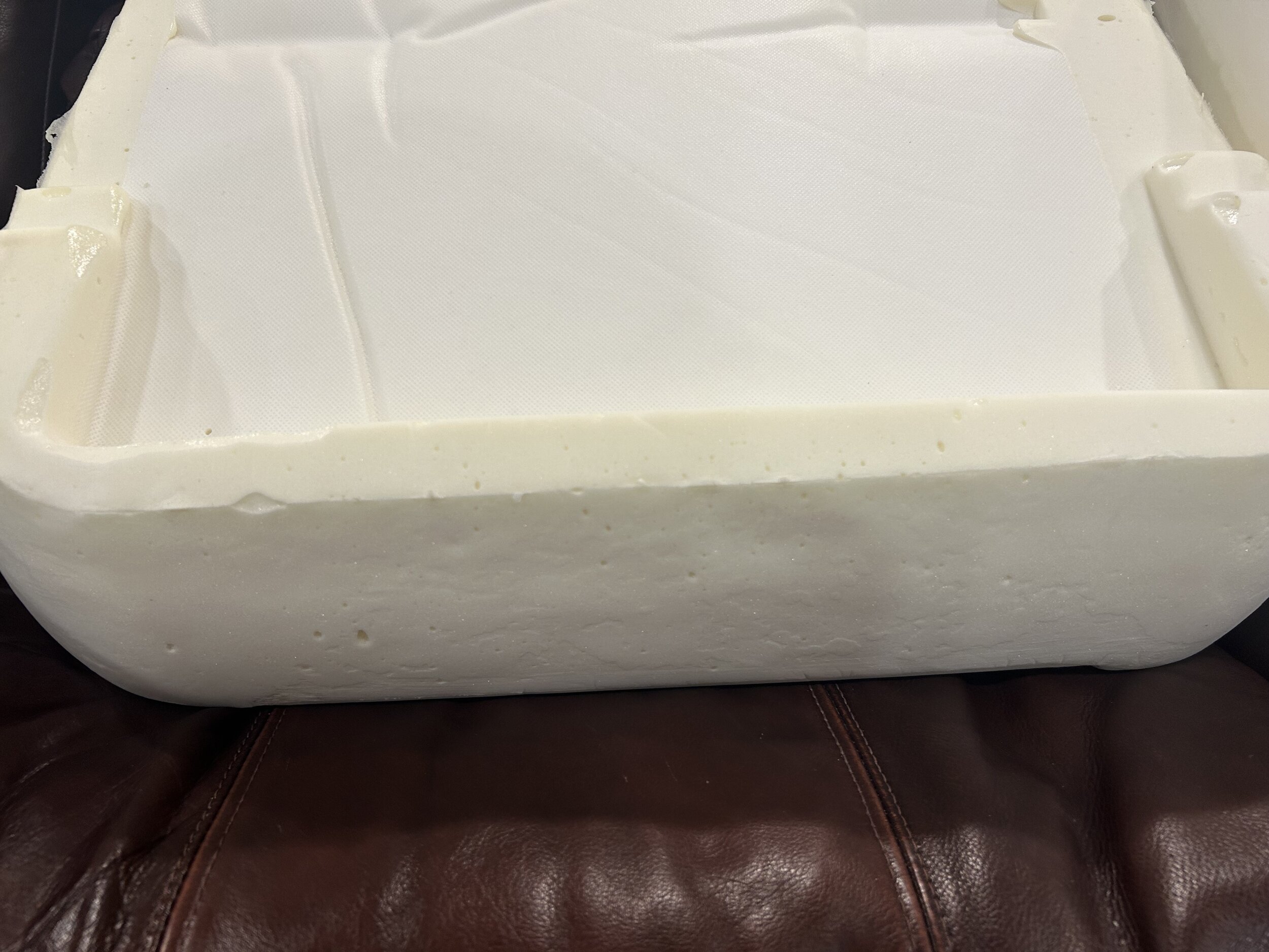

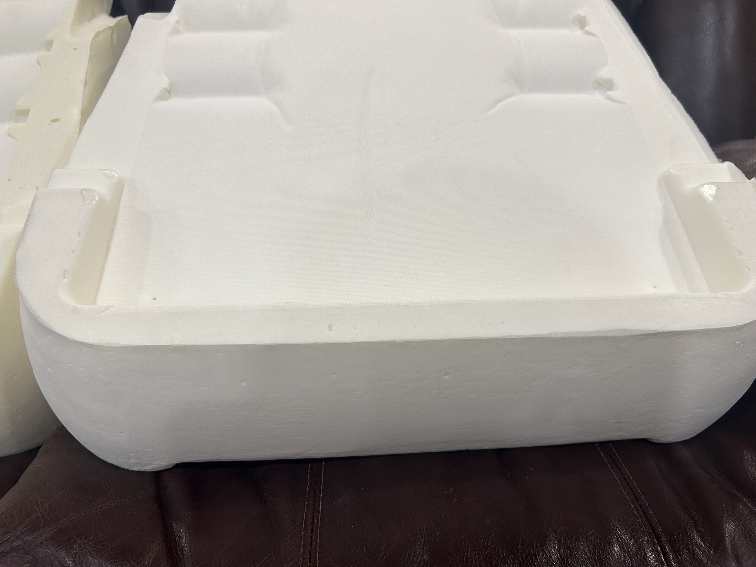

Anyone else get a defective foam? The one on the left is like a Swiss cheese. Very porous, more yellow and glittery and noticeably less firm than the other. I may have to return it.
