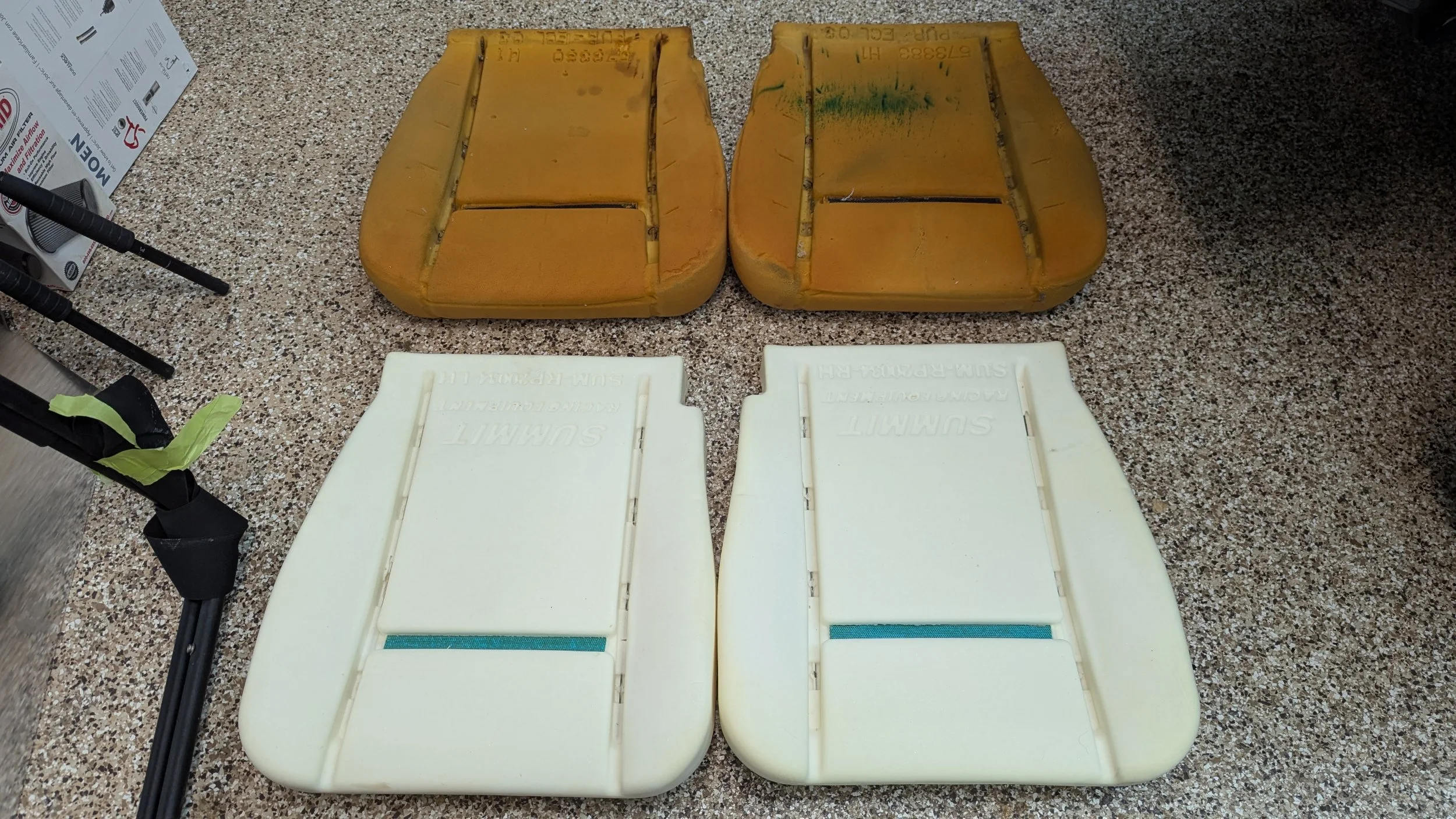

I removed the old foam last night. Placed it on a chair and the wife and I both sat on them. The old Foam you could feel anything under it. The new foam being more dense had some support. About an inch. That would explain why everyone sits up more after installation. The wife said it was the difference in a hotel bed and a nice bed. The new foam as much more support. I hand washed all the fabric and I am letting it dry. I'll assemble everything tonight and hopefully have a chance to try it out in the Jeep.
I'm in full support of this product. I took a few days to install as I washed the fabric while it was off and let it air dry.
I still have a .5" riser but the seat foam is MUCH better than the old. I haven't found my new seat position as this changed everything, but it's such a better ride. Even the vibrations from the Savvy skid are less noticeable as the seats no longer on my tail bone. Thank you Andy and everyone that recommended this product.

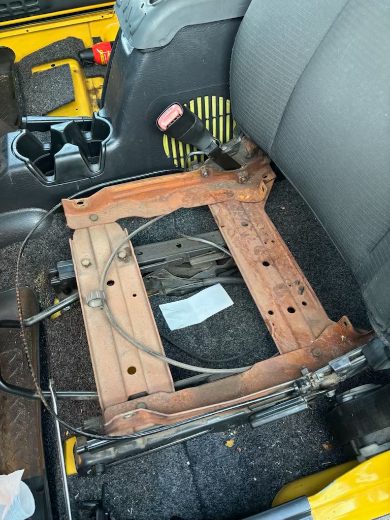

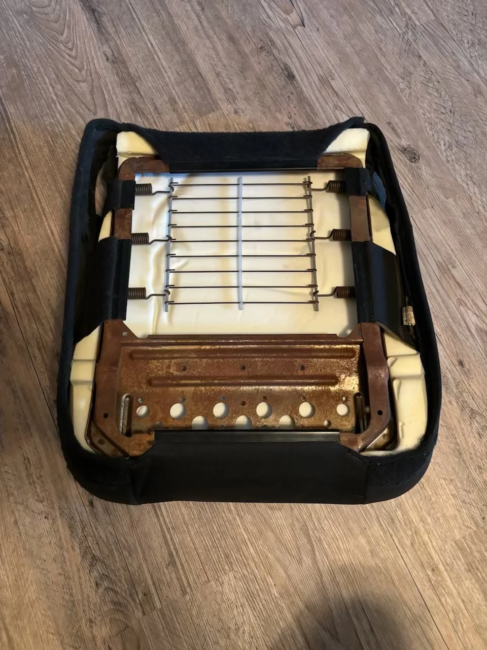

Found out the platform
of the seat will remove from the base- 4 -13mm bolts and game on-
It does make installing the covers a lot easier- and more precise-You don’t have to handle the heavy seat or deal with the back upper being in the way
