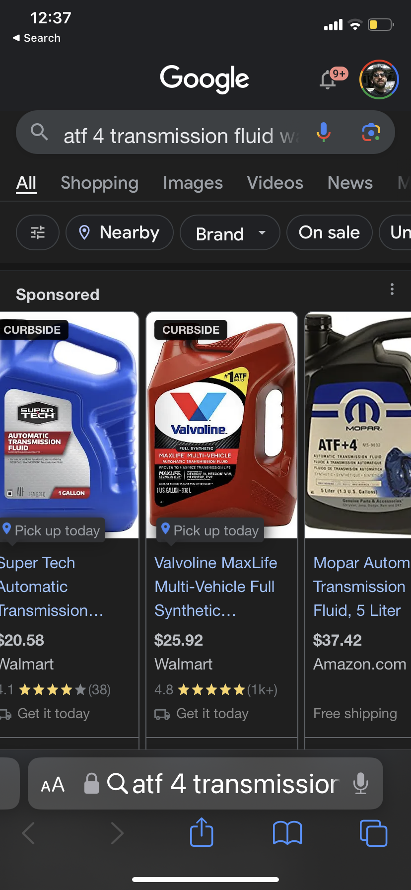

@mrblaine I can save a lot of $ if I use Walmart brand. Is this still your move on the ATF+4?
The bottle in your screenshot of Supertech (Walmart) is DEXRON-III and Mercon equivalent. You need ATF+4.
X2. If it doesn't say ATF+4 in big letters on the front of the bottle it's the wrong stuff. I don't care if in small letters somewhere on its back label it says "compatible with ATF4". That doesn't mean it is ATF+4 which is the only correct type for our Jeep automatics.
