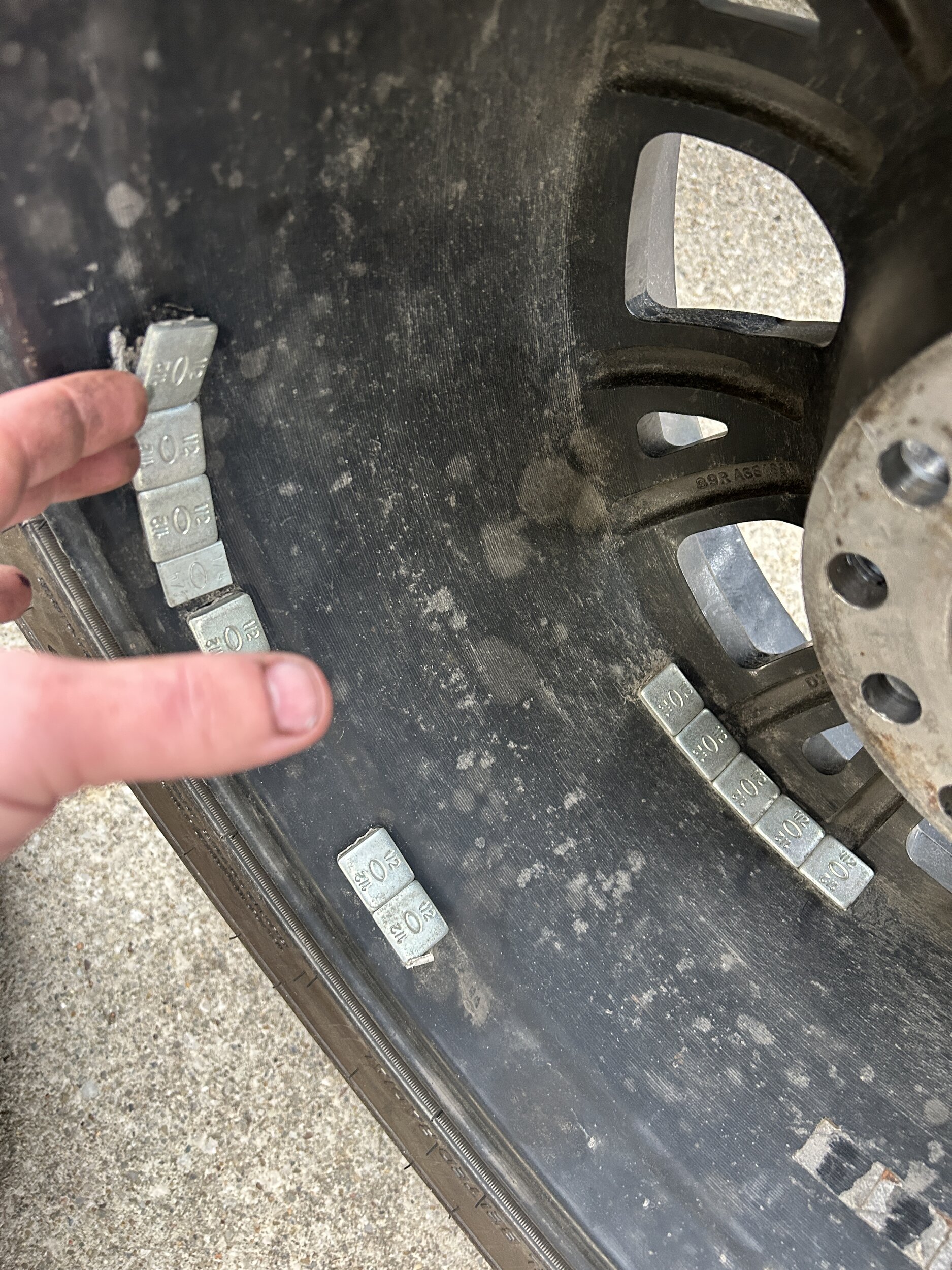

I had 8-10" of those fall off in my garage, they didn't clean the surface first before sticking them onto the wheel.
Exactly, they didn't clean off the wheels properly. Even though I trust my tire shop entirely, I still remove the wheels and scrub them clean them before I drive to the tire shop. That way I know they are pretty clean.

Put a little RTV on that weight and keep going.
