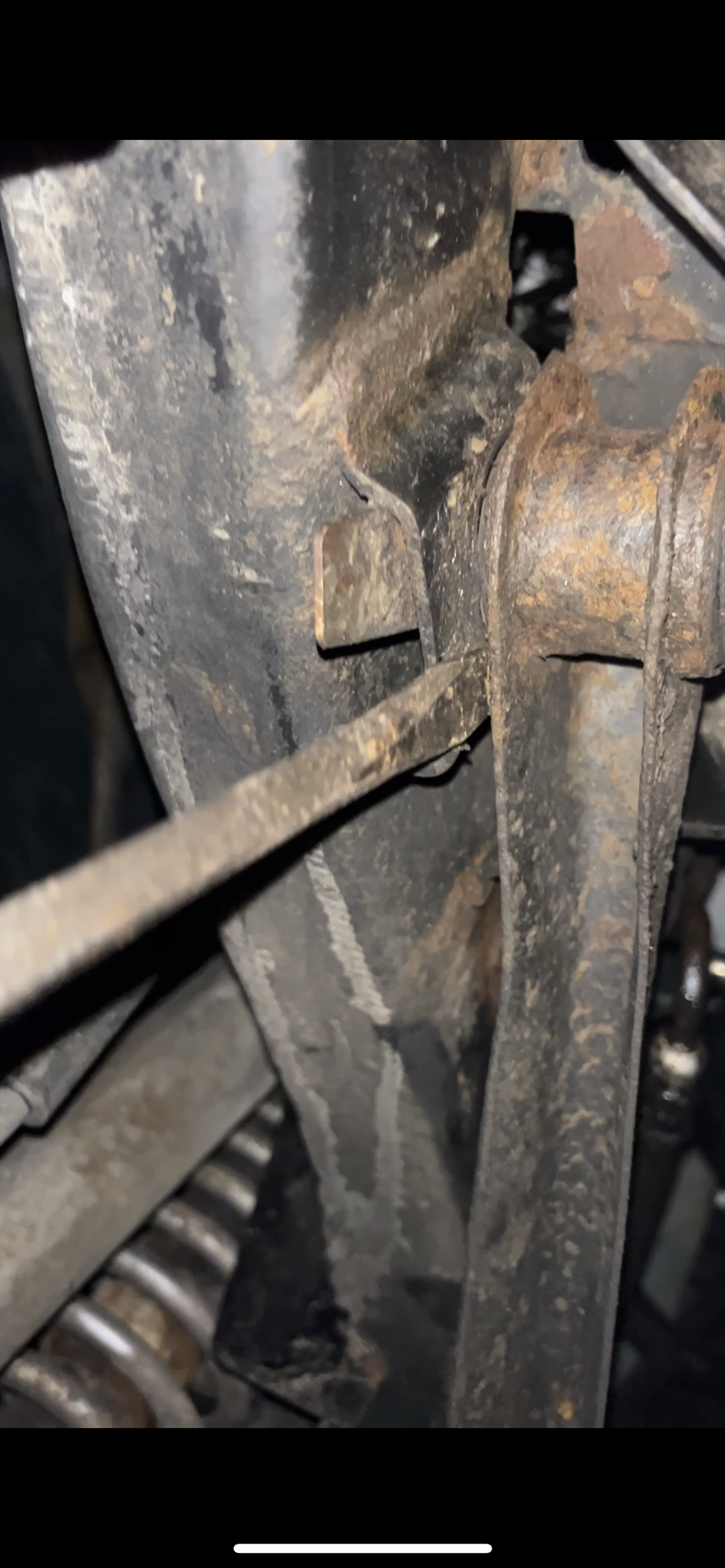

Still having death wobble issues
Can’t say with no visual-
First tighten the bolts- don’t just throw parts at it.
Don’t go crazy with the wrench, the upper front stock bolts aren’t that big-
But they have to be properly torqued.
If they are clevites, the rubber may be so far gone it doesn’t matter.

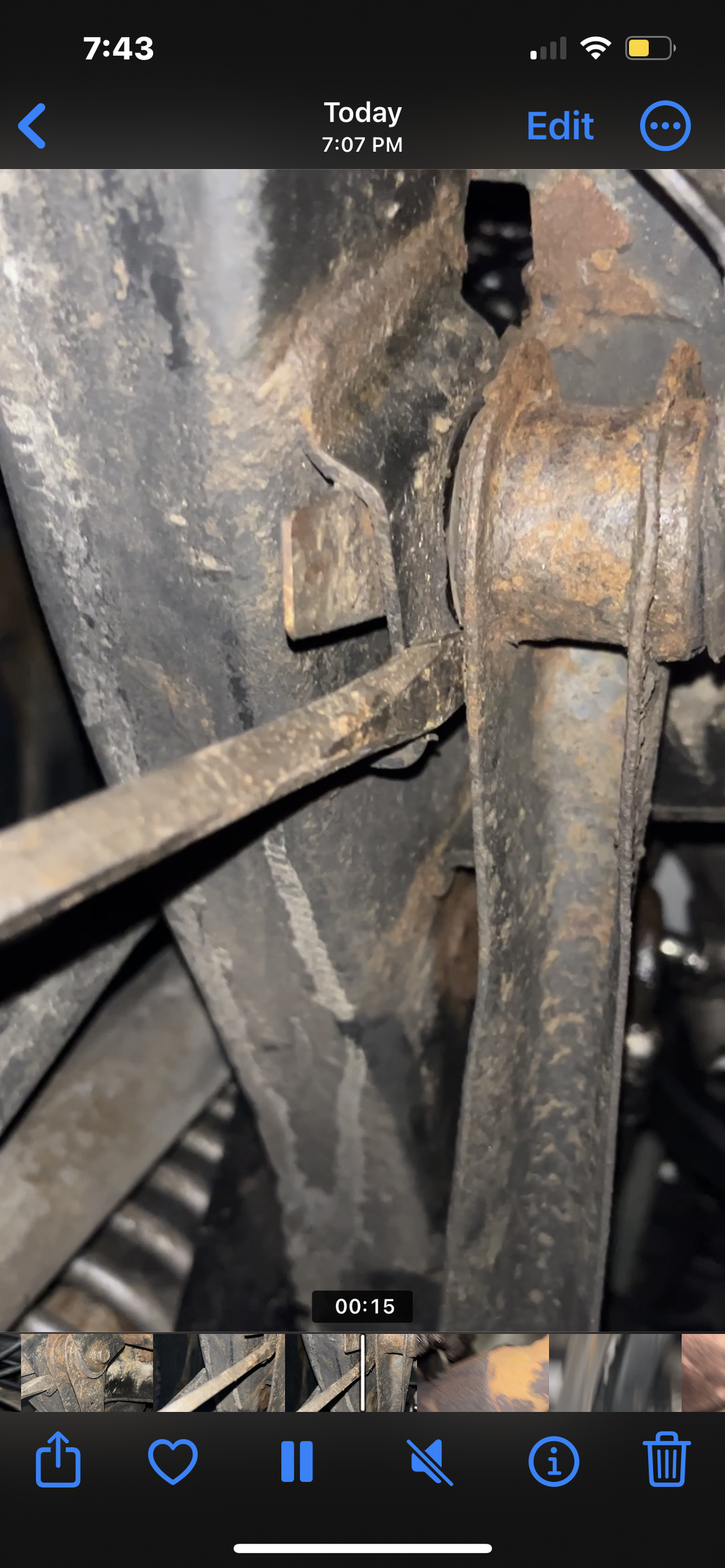

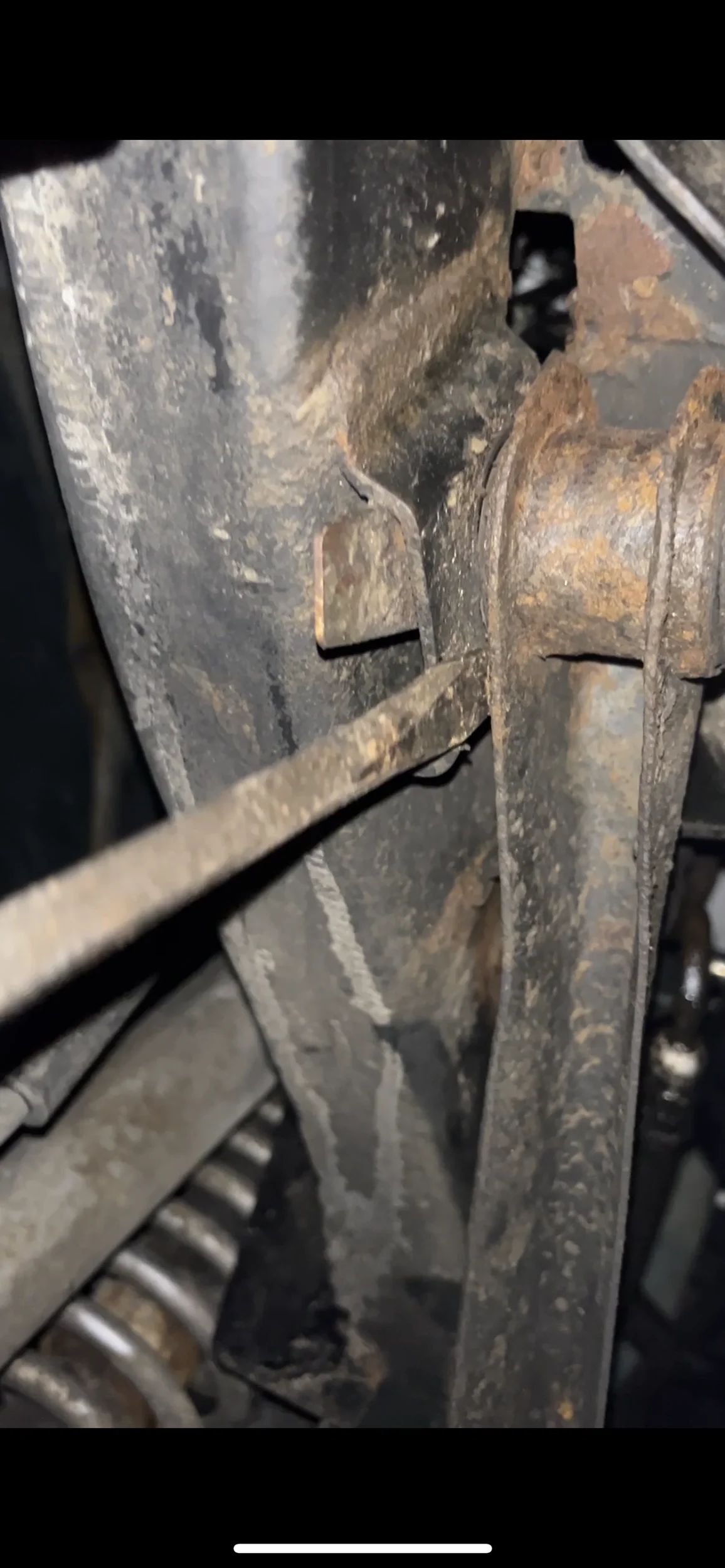

They’re all still torqued. I can’t send videos but I’ll try and show with pictures.
On top of all this sadly most people are ignoring the two most important bushings aside from the track bar and that is the upper front control arm bushings and the mount on the passenger side- I don’t know how many of these I see that have 14 new control arm bushings and the upper front or 20+ years old and when they hit a hard bump they are starting to get death wobble.
