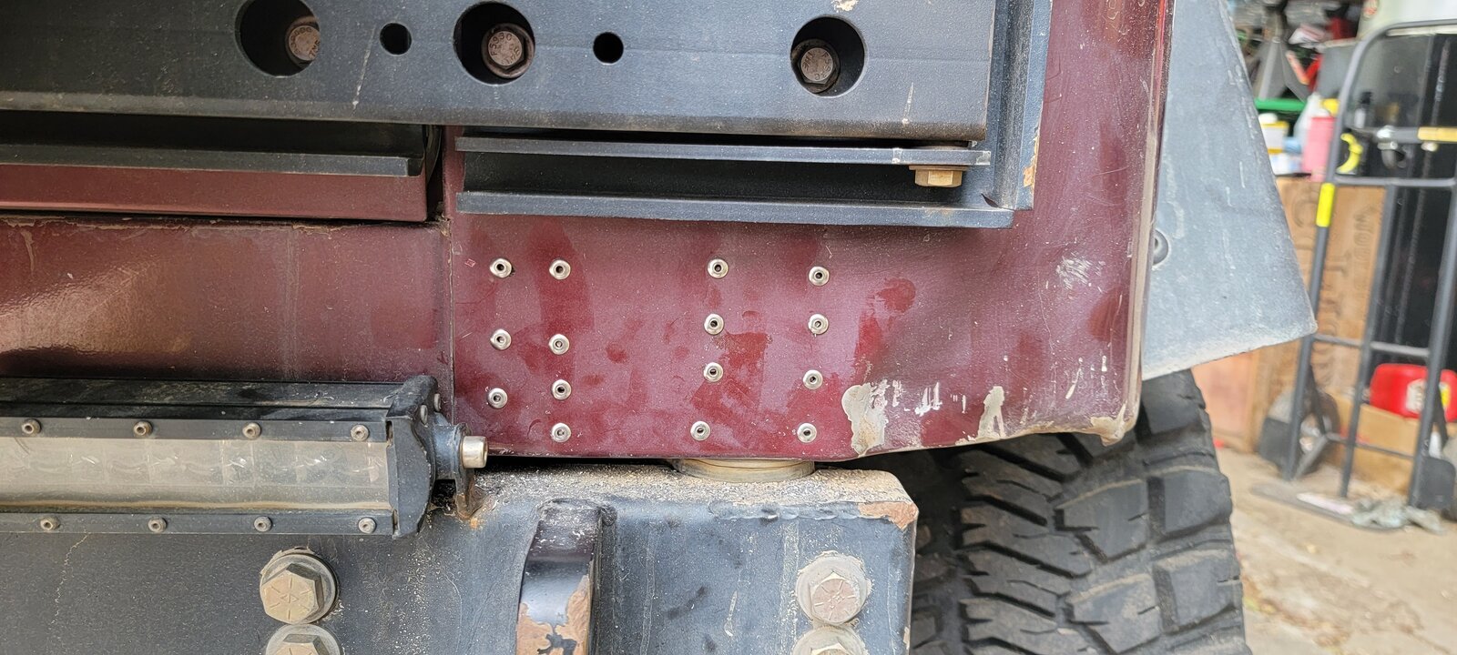

The problem is that the left side is only supported by the latch pin. The bouncing tire can eventually tear the passenger side corner of the tub off of the spot welds holding it to the rear torque box and body mounts.

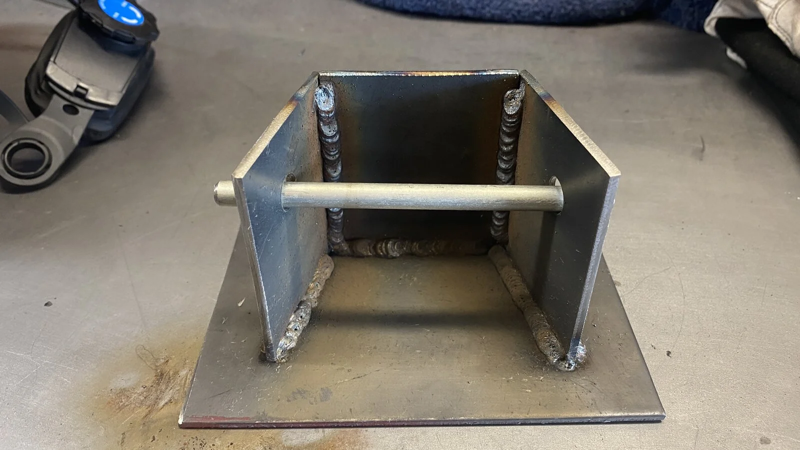

It’s not totally perfected. I need to do two things. 1) add cletes to the strap, 2) use a larger diameter threaded rod. At that point it will be solid. The cletes are the main thing. As long as they are On the tire and can’t slide off you are good to go. The bracket isn’t dealing with many forces. It’s main job is to keep it steady left to right. I wheeled all day at Reiter ORV in WA state and it was solid as is. That’s a tough spot to wheel.
Nothing to add but a childish "spelling bee" contest. Noted that you did not dispute that your tire is in fact NOT resting on that homemade bracket which makes it a near useless addition.
