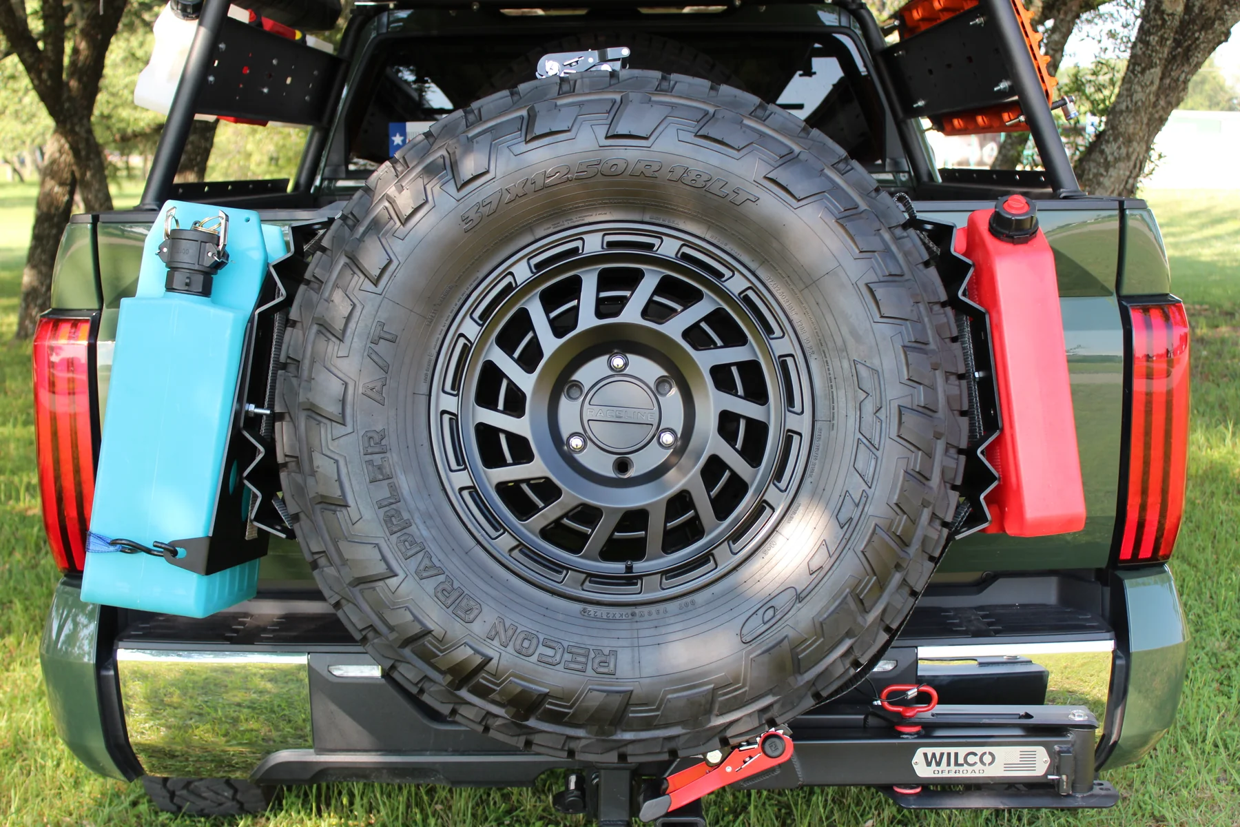

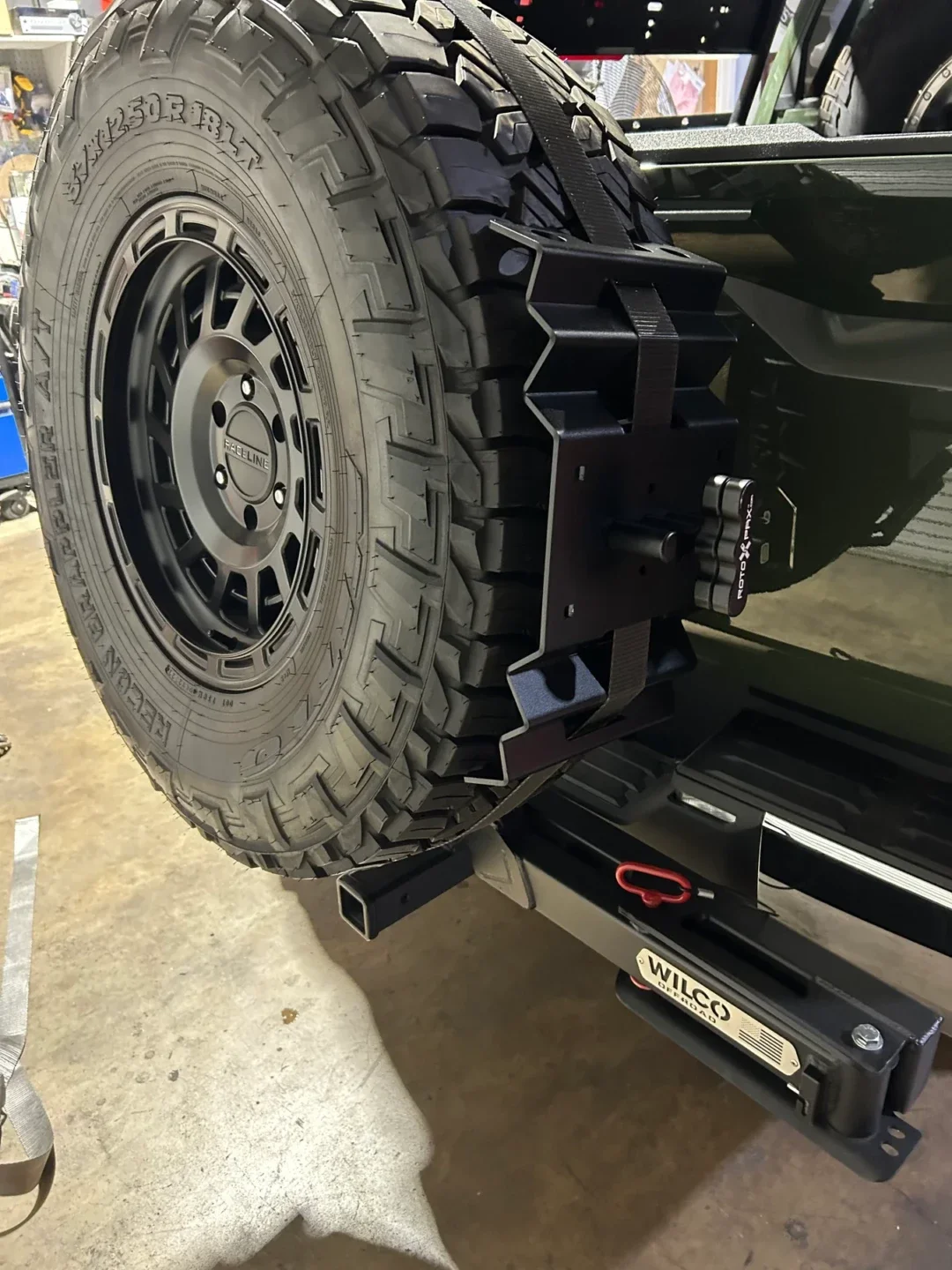

The TireBite Mounting Kit from Wilco Offroad is similar in concept, MSRP $159:
https://wilcooffroad.com/collections/tire-carriers/products/tirebite-mounting-kit
From the product description:
". . . keep in mind that this adds weight to the tire mounting unit so please check with the OEM of the tire mounting unit so you do not exceed the suggested or allowable weight. . . ."

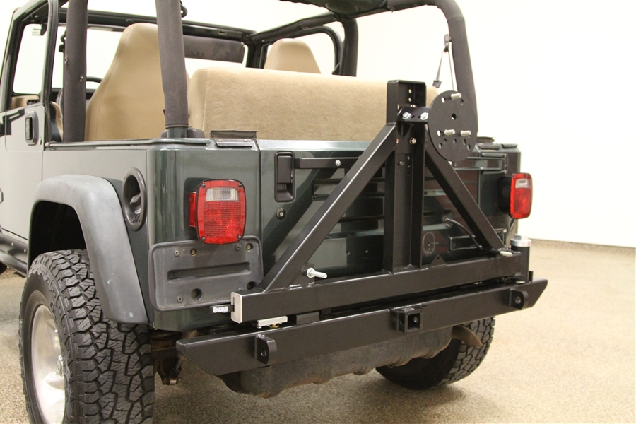

Mine is an aftermarket that bolts to a rear bumper. Sorry I should have specified. Similar to this one
Reactions: lBasket
You did say that, which is what prompted me to say post a picture so folks would stop going off-point worrying about your tailgate hinges.
