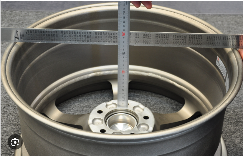

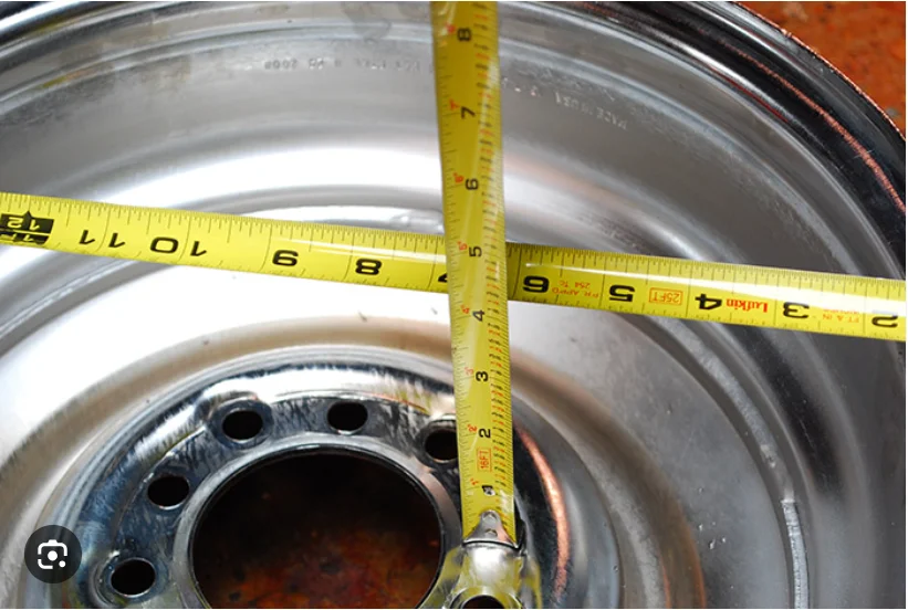

If you are happy with your current steering and handling and wish to mimic or maintain that, measure your current backspacing. That is done by laying the outer face down and a straight edge across the wheel close enough to the center that you can measure down to the face of the wheel mounting surface.
Once you have that number, then you can use it to copy the same to the new wheels with some basic math, or improve it if desired. The biggest mistake I see on here due to lack of any understanding about the benefits of good backspacing is moving the wheels out too far to "improve stability". While that may make it slightly better for resistance to tipping over, the crappy steering you get in return is not a good compromise if you care about such things.

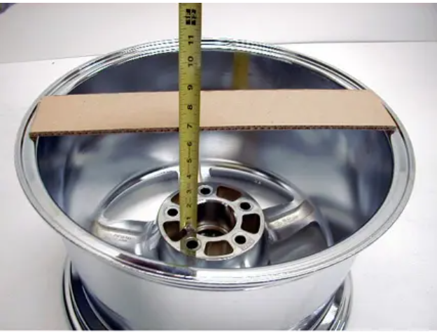

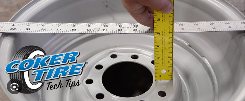

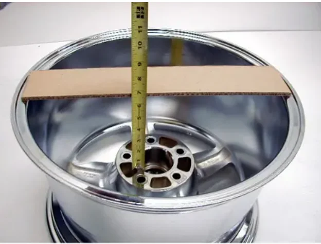

I will apologize in advance for the pictures after the correct one since they illustrate my pet peeve about folks who simply lack basic common sense about straight edges and how they work.
This is correct, the straight edge can't bow and alter the measurement.
This and a few others were done by idiots.
