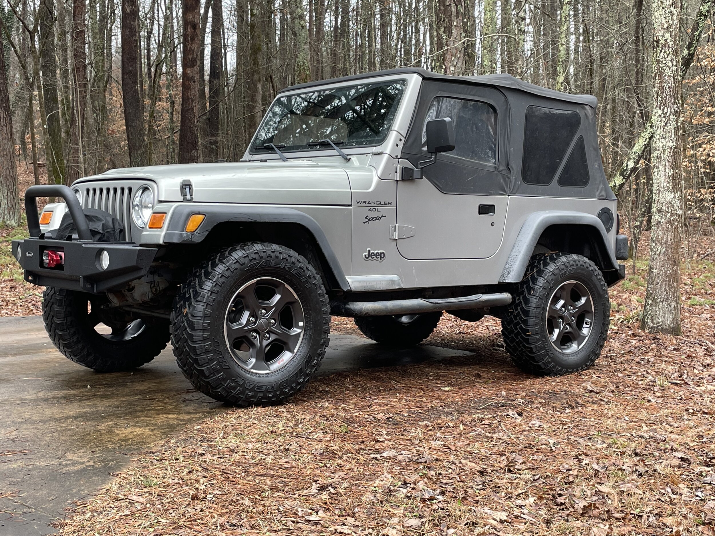

If/when i go to a 35-12.50 maybe I should swap to a 1.5" adapter. The wheels are flush with the 6" metalcloak fenders right now so if i swapped to a 1.5" adapter they would be inside the fenders by a half inch, and swapping to 4" fenders would leave the tires sticking out by an inch and a half.
I had planned on Spidertrax adapters, but ended up with Rough Country. Both have a beefy hub ring and what appears to be quality hardware.
RC is hardly top of the line, but I’d be wary of Sunnylife or ImprovesHappiness or whatever pot-metal stuff you’re likely to find on AMZN.
I'm running JT wheels with adapters and have had no issues.
My tires are 285/70/17 so not quite 35's.
I did have to install a washer on the steering stops on each side to stop rubbing when turning.
I check the torque on my adapters every time I have the wheels off.

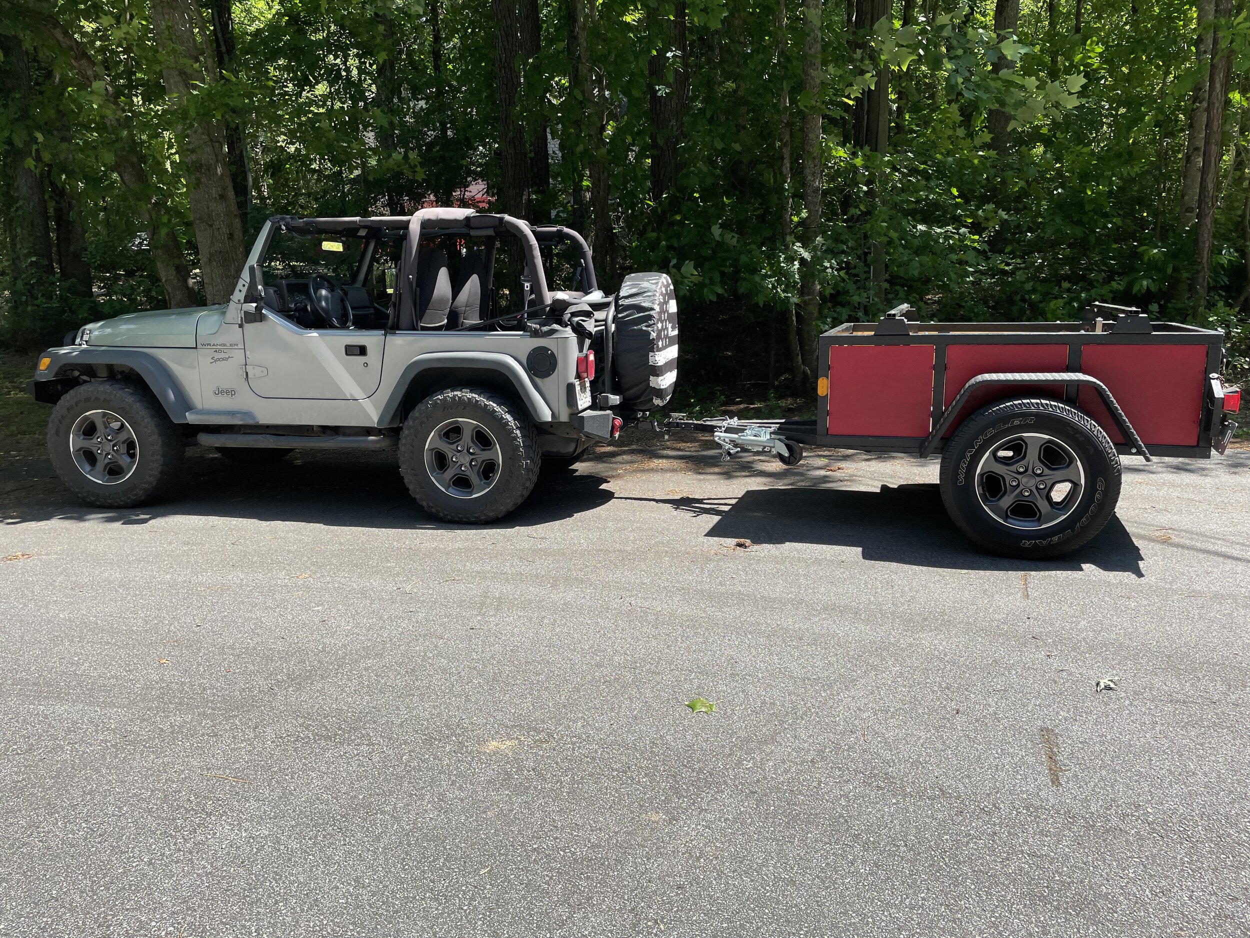

I picked up 8 of these for $200. 5 on the Jeep and 3 for the camping trailer.
