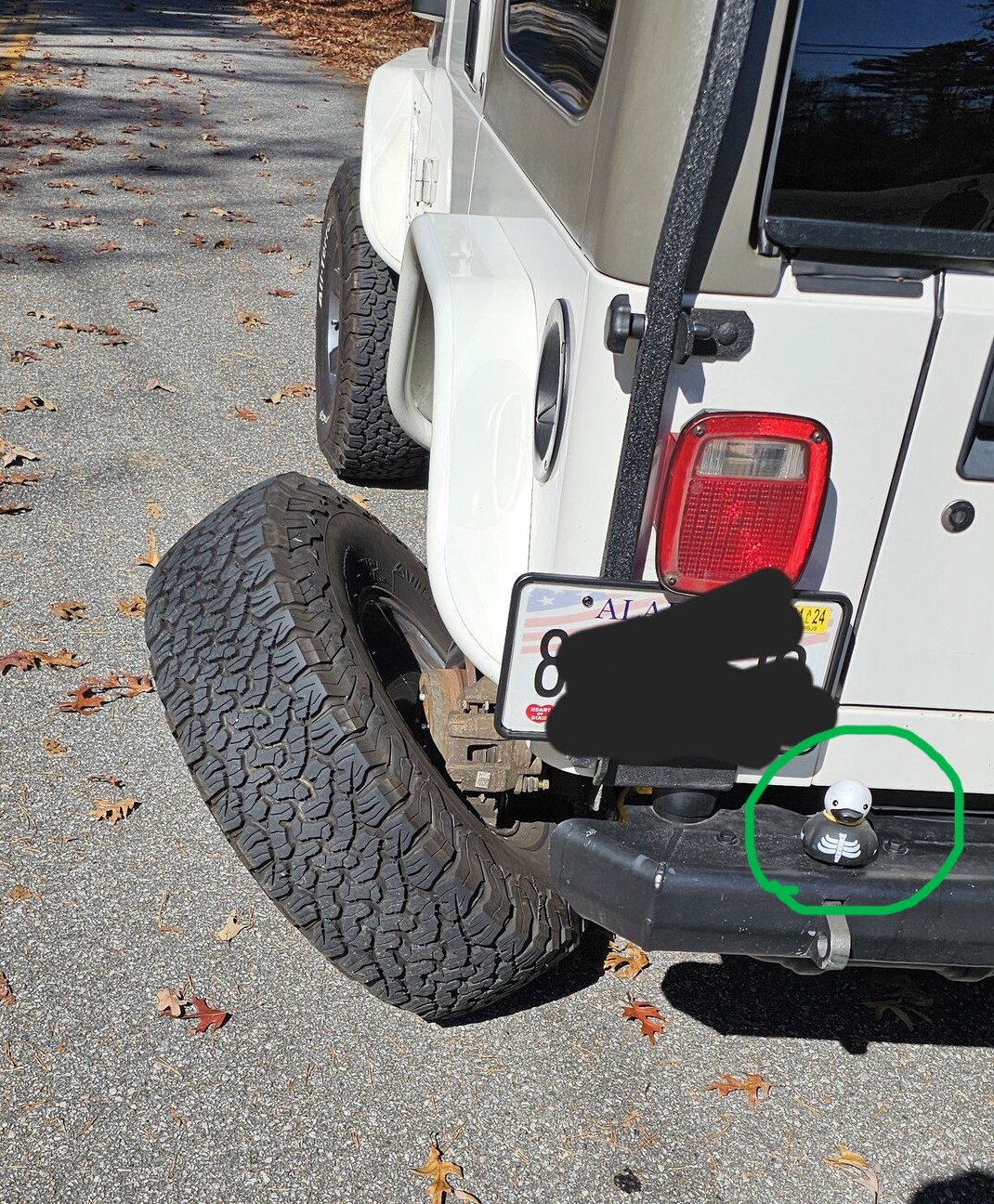

p.s. @John Cooper knows a guy that blamed it on a duck
Let's not pick on @AndyG for this. He blamed the duck because he forgot he had one of his employees do a tire rotation.![]()

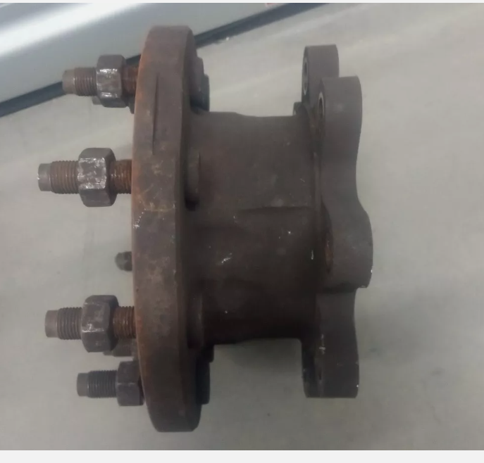

You might have missed the point. That spacer is on the truck from the factory on the front unit bearings.

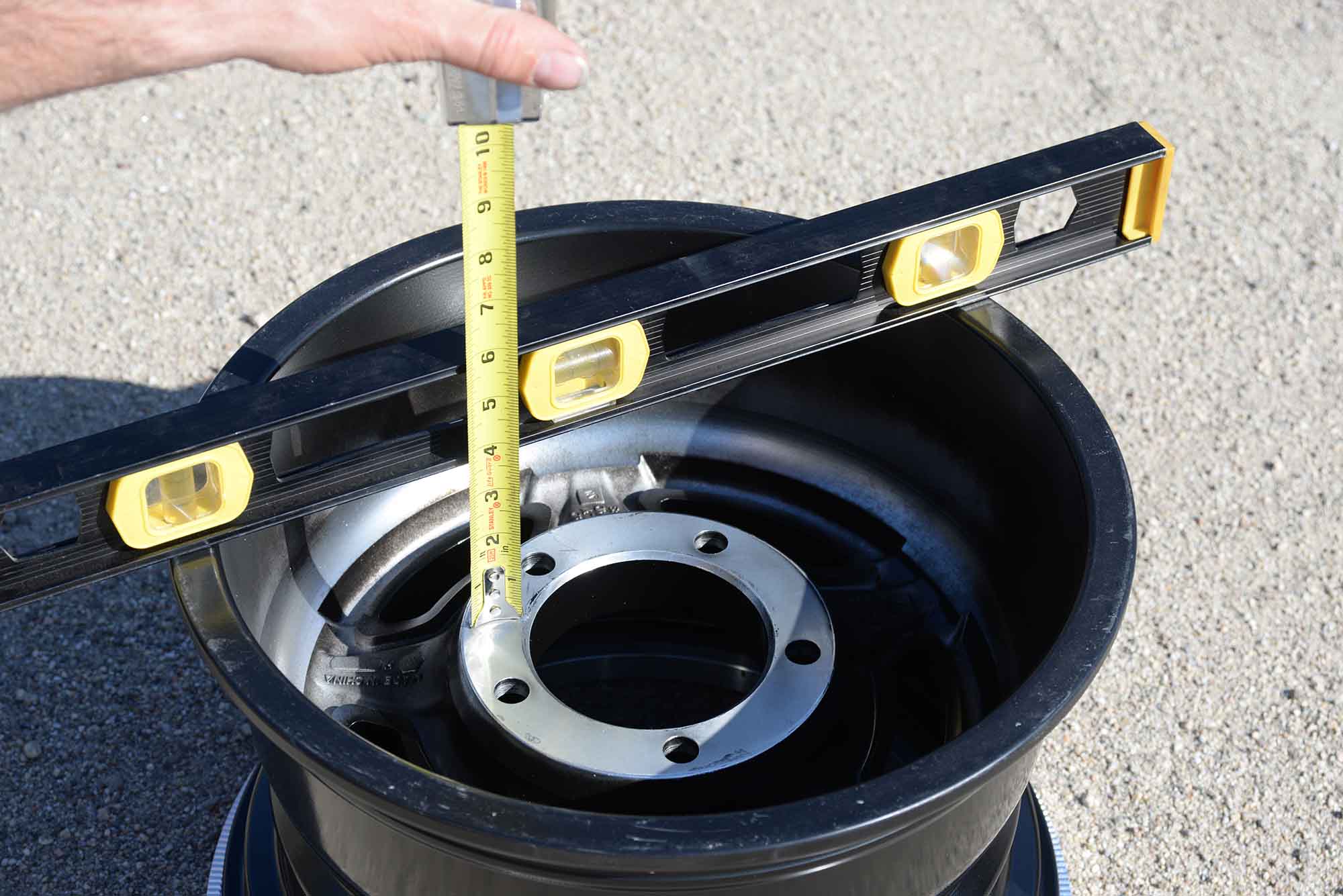

Too little backspacing and the scrub radius is too greatly impacted causing poor handling and accelerated wear on the ball joints.
This is why mine has 4" backspacing on 35x12.5" tires
Im looking at a 17x9” rim with -12mm offset, which looks to be ~4.5” backspacing.
What width spacer am I looking at needing here? Tires will be 35x17x12.5 if that matters. Or is -12mm offset + a spacer going to create problems?
I don't know offset. 4" of backspacing is a good number to work towards for a 35x12.5
Problem is it already has 4” of backspacing so it’s going to be more? Less? Once I add the spacers to correct the bolt pattern.
