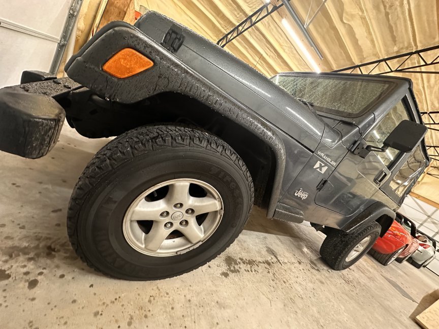

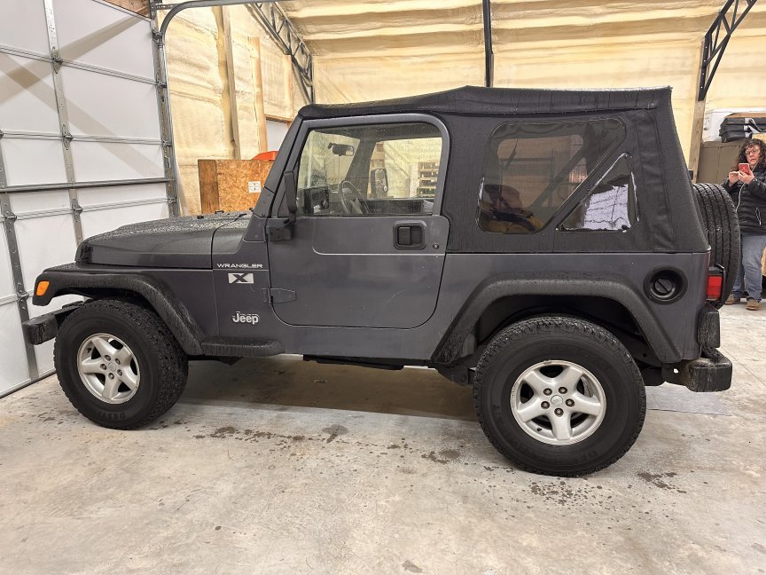

The tire size on it right now is 31x10.50 R15LT Is that a good tire size for my TJ?
I run 31"x10.50 15 BFG KO2's with no issues on a set of factory Ravines. As I understand it, that's the largest tire for stock suspension TJ/LJ Jeeps.
