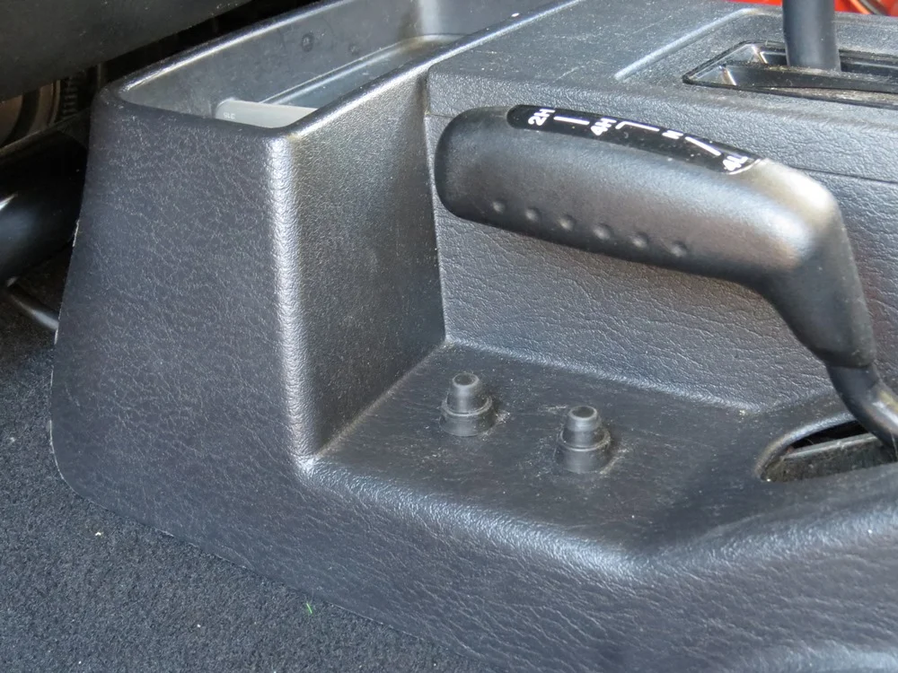

That switch placement is interesting, I had been thinking about working with the area of the factory switch since I don’t have a hardtop/rear wiper and could possibly utilize those spots. Was that a difficult install running wires to the switches in that location?
I bought S-tech's complete kit. There's a single group of wires in wire loam that pass through the firewall and up the drivers A-pillar behind the plastic trim. The first three witches (locker power, front locker and rear locker), I disconnect the leads back to the S-Tech control module and I ran new wire along the Passenger A-pillar to control the locker mod relays connected to the three switches.

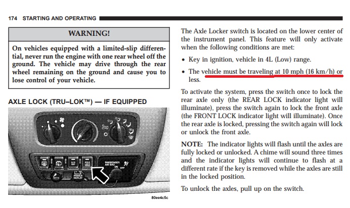

Speed limit? The Jeep manual says lockers are limited to 10mph. I don't always follow the rules, but I can get 10mph in 4L.View attachment 211531
The 10mph is for engaging the factory lockers. I believe they are limited to 45mph in factory configuration but I need 4 Hi wheel speed for some stuff and the factory settings combined with the 4 to 1 low range does not cut it.
My Rubicon lockers have never disengaged, so I'm not sure what the 45 MPH deal is.
