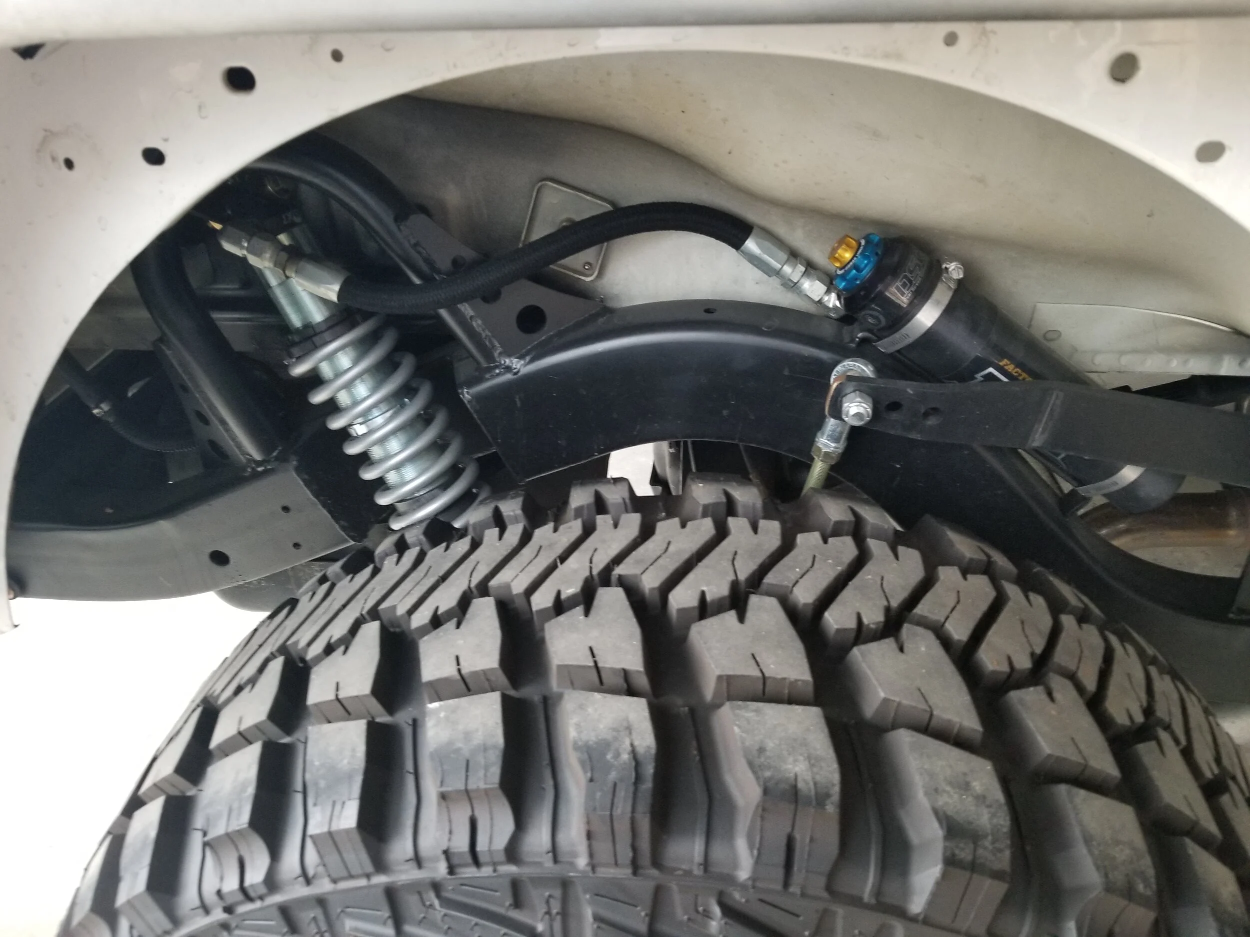

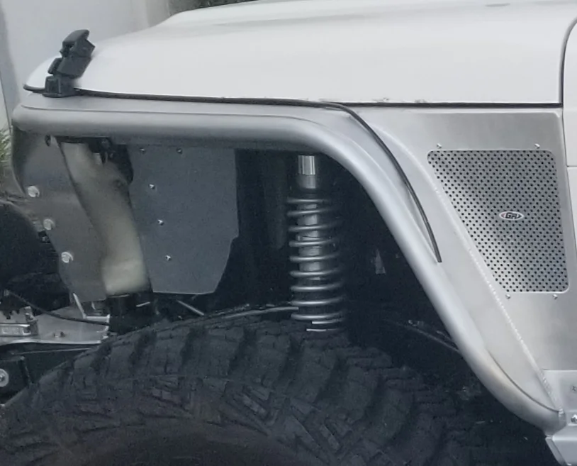

Tell us everything about them, including how you packaged them onto a factory width axle without interference with the tires, brake calipers, and frame or upper mount.
So it's not feasible to run coilovers on factory width axles? I can also admit that I am pretty ignorant when it comes to understanding suspension geometry and shock tuning.
It is feasible. There is a whole lot more to it than a simple shock outboard because of the added diameter of the coils surrounding the shock body. The rear towers need to be moved past the inner wall of the frame rail towards the gas tank, if there is one. And there is an inherent length limitation due to packaging restrictions. This all assumes you want things to fit nicely.
It is very feasible. But, unless someone is fairly magical, there are some pretty hard limits unless you compromise things you really shouldn't. With the stock width and 35's at 4"ish of back spacing, about the most you can swing is a 12" travel 2.0. Even then, they will generally swing all the way through the frame in the rear. I'm not comfy with other than a significant reinforcement on the inside of the frame for them to swing into. As such, the work goes up a bit but it is very doable.
The compromises would involve screwing up the backspacing and or making the rear wider with spacers. I'm not a fan of that at all and we really prefer in order to get good steering that we keep an eye on the back spacing and keep it around the 4" mark. Some folks will lean the shock way back to get it out of the way of the tire and I prefer to keep it approximately at a right angle to the lower control arm.
So, front slightly wider than the rear, same as factory, good back spacing, shock angle reasonably good, 35's, it gets very tough to get more than a 12" travel 2.0 in there.
