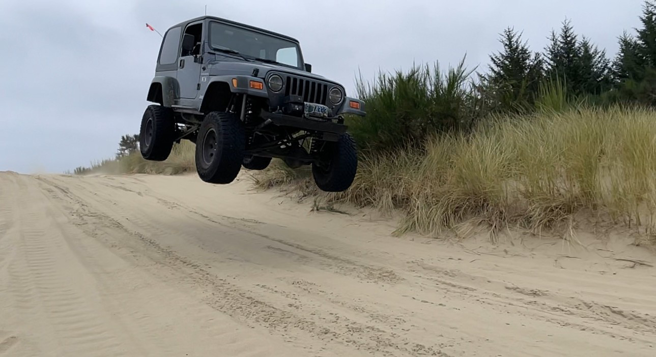

This was Trevlaw’s ROTM pic. Safe to say most of us aren’t doing this with our TJs 🫣
