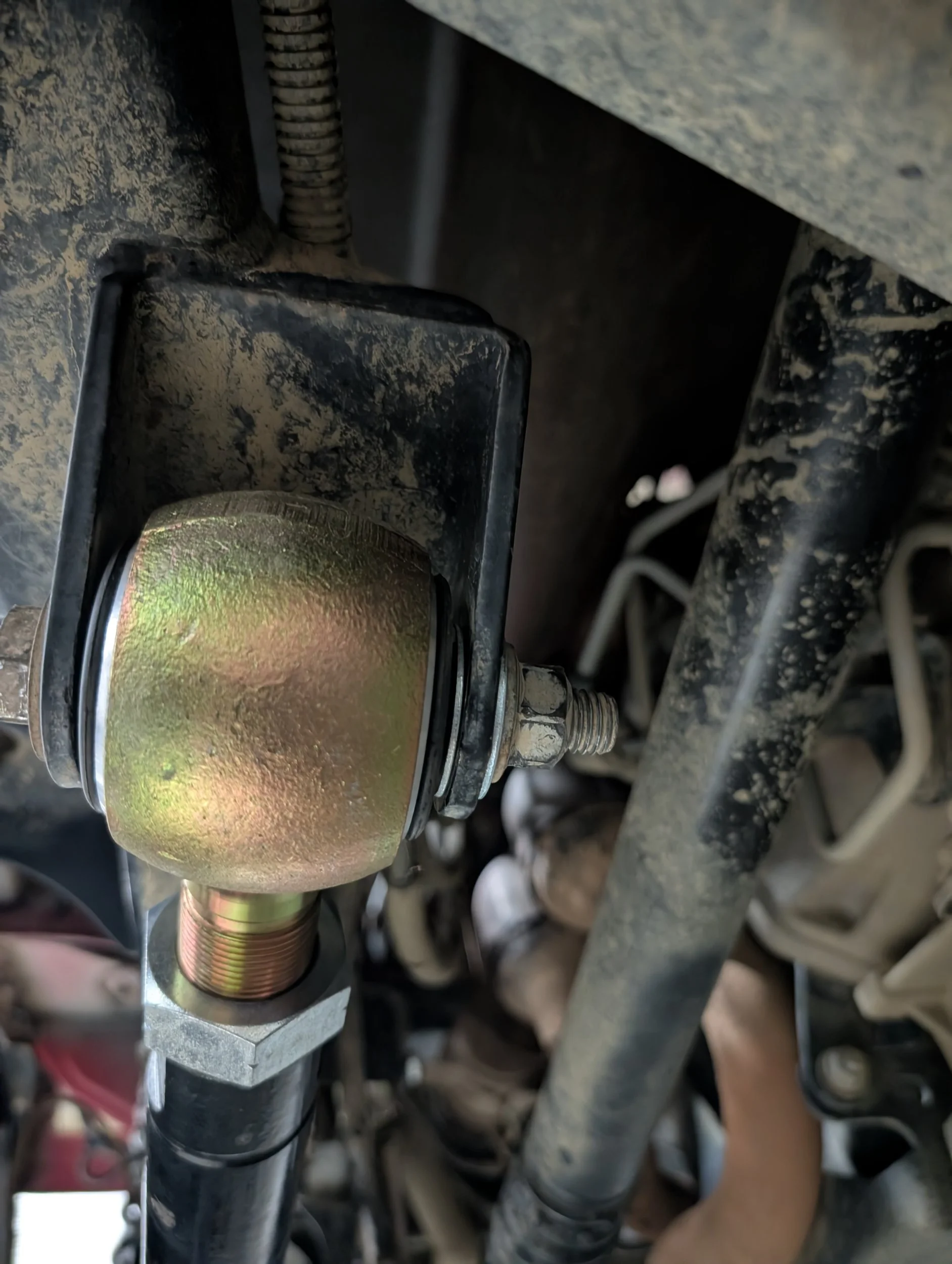

I am changing out the joints on my lower long arms, the axle-end joints were really shot. I have an older Teraflex long arm kit and I am using a Teraflex large rubber control arm joint (Item J117701) so I am using the right part - but it has noticeably more space in the mount. Maybe this is normal? Obviously I have not tightened it up, but this is the play it has with the new joint on the frame end:
I am thinking about sticking a stainless steel fender washer in there to shrink the space... bad idea?
On the other end I changed it to a Johnny Joint and it fits perfect, a really tight fit .

That is on the axle end, the frame end is a clevite like rubber bushing.
Well, it still seemed to allow some slight movement, so I used a washer as a shim to remove the play... I am wondering if that is going to cause problems?
