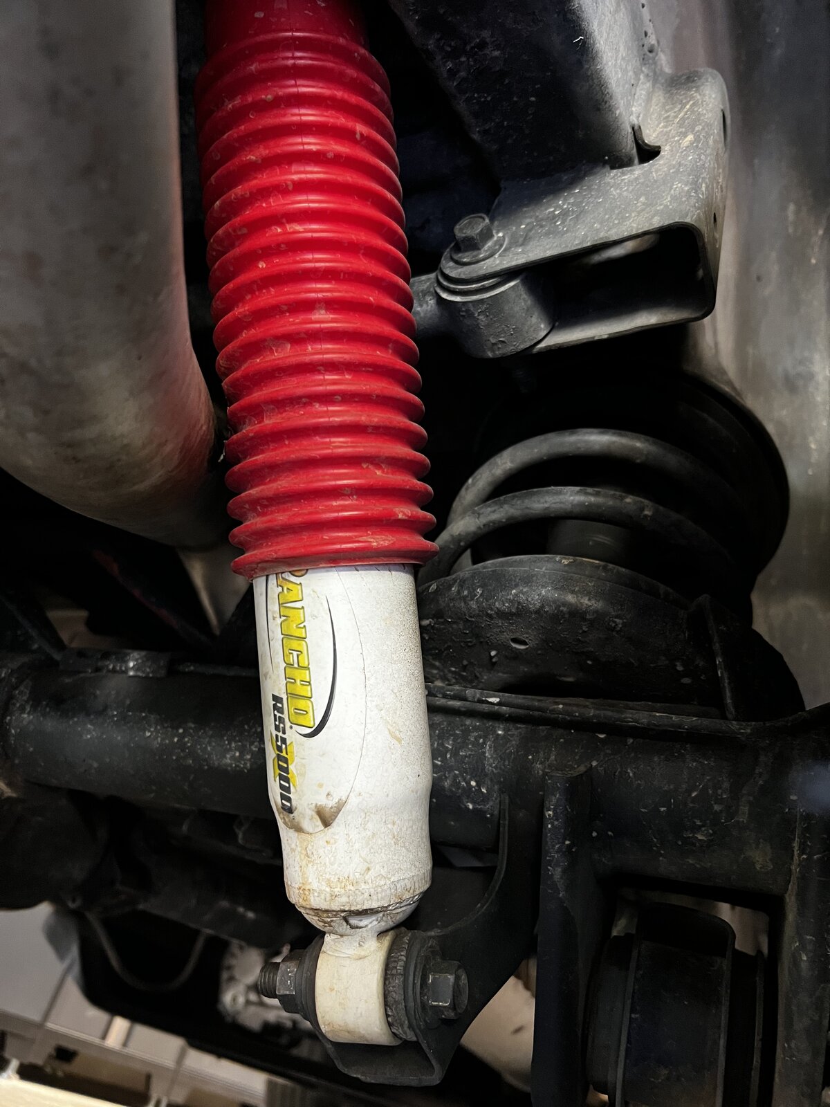

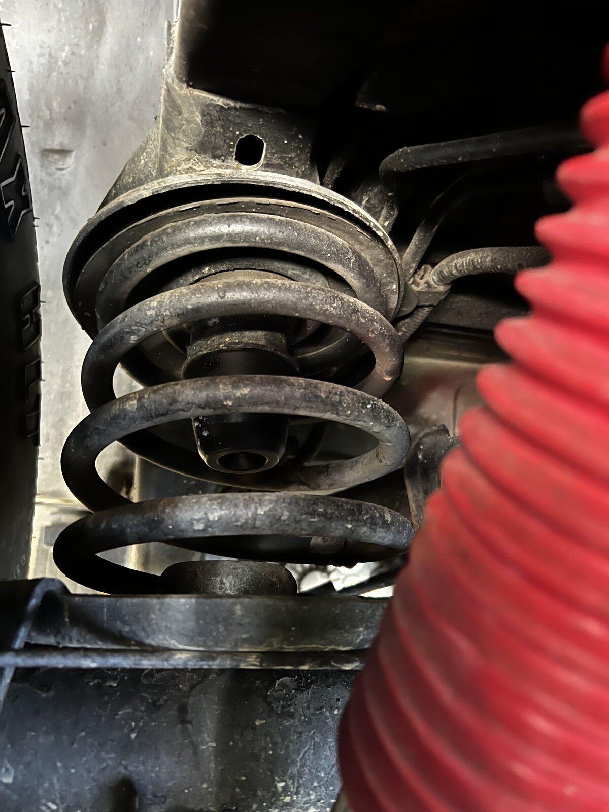

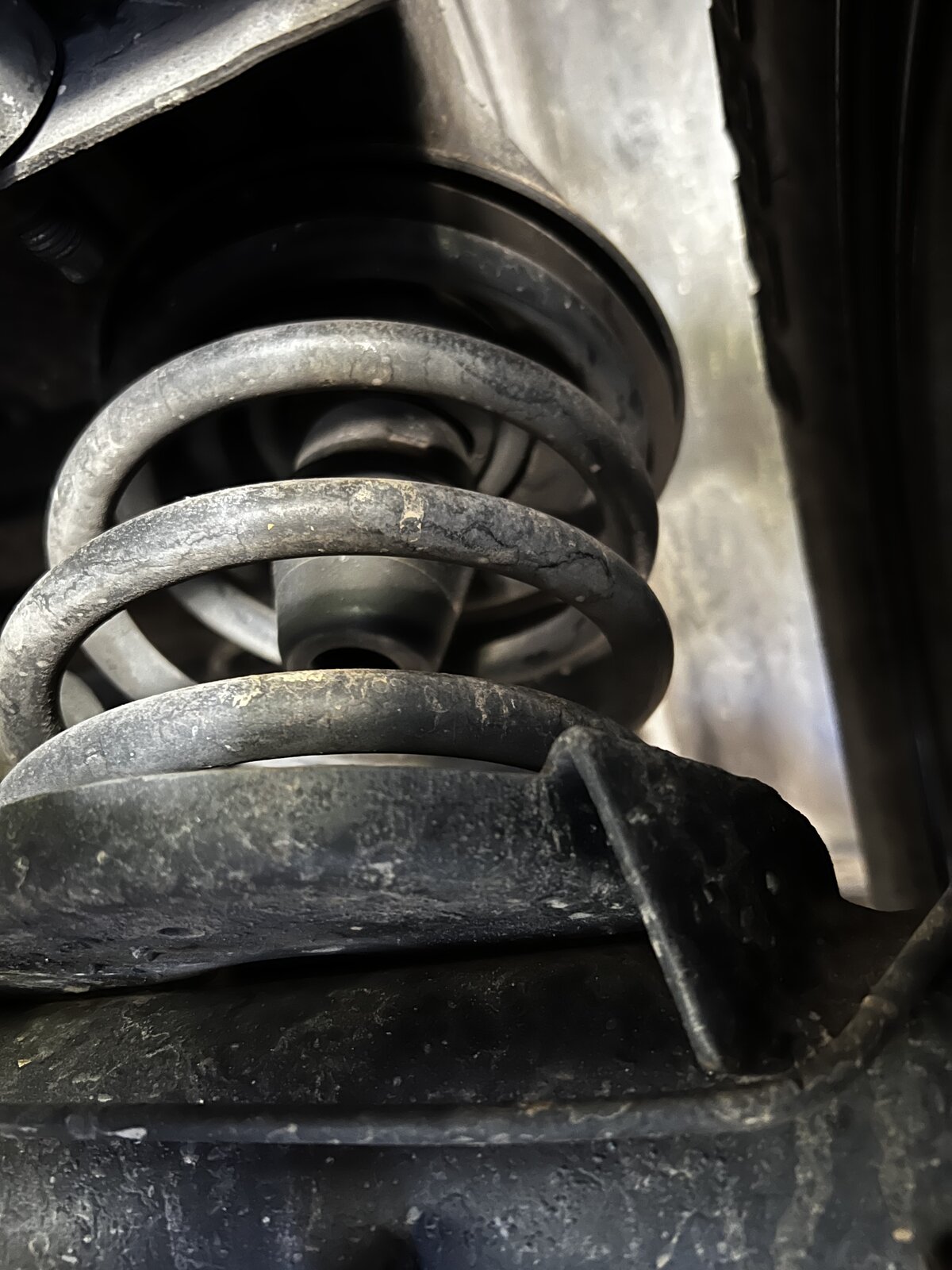

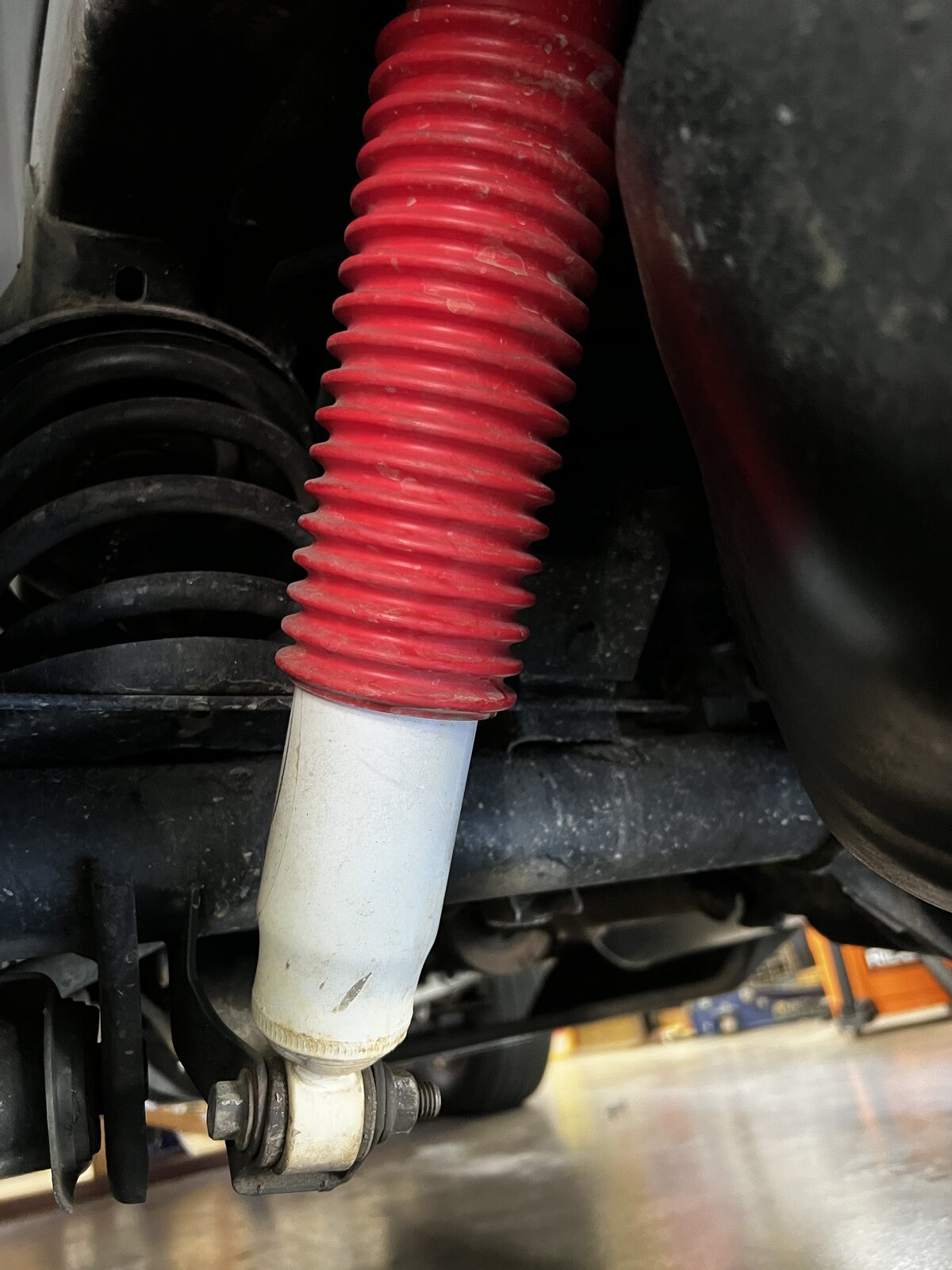

Here’s pics of rear shocks and springs. I don’t know that this will help, but picture worth 1k words…mayb
Reactions: Rickyd
I’ve decided to take one for the team. The wife bought a set of rancho 5000 for me for Christmas. I’ll remove the ome shocks and report back after she lets me have them for Christmas. The ome shocks ride like a log wagon. Cmon Christmas
