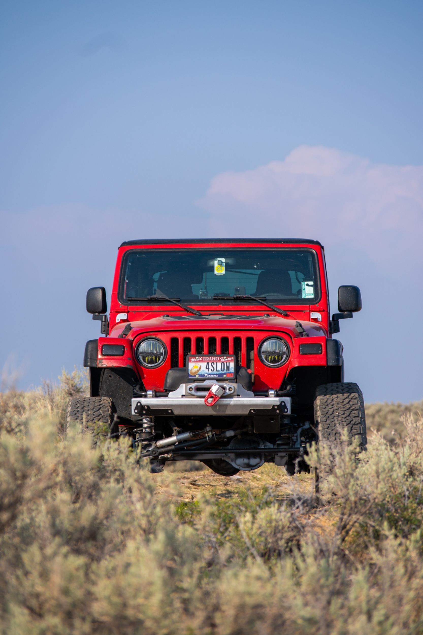

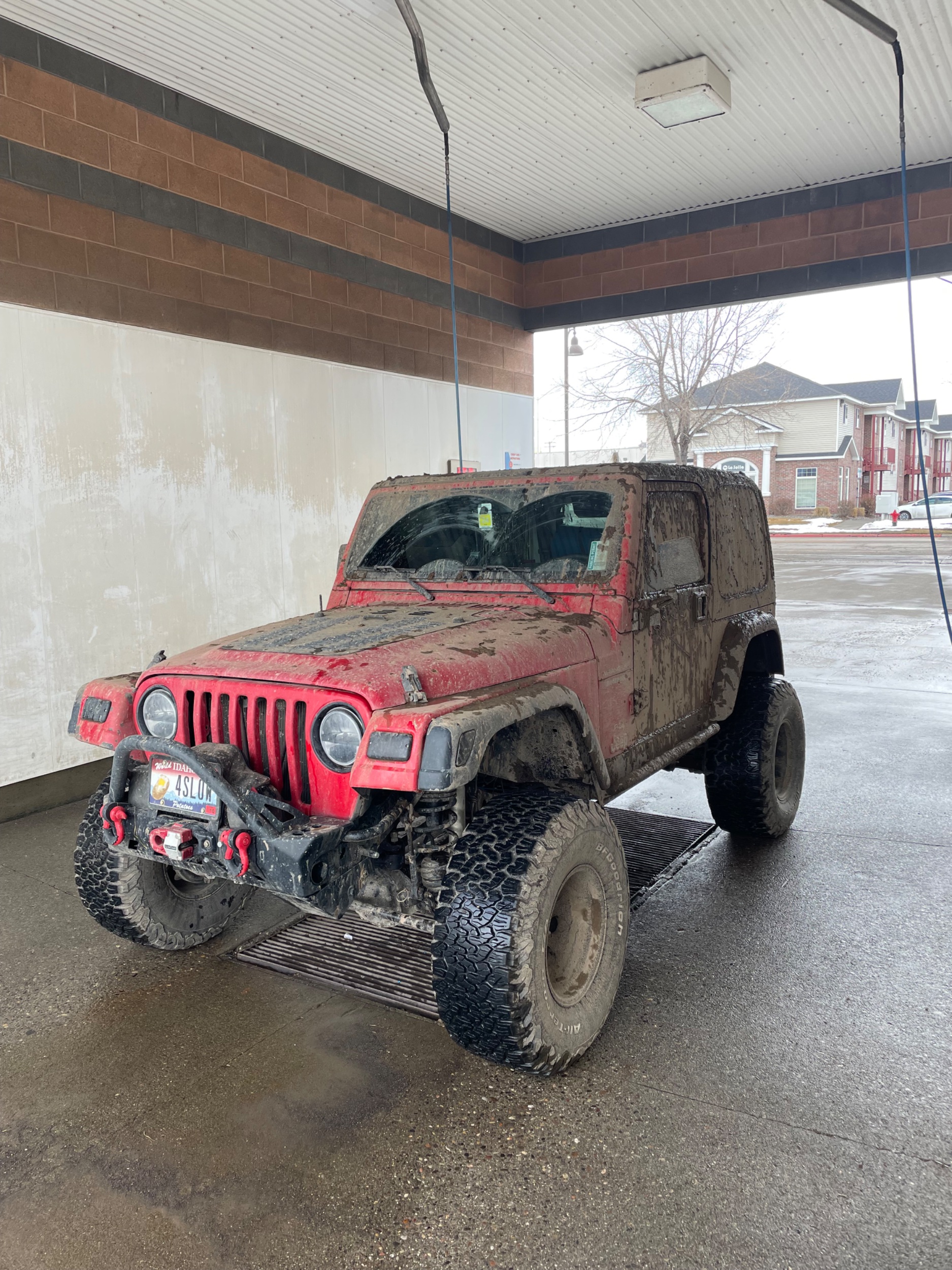

I know I'm a little late to the thread but I'll add my thoughts and recent build as well. Everything works really well together and rides & steers nice and tight.
2" JKS springs
3/4 spacer on left spring, 1.25" spacer on right spring
OME shocks
Moog control arms
RE rear extend brake hose
Raybestos front extended brake hoses
Zj steering
JKS front and rear track bars
RE front quick discos
JKS rear adj sway bars
JKS budget motor mount lift
1" body lift
255/85/16 tires running 25 psi
kept stock 4:10's with 6spd
savvy cable shifter
I did a bunch of other stuff as well but this is the meat and potatoes of what you are looking for.

Why the different sized spacers?
