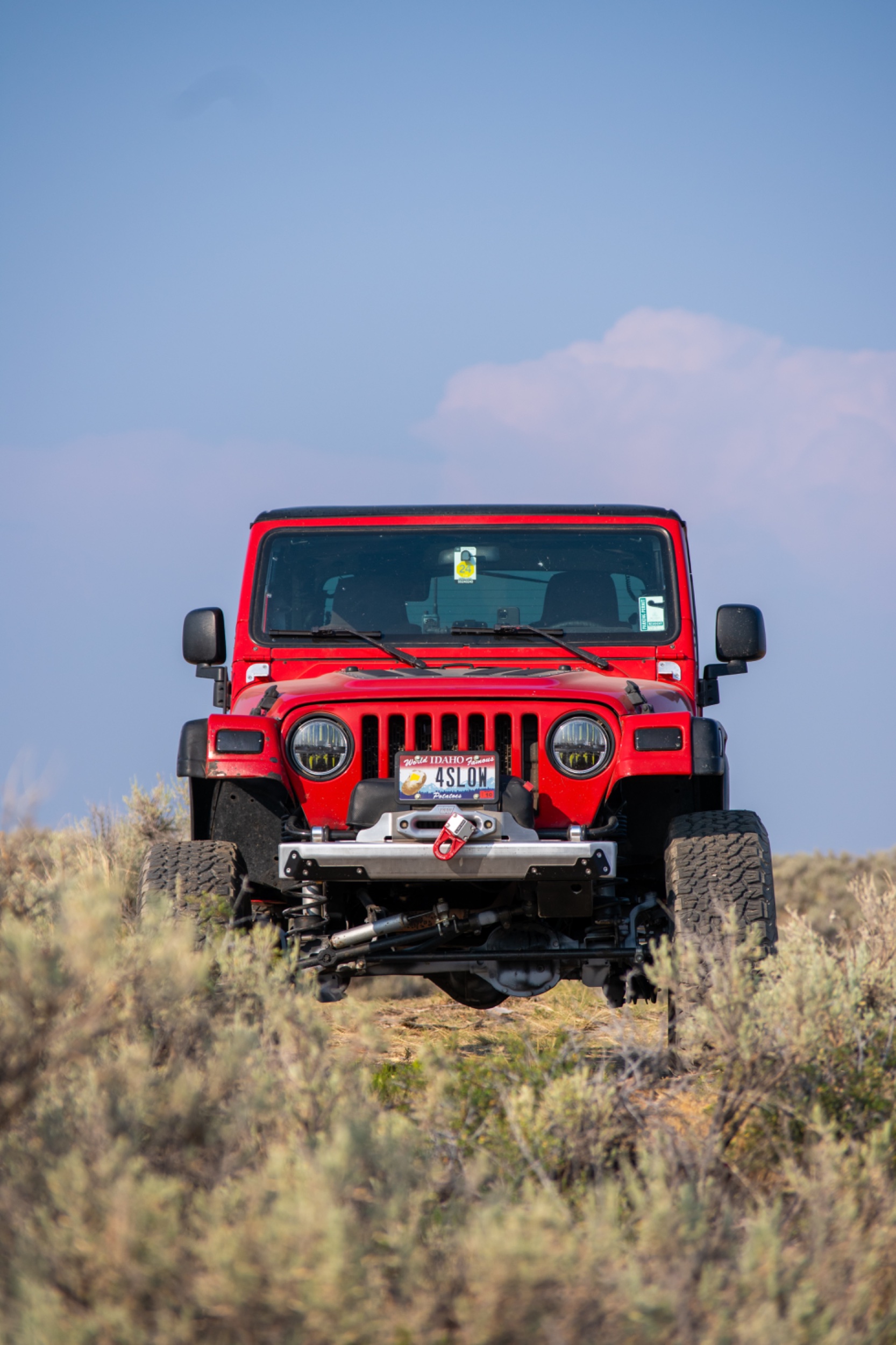

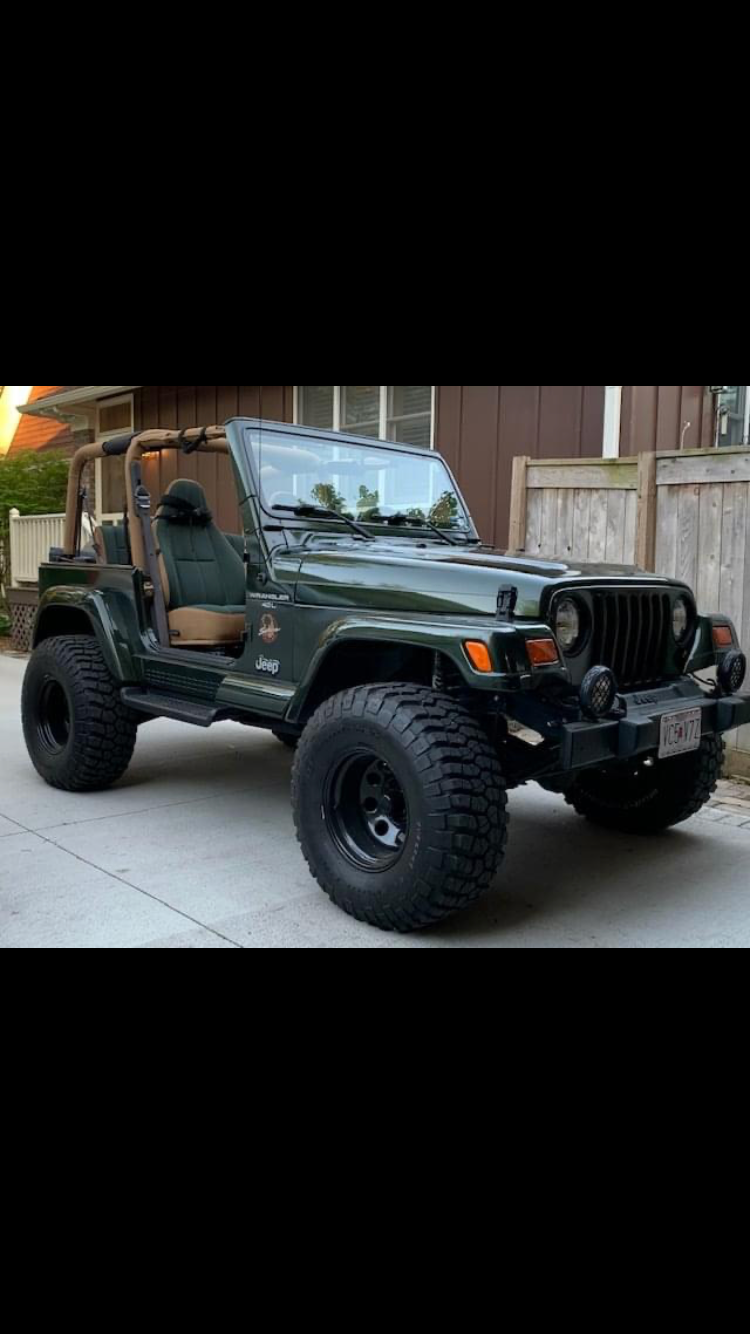

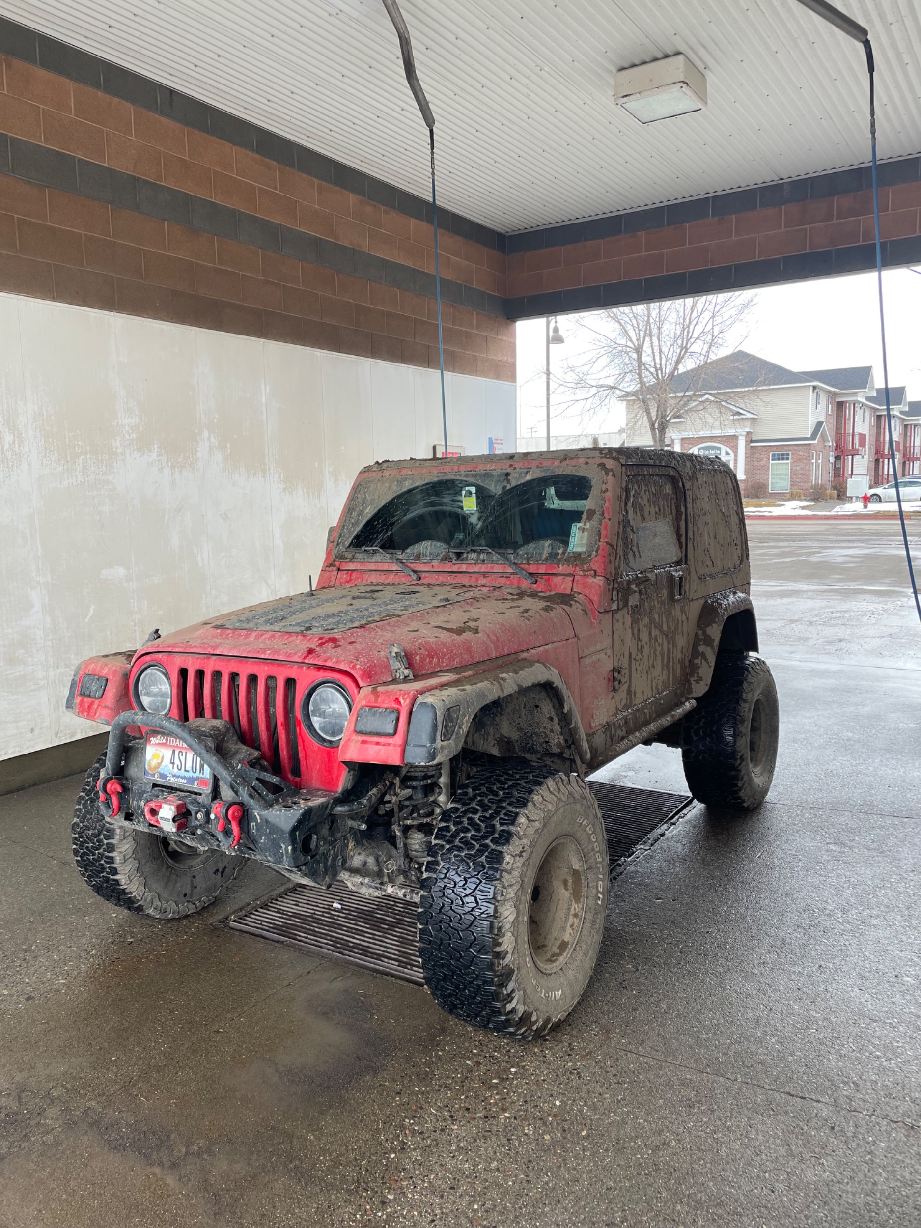

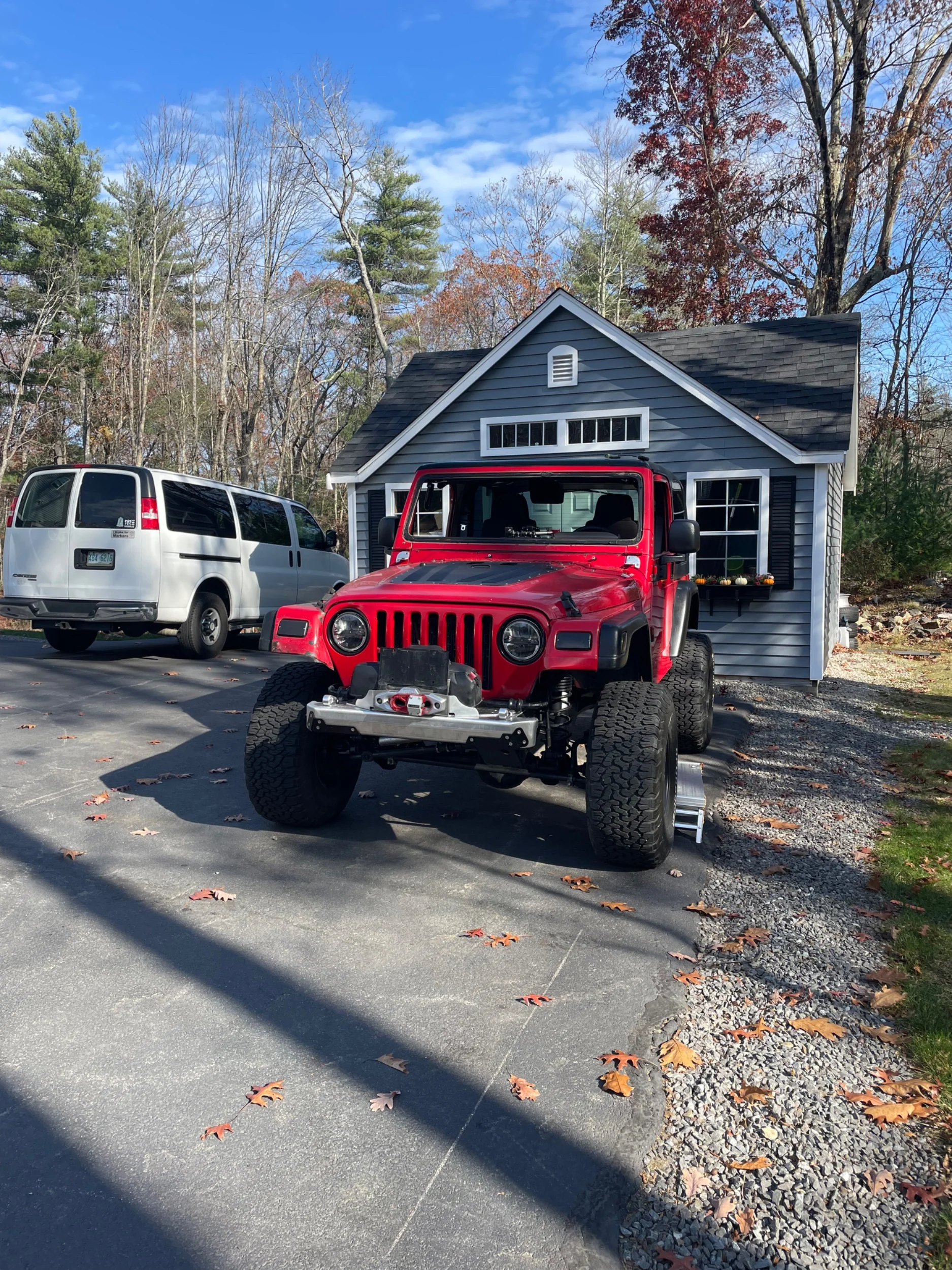

My jeep is running 33x12.5r15 with 10in wide with 3.65in back spacing. There is a lot sticking out. So much so I can’t even slightly pass for fender laws. Mud will get flung everywhere but you’ll never rub on anything metal. You will rub on fender flares at stock height because they stick out so far. I highlined the stock fenders to not rub so much but different flares would have solved that issue as well.
I've had a few different guys ask me if i swapped wider axles into my rig when they see the 15x10's and 33's. It's a bit much. Lots of caster and tight suspension makes it drive ok albiet darty and wandering a bit. I'll be going to 15x8's with the next tire change
