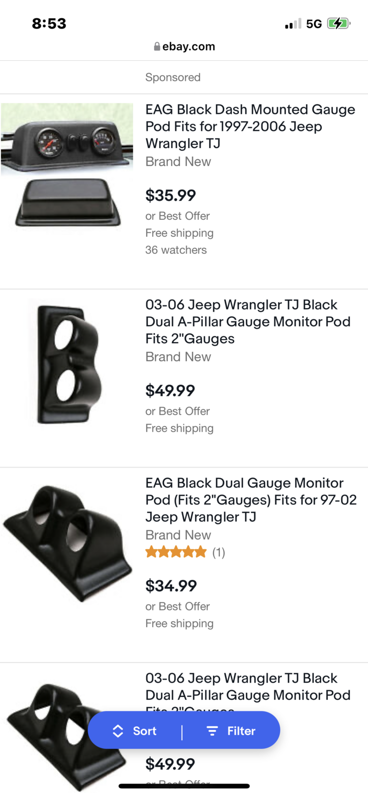

eBay depending what year tj,I used auto meter push buttons to hold it on
I have the dash pod but would prefer A pillar. Looks like they list that for 03-06 only for some reason. I wonder what the difference is....
Oh, so maybe I can just add the A pillar covers from a '03+ and run them? Remind me to look at yours next time we do beers. That looks a lot cleaner to me instead of on top of the center bezel. Bonus points for getting my center bezel tray back so I can store...... absolutely nothing that will stay put anyways. But I want it anyways 😎

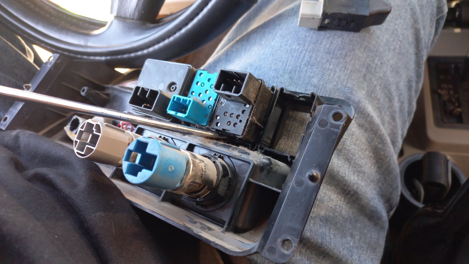

Here are some photos for the lights in the rocker switches. Once you pull out the frame for the switches (and power outlets), you'll see this:
To get to the main switch light, you need to pull each switch from the frame. It is much easier to do if you unplug each of the switches and outlets. There are clips on both top and bottom. Pry the clips carefully with a very small flat screwdriver or a thin trim removal tool. Be very careful as these clips are easy to break. Once you get a switch out, you'll see this:
I didn't attempt to swap these bulbs, as it appears there would need to be some soldering. I'm sure someone with the right expertise would have no problem.
