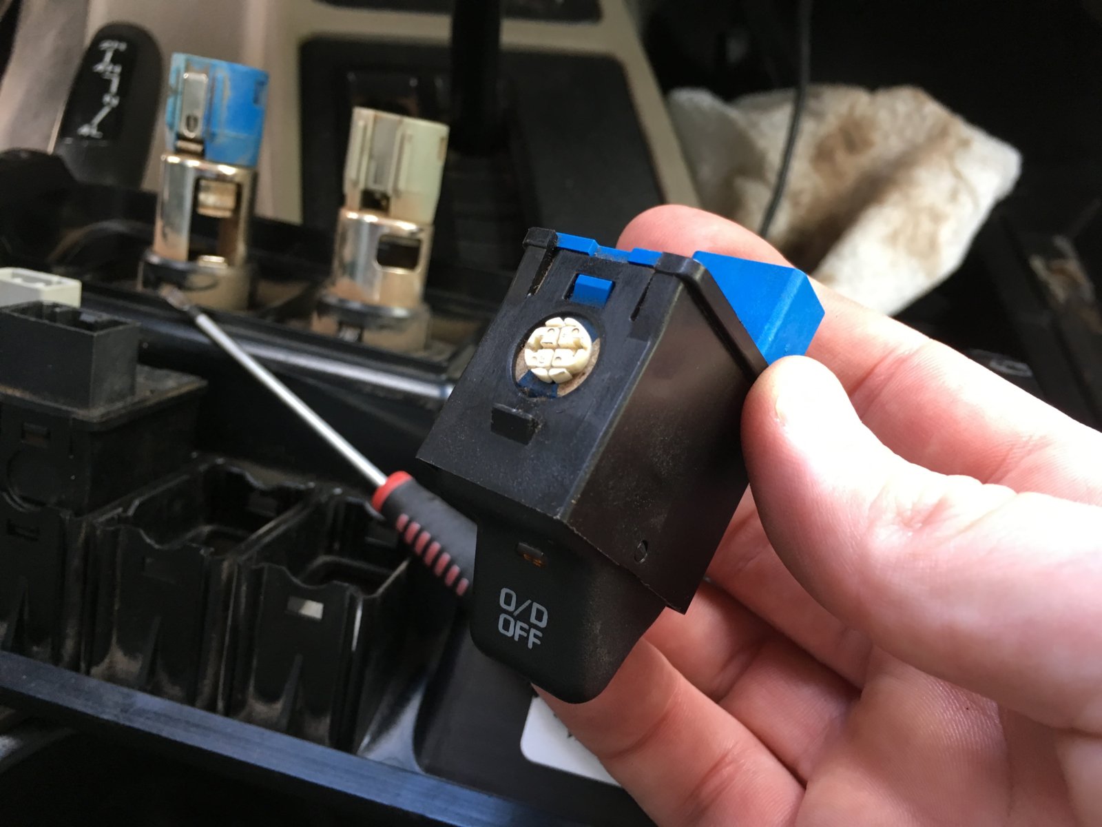

To get to the main switch light, you need to pull each switch from the frame. It is much easier to do if you unplug each of the switches and outlets. There are clips on both top and bottom. Pry the clips carefully with a very small flat screwdriver or a thin trim removal tool. Be very careful as these clips are easy to break. Once you get a switch out, you'll see this:
On the bottom is the main switch light bulb. This bulb is illuminated any time the parking lights or headlights are on. Turn the bulb a 1/4 turn with pliers or a very small screwdriver to remove. The replacement light on the bottom is the 4mm (from post #2).
I made a mistake in my earlier post that the bottom and top bulbs are the same. Unfortunately, the top light (for the indicator) is a different bulb and I'm not sure what size it is. My best guess would be a 3mm size in the same style as the 4mm bulbs.
As you can see from the first photo, the indicator bulbs are accessible without removing the switches from the frame.
If you have a Rubicon model, the Axle Lock switch is a tougher one to swap to LED. The inside of the switch looks like this:
I didn't attempt to swap these bulbs, as it appears there would need to be some soldering. I'm sure someone with the right expertise would have no problem.

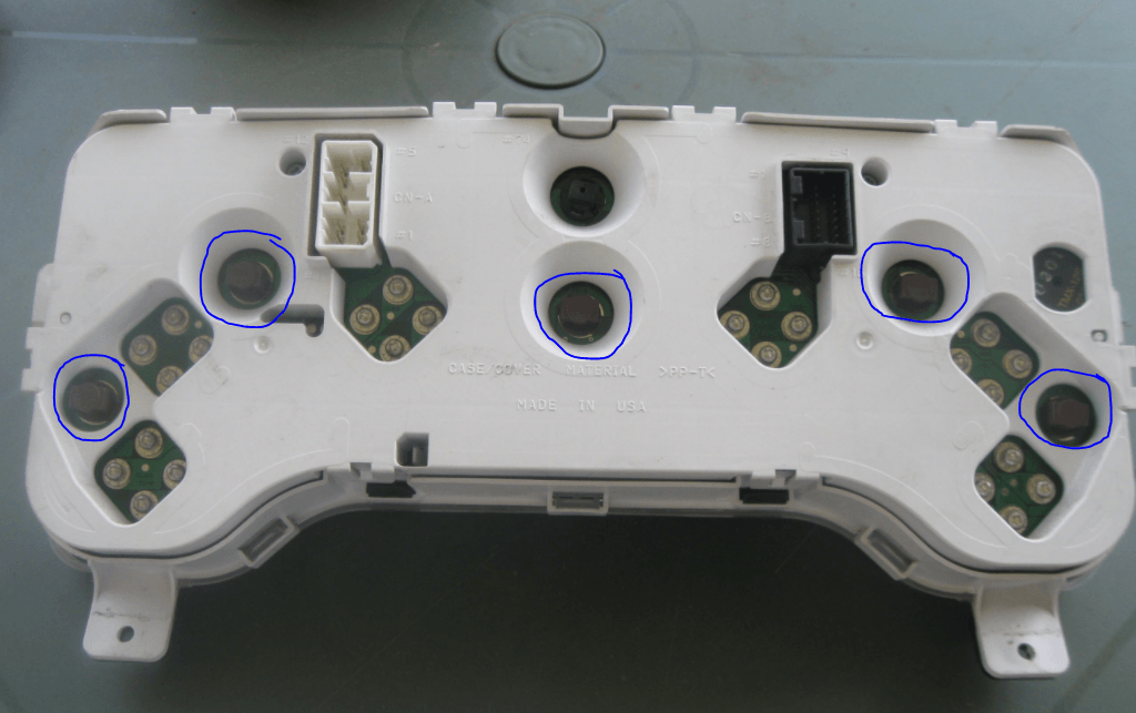

All five bulbs in the cluster are the same. You don't need to change the high beam or turn signal lights. See below:
Your cluster version may vary from this slightly, but the positions of the bulbs are the same.

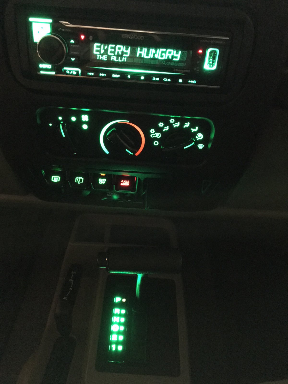

As hard as I tried, the camera just couldn't get a good photo. It looks so much better than factory though. The lights are much more green, and the Rubicon locker switch I put a red LED bulb in (so it looks red like factory) and it turned out great too!
It's not as blindingly bright in person as the photo make it seem. I also have the dimmer set to max in this photo, so that might be part of it too.

I did the cool white in everything..

I put natural white in the ac control. A little brighter (and bluer) than stock, but not overwhelming. It actually matches my aftermarket stereo. I also put a natural white in the gear selector, but its a little too bright for me. I'm going to try a warm white. Wasn't looking for a different look, just trying to reduce the heat.

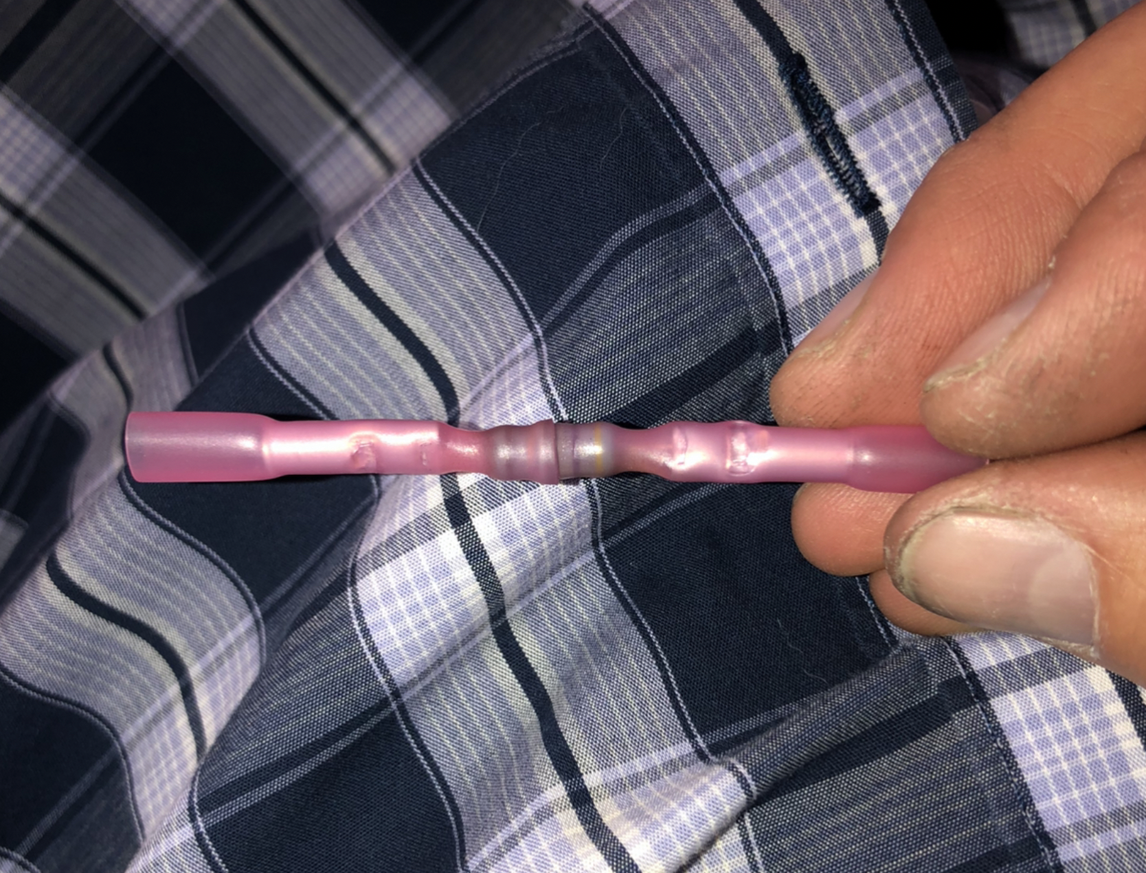

In case you are interested, I used a resistor to match the selector brightness to the dash about four years ago (still good to go). This allowed me to choose the color and brightness I preferred.
I attached gator clips to different resistors until I got the desired lumen output. I then cut the stalks down and encapsulated the resistor in overlapping heat-shrink splices. I did this to seal out moisture, add rigidity, and to provide a heat barrier for added safety (even though it didn't get warm to the touch).
I used the same method to match the color and brightness of my front corner lights when I converted to LEDs.
