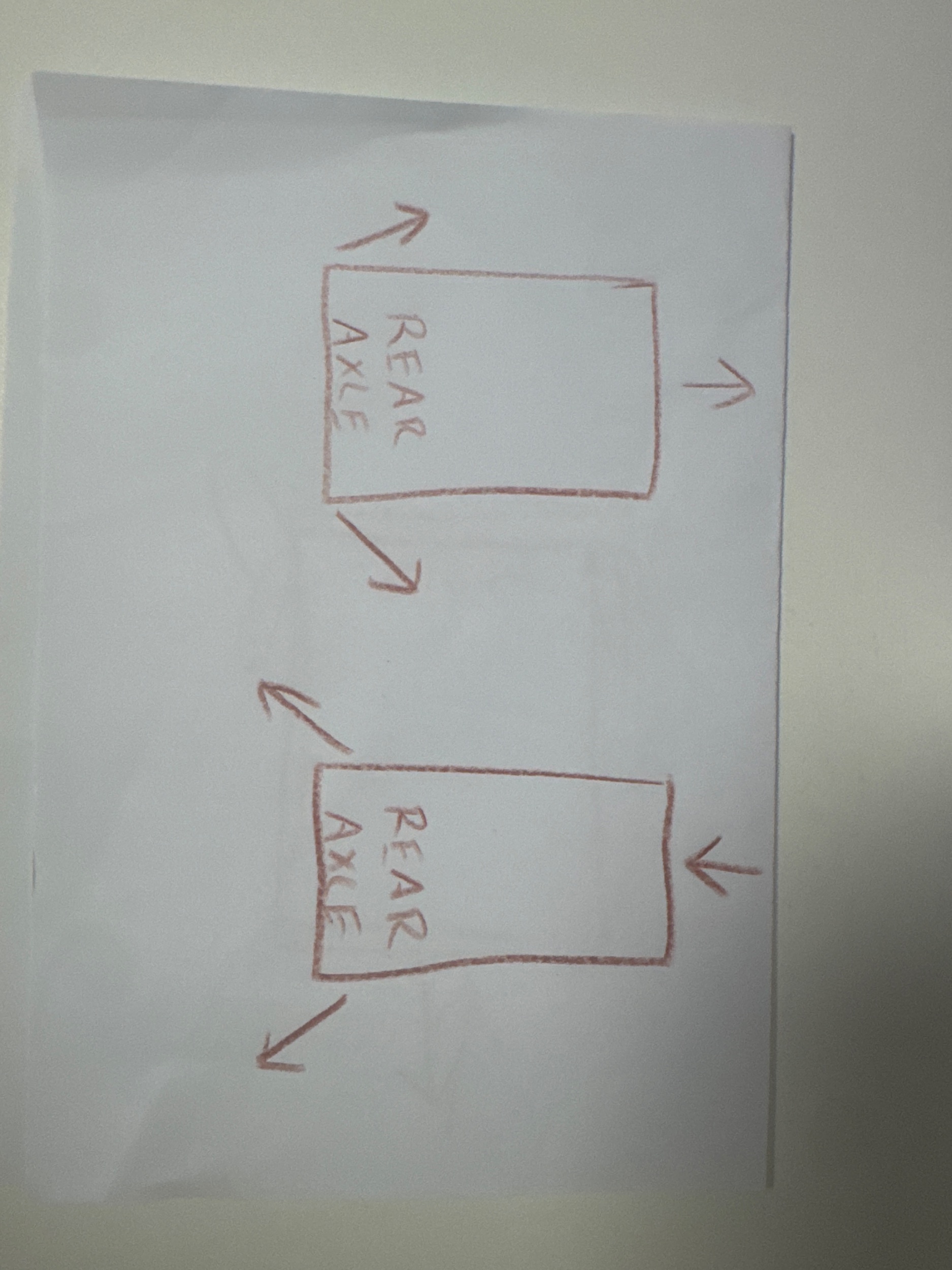

Sorry for my picture, I can't explain it better, but this is the direction the wheels would like to go.

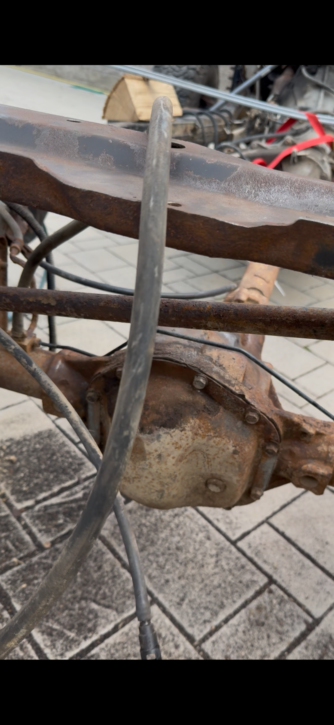

Only other thing I can think of is a wallowed out or loose connection where the axle tube is pressed into the pumpkin. On the pic, it looks pretty solid on the drivers side, but can't tell what it looks like on the passenger side.

Before I get too involved, I would like to know what is being seen that makes it appear that the tires are pulling the axles out of the housing.
the right side is also solid, it has no movement in the bearing. the picture should be taken with a grain of salt, let's assume that both wheels have the same camber, of course it's not as visible as in the picture
you can see that the wheels turn to a certain point, where they stay until I start reversing, then they turn in exactly the opposite direction. when driving faster through the zebra crossing (white lines) the tires squeal
So far, that is an accurate description of what you see when you go forward and then reverse. The squeal on the white paint used on crosswalks is also normal, especially if they are slightly wet.
