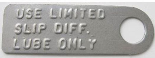

Look at the 1 o'clock position on your rear differential cover. If this tag is present you have a Tracloc LSD.
