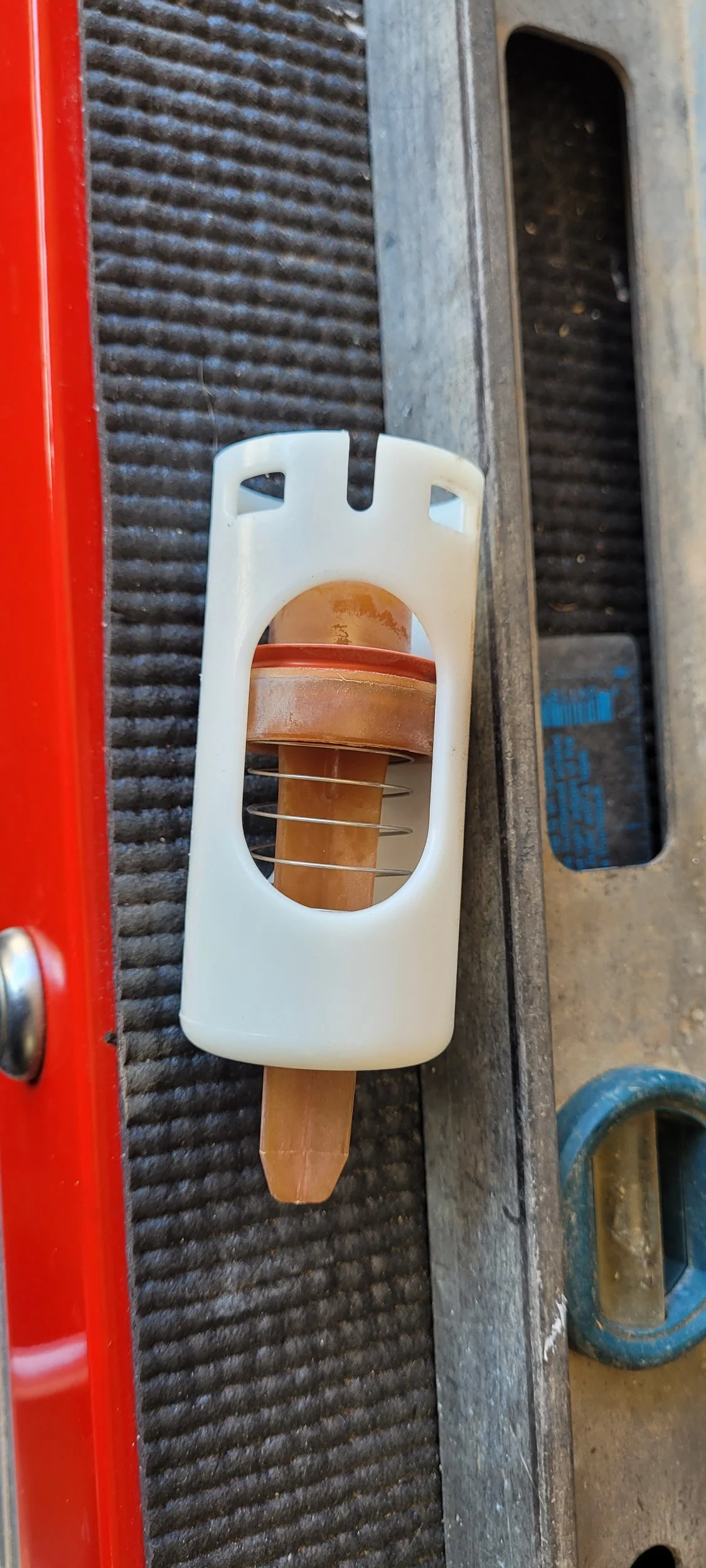

Sometime in early 2023 my son and his wife told me that now the pump would cut out constantly when trying to fill. It would take forever. At the end of 2023 I retired and traded my 2018 Jeep JK Unlimited for the 2006 Jeep TJ Sport so I could have a project to work on. The first thing I did was drop the gas tank and repair the broken connector at the check valve. I used a pen barrel as an insert and J-B Weld for plastic to secure it. I then removed the fuel fill check valve and sanded down the ridges as described by many on this site. I reinstalled everything and took it to the gas station and no problems filling.

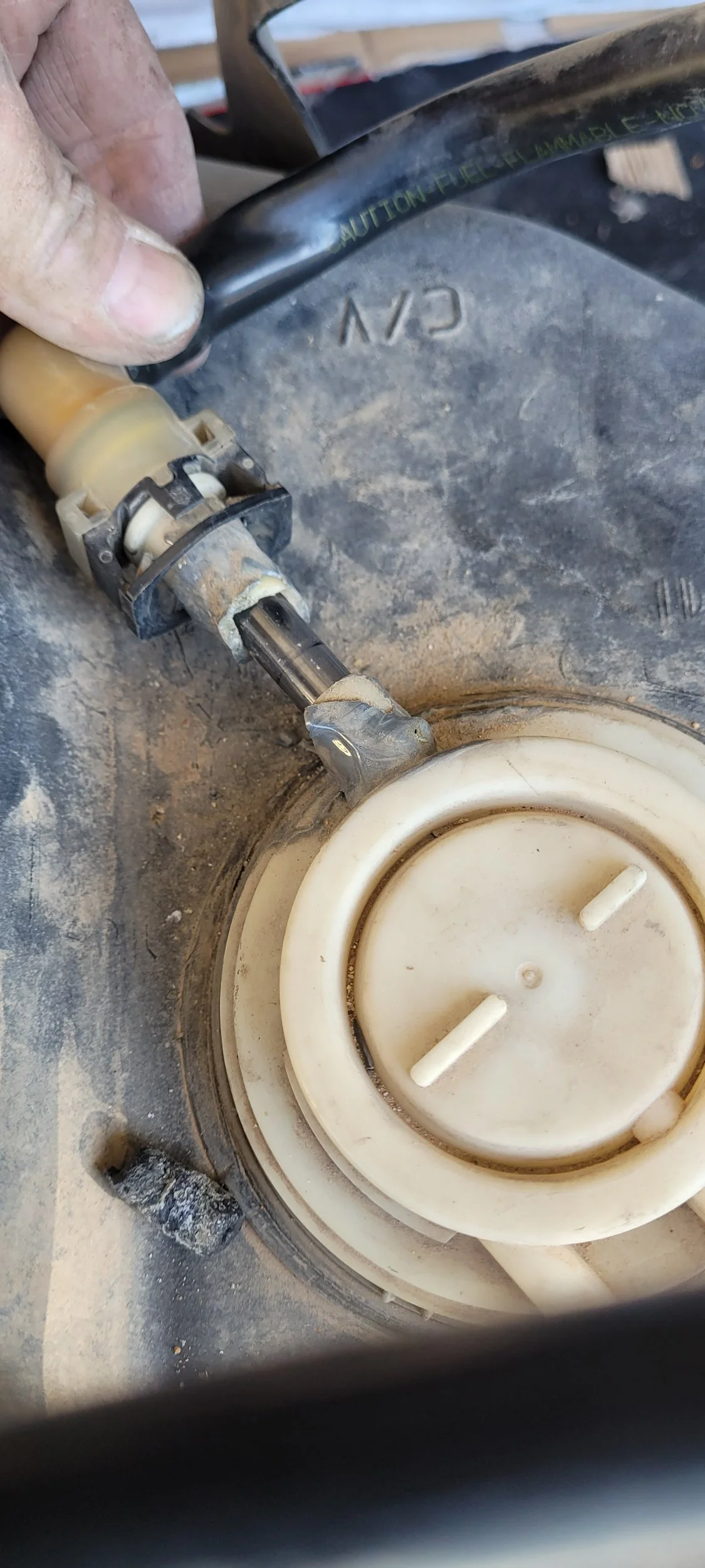

Fast forward to September 2024 and I started getting codes for minor/major vacuum leaks. I smoked the system and found the connector had failed again. I dropped the gas tank, and redid the repair. This time I used a metal insert (instead of the plastic pen barrel) and let it sit about 48 hours before I reinstalled. I smoked it again and no leaks. I cleared the code and figured everything was good.
I was doing some consulting work out of state so I was gone most of late September and October. When I went to fill the gas tank the pump kept shutting off. I think this was the first time getting gas after dropping the tank in September but not sure. Instead of continuing to fill the tank I brought it home and dropped the tank....AGAIN! I verified the check valve in the fill wasn't stuck but removed it and sanded it some more anyway. I removed the charcoal filter and made sure everything was good. I blew compressed air through it and didn't find any obstructions. I reinstalled the tank and tried to get gas and had the same issue with the pump stopping.

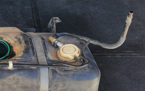

I suspect my "fix" for the check valve has this valve stuck in the up position which would prevent any air from being displaced while filling. Looking at the tank there is a vent line that comes from the engine compartment and connects to a T before the charcoal filter. I don't think this would affect anything with filling. There is a Rollover Valve (marked ROV) on the drivers side top of the tank. This line connects to the Check Valve (marked C/V) on the passenger side of the tank where I did the repair. If the Rollover Valve is stuck closed this could be an issue but also if the connection at the Check Valve is obstructed this would be a problem too. Finally there is a line that connects the vent tube on the fill neck to the Check Valve. From the Check Valve the large line (that was cracked) connects the tank to the Charcoal Filter.

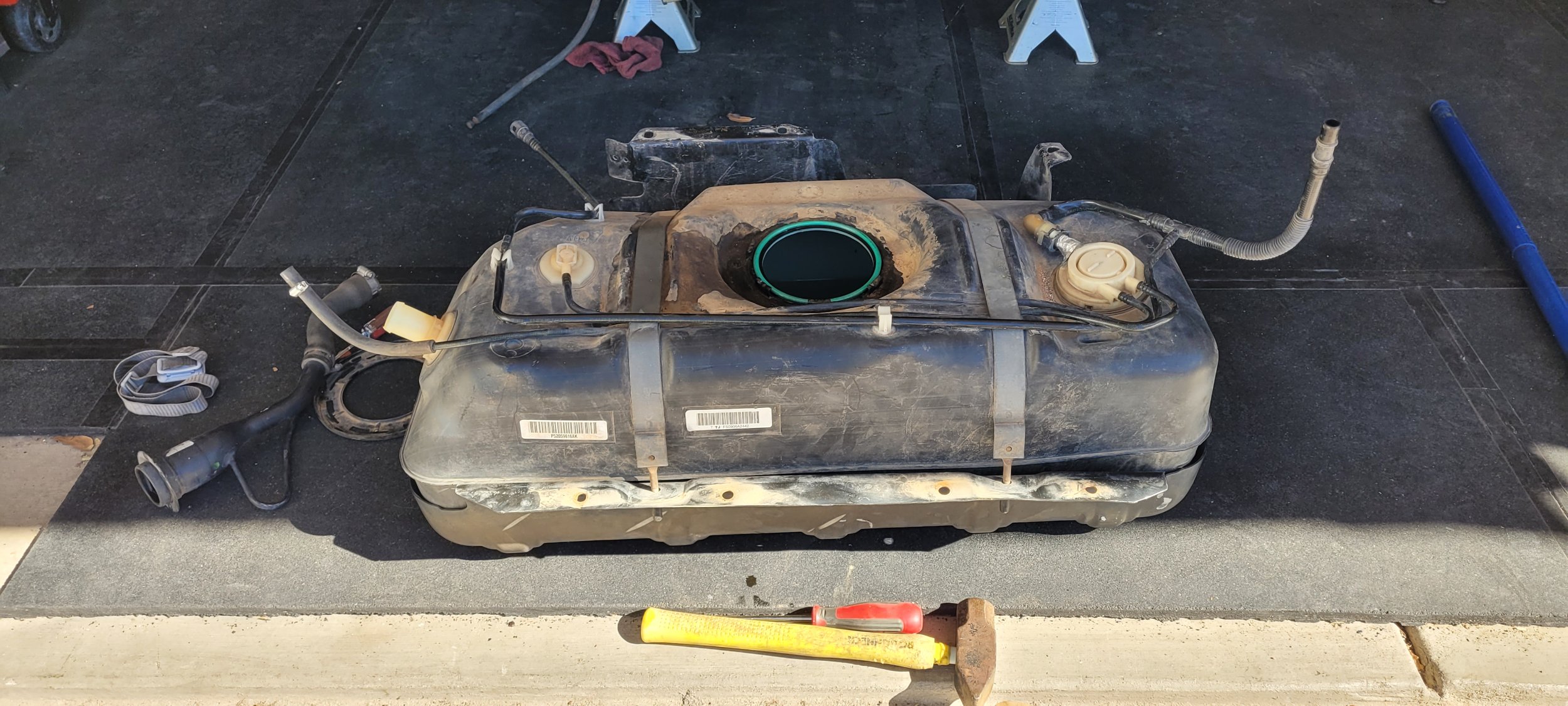

My plan in the next few days after I get the tank closer to empty is to drop the tank (I'm like a one man pit crew with this now) and inspect all the lines connected to the tank. I will try to blow compressed air through the lines and see where I do and don't have obstructions. I will also try to inspect both the Rollover Valve and the Check Valve inside the tank to see if I see anything obvious. The troubleshooting hopefully will point me in the right direction.

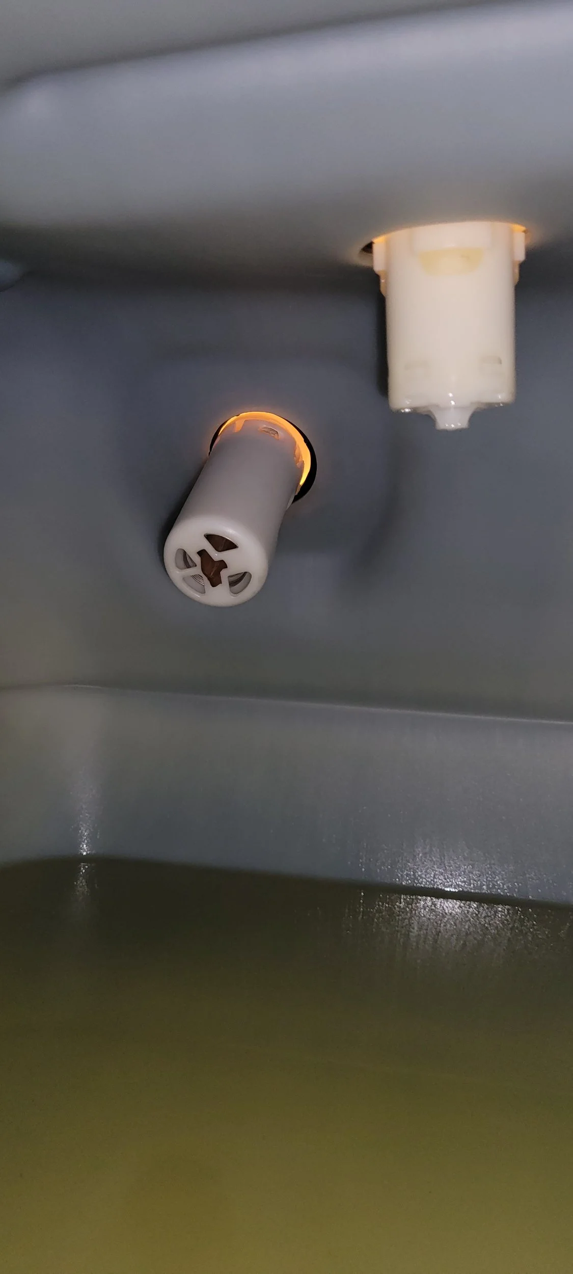

Does anyone know if the Rollover Valve and the Check Valve can be removed for inspection? I don't think they can as it looks like the Rollover Valve would need to be pushed up and out of the tank based on the tabs I see in the photo. I know these aren't serviceable which makes me think I can't remove them. Does anyone have any other ideas on what I can try other than buying a used tank off Ebay? Any and all thoughts are appreciated!

I do not think either of those halves are replaceable. I also think the tube you think is obstructed is a one way valve (c/v).

Update: I was able to resolve the issue. The Check Valve on the passenger side of the tank (not the fuel fill neck check valve or plunger as some describe it) was fine but the connection from the check valve to the charcoal cannister was obstructed. In the photo there are two smaller lines coming into the Check Valve on the right side. One line comes from the fill neck and the other comes from the Rollover Valve. On the opposite side of these connections is the larger line that goes to the charcoal cannister. This is where I had done a repair using J-B Weld for plastic on the connector. I got some material in the barrel that I used to join the pieces (like a large roll pin) and this was restricting the venting of the tank. I can't believe I did that....pretty embarrassing really. Cleared everything out and rejoined the connection with J-B Weld again and let it sit overnight. This morning I reinstalled everything and filled the tank without any issue. I even got 16.5 gallons in without any of the old splash back issue.
I hope this helps someone else down the line. While the fuel fill check check valve or plunger was the original issue a year ago and is typically the most likely root cause of the gas pump shutting off, there are other things that can create the same issue.
