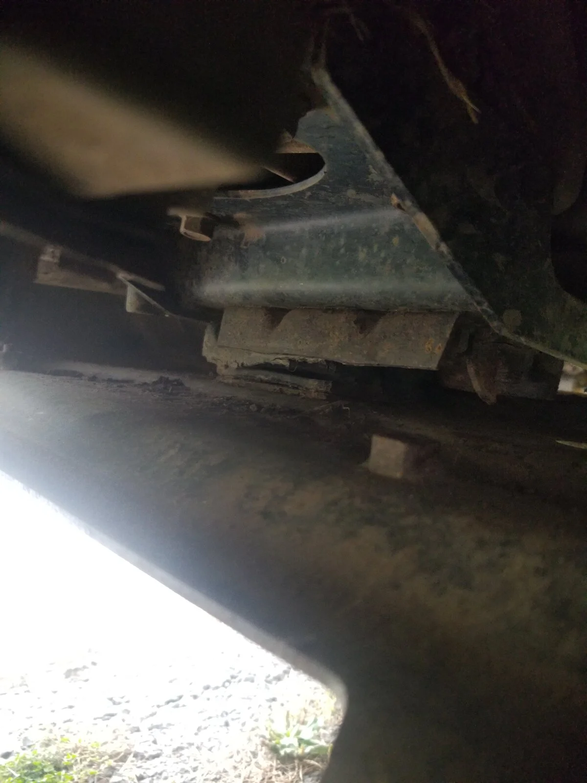

It would move tranny and TC to the passenger side where it needs to be. Also would move exhaust back over
Thnx guys for all your help. How do I replace the mount? I dont have to drop the skid plate hopefully?
Support the drivetrain, drop the skid, remove the nuts holding the trans mount to the bracket.

Put a support under your transmission, then drop the skid, the. The mount and replace it all.....straight, ha.

I'm having difficulty understanding how the transfer case can be off to the side when just the transmission mount is broken. There are three drivetrain mounts and they're in a triangular pattern. How could one of those 3 points (the transmission/tcase) move over if the other two mounts (engine mounts) are still firmly bolted into place?

I look at it like a clevite bushing. Control arms can move quite a bit when only one side is attached. Motor mounts aren't solid. There is a little bit of give in order to reduce NVH. The tranny mount is on the long side of the triangle where a little movement up front can translate into more movement back there where it was broken. The rubber in the MM could be just enough to result in what the OP had. Especially if they are worn and not necessarily broken.

That possibility is not one I would be willing to just assume is the case. I'd still be checking the engine mounts, that's a lot of movement at the tcase for a rubber motor mount bushing.
Ok cool thnx for that info. Yes makes sense if motor is flexing the TM will rip as is it did

If it was my Jeep, I would replace the transmission mount. If that results in the driveshaft successfully lining up, I would replace the engine mounts as they've seen some undue stress over the miles driven since the transmission mount went out.
