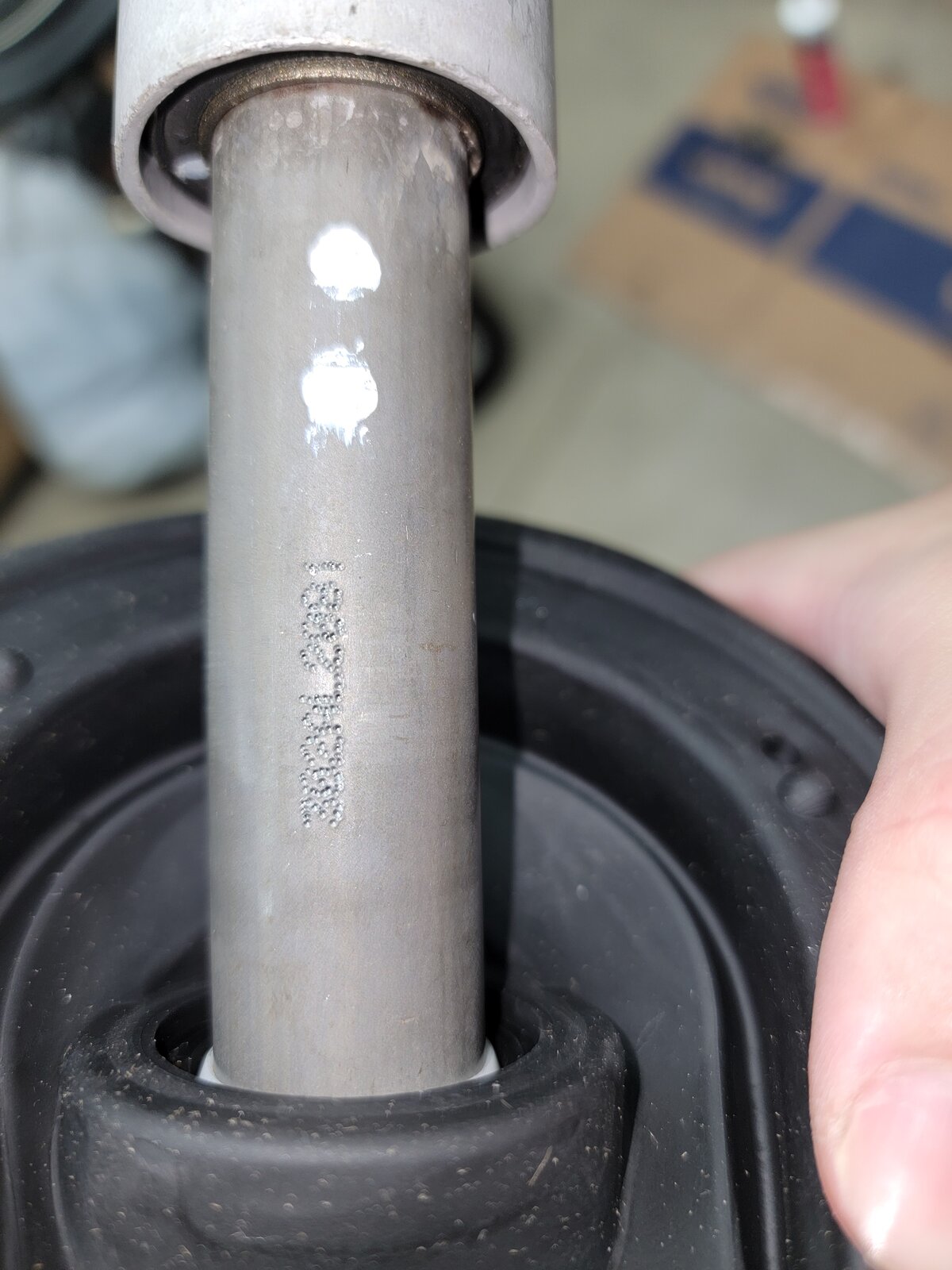

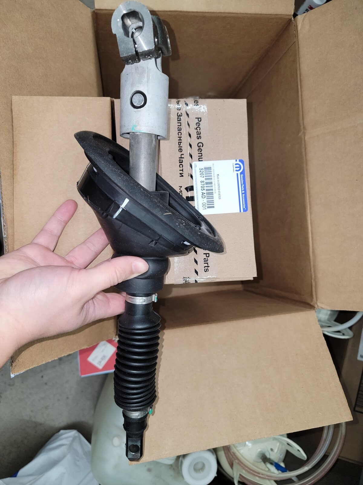

Original tape seal on the box.
Different part number stamped on the shaft. So, maybe a mixup between labels and parts?
Guessing the box packer or labeler messed up.
It's not off any TJ I've ever seen.
I purchased from RockAuto and the manufacture date is last month if that helps anyone figure out what's going on.
I'll try again at another store.
I think Mopar is using the same part number for 2 different parts.
52078705AD
Has anyone purchased a NEW steering shaft lately? I just received another exactly like I received before but this time from an eBay seller.
Time to try again.
