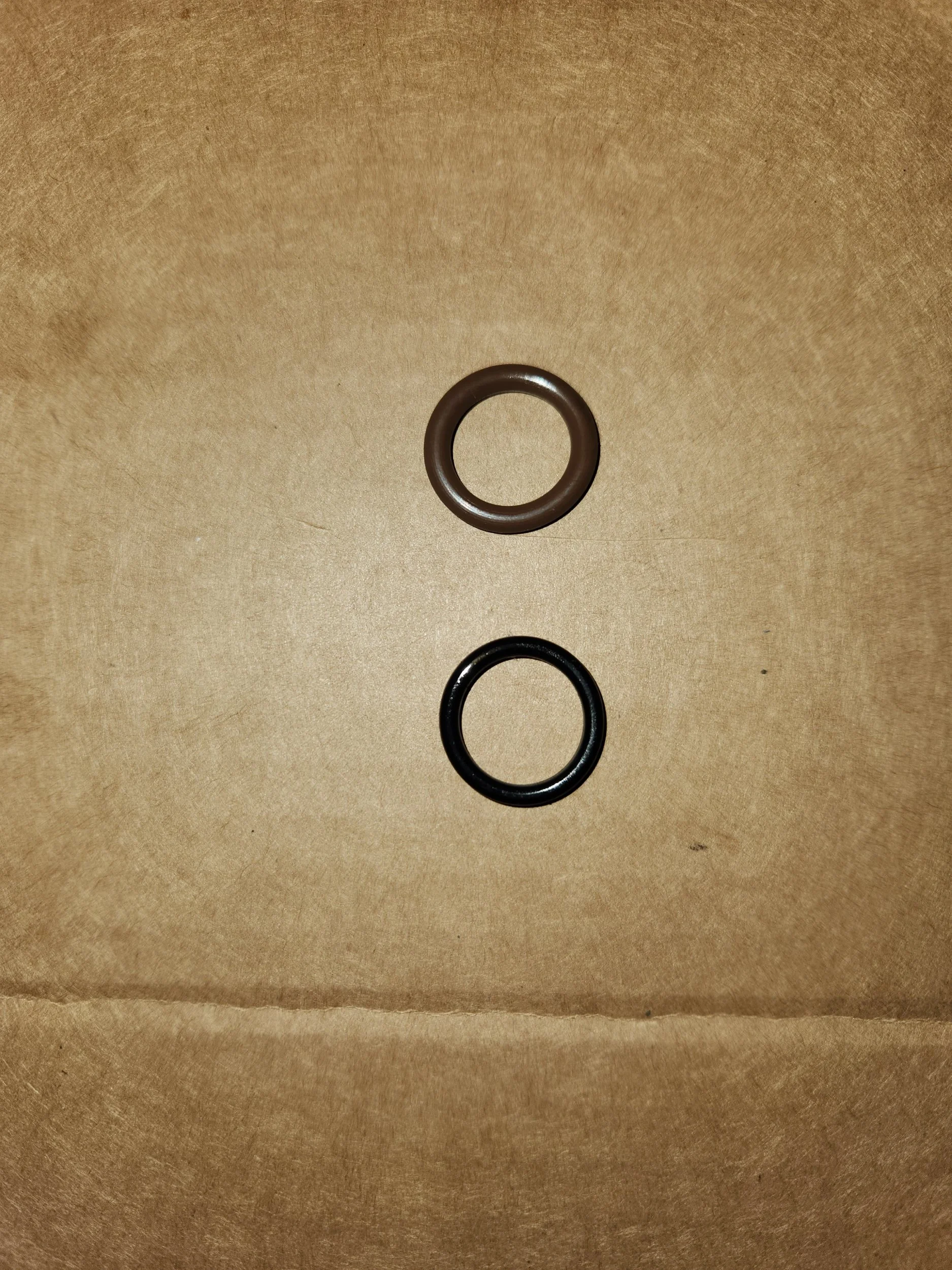

Power steering pump is leaking at the reservoir again. Going to just pull it apart and replace the o-ring.
Does anyone know the dimensions of the o-ring that seals between the pump and res?
Man you guys are useless, I had to figure it out all on my own. You really need to stop referring to yourselves as internet autists.
The proper size o-ring is 20mm OD, 14mm ID, 3mm thick.
https://www.amazon.com/dp/B08HJMQZHS?tag=wranglerorg-20
The one PSC used looks about 2mm thick. Here's a picture of the difference.
